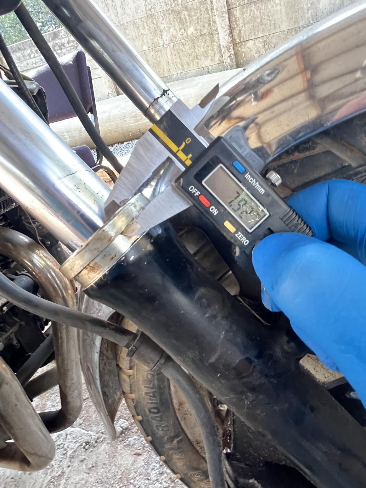

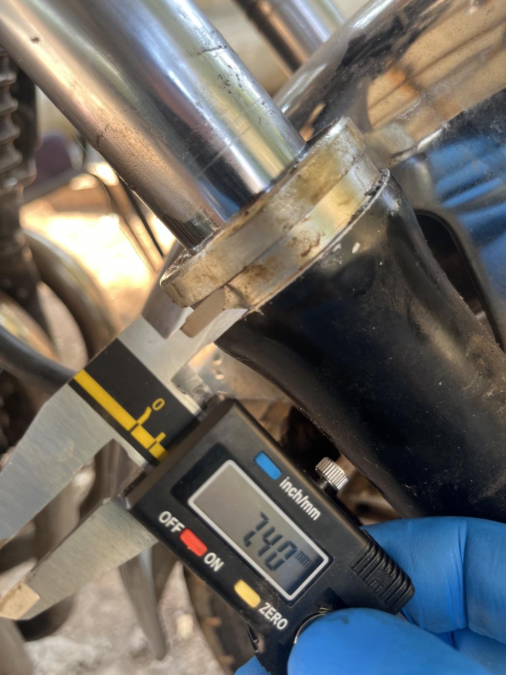

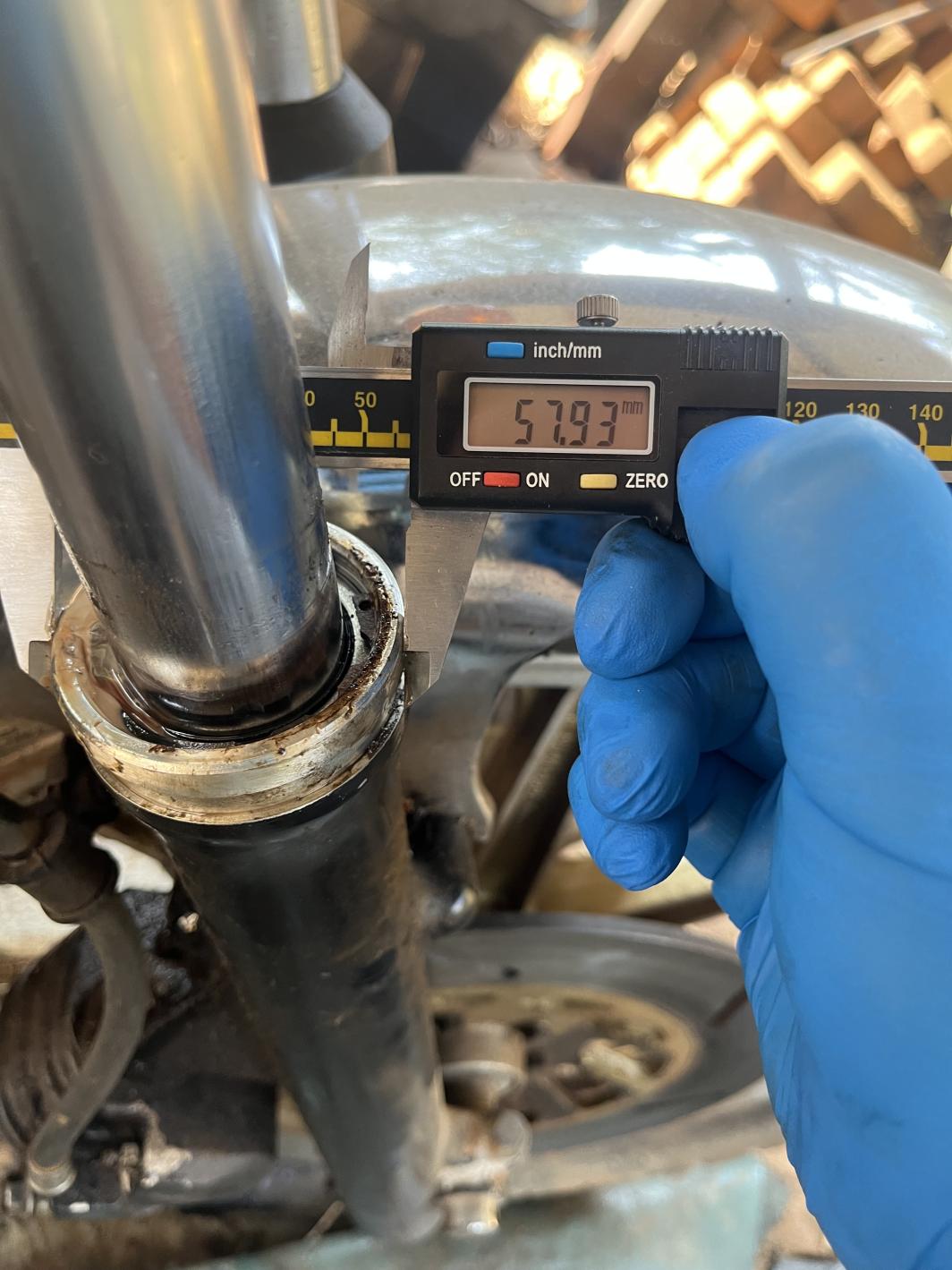

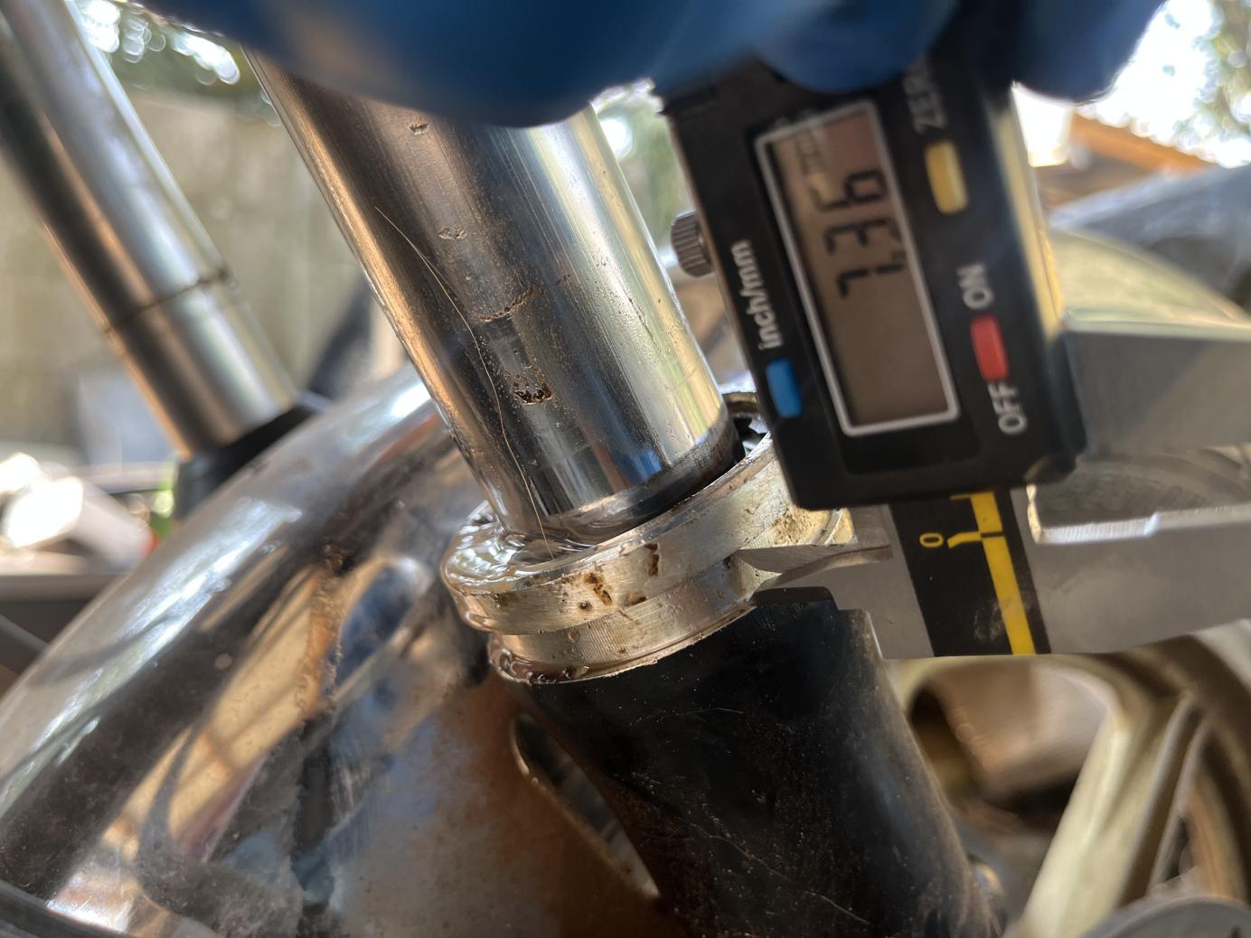

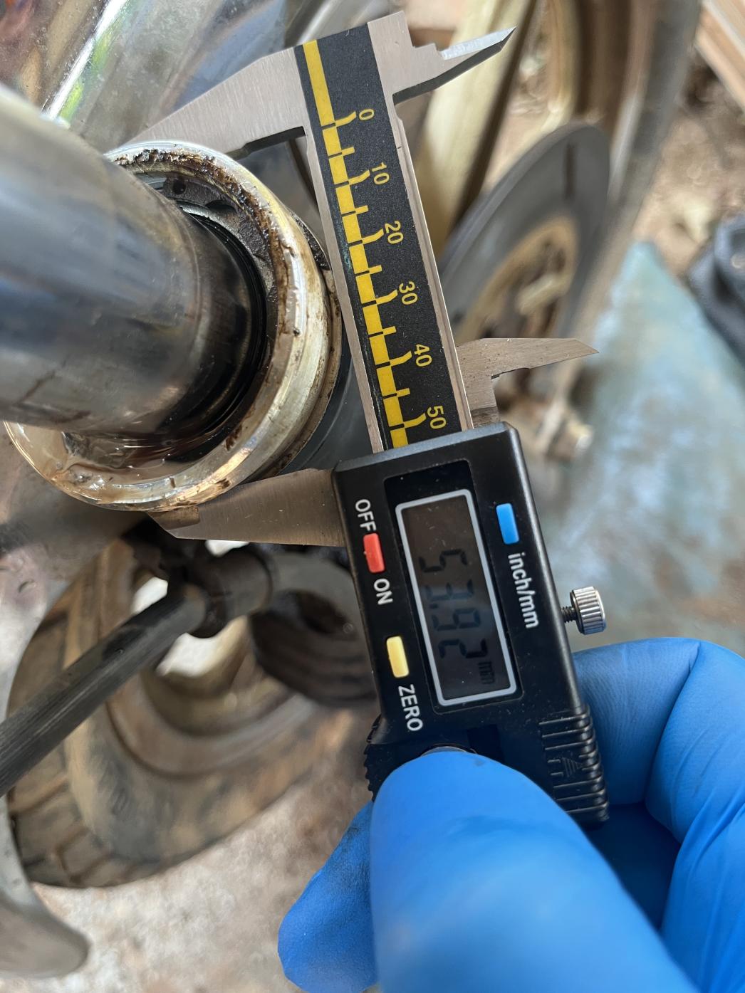

ID:	885848 Ok here goes, Rasputin
        I have a leaking front fork so needed to remove the dust seal to inspect. The bike is an ‘81 Special. ?European model
        1. Stanchion (Diameter 1) 37mm
        2. Fork leg (Diameter 2) 57.93mm Click image for larger version
ID:	885849 Click image for larger version
        3. Outer stanchion to outer stanchion 220mm so centre to centre approx. 184mm
        4. Depth/length of rim (top of fork leg) 7.92mm
        5. Undercut diameter 53.92mm
        6. Undercut length 7.4mm
        7 Top of fork to mudguard 440mm approx (in position on bike)
        I’ve attached pics so you can see where I got the numbers. Sorry, they aren’t attached quite in sequence. If you need any more measurements or pics I’ll take them for you.
        Should be correct unless my caliper is inaccurate, maybe someone can give a second set of readings to correlate before you send them off to the manufacturer.

          Looks good. I like your idea to have back up numbers before submission. Far better to send them the correct dimensions rather than have a bunch made that do not fit correctly I think the closer to the lower triple tree the better for measuring center to center on the fork tubes as the bottom can be moved a bit. If it goes anything like when I fitted the brake lines for XJ4Ever one will be made and test fit first. Whoever test fits it will probably be able to keep it for free, but that is not a for sure thing. I do not have a Special model right now so I would send it to someone who contributes as you have for the test fit. Thanks for doing that

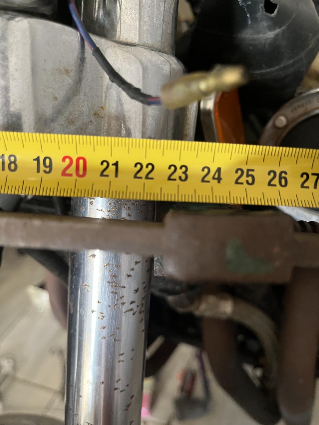

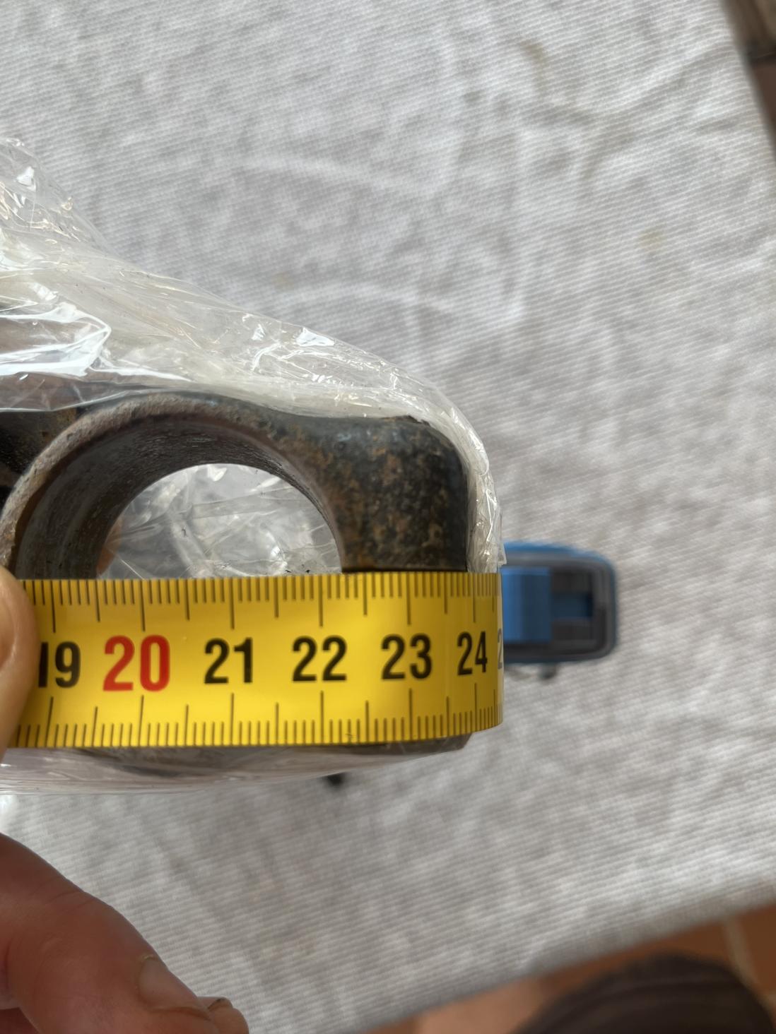

            I went back and measured right below the triple clamp and another from a spare one. You’re correct, that first measurement was taken by the mudguard and is slightly less lower down where the forks have been clamped at the wheel axle Click image for larger version
