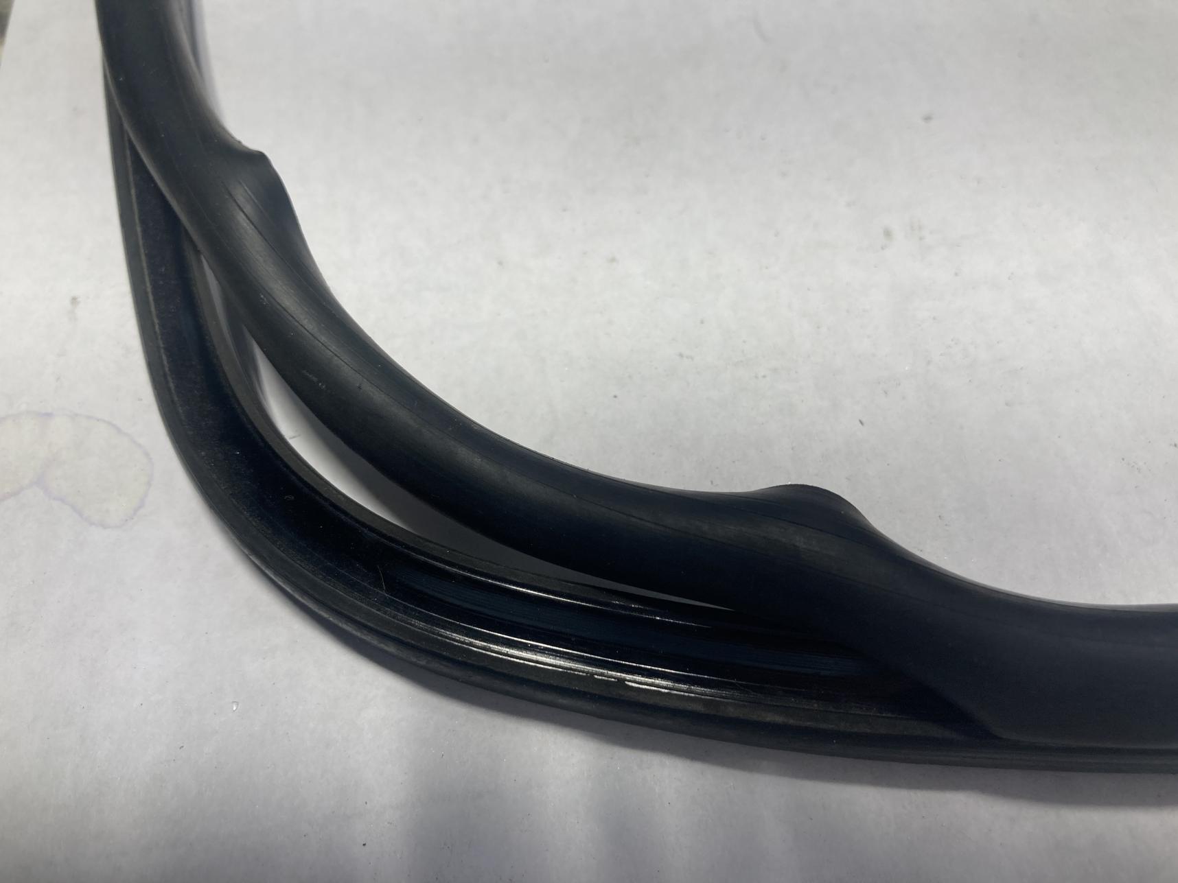

    The seals on my Venturer hard bags were NG when I bought it, but I have strugggled to find some way to do a good job to fix them. The rubber in the corners pulled away from the mounting flange.

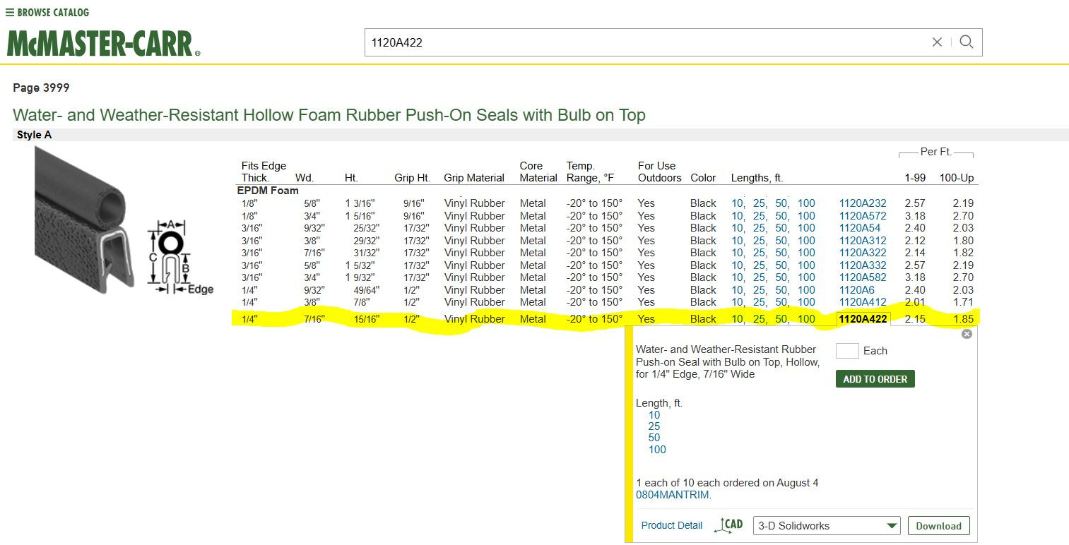

    I found a great solution at McMaster-Carr so I thought I would share it:
    McMaster-Carr is the complete source for your plant with over 595,000 products. 98% of products ordered ship from stock and deliver same or next day.
    Click image for larger version  Name:	Bag Seal Part Number.jpg Views:	0 Size:	221.6 KB ID:	885566

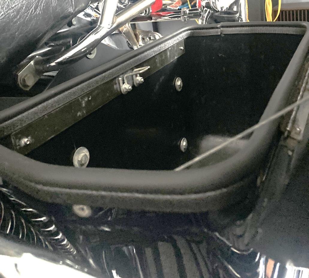

    Click image for larger version  Name:	Bag Seal 1.jpg Views:	0 Size:	142.0 KB ID:	885567

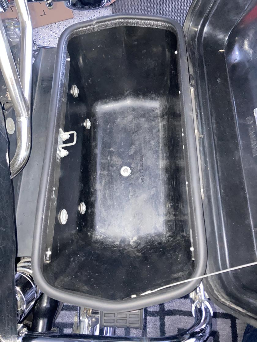

    Click image for larger version  Name:	Bag Seal 2.jpg Views:	0 Size:	145.4 KB ID:	885568

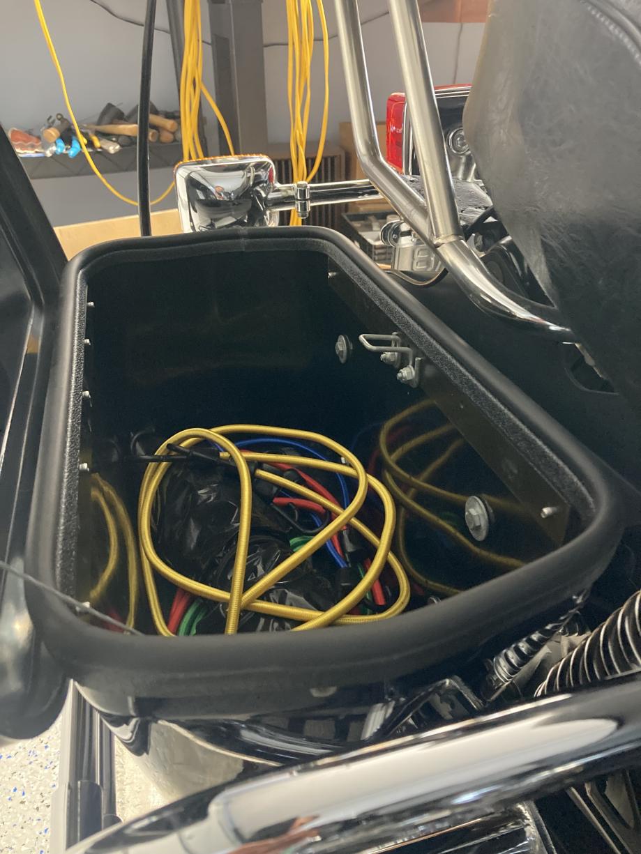

    Click image for larger version  Name:	Bag Seal 3.jpg Views:	0 Size:	138.2 KB ID:	885569
    I am really pleased it looks as nice as the OEM parts and it seals as well or better than the OEM. We'll see how it lasts.
    I bought a 10' strip and it did both bags with 20" left over.
    I used black RTV to join the seams.
