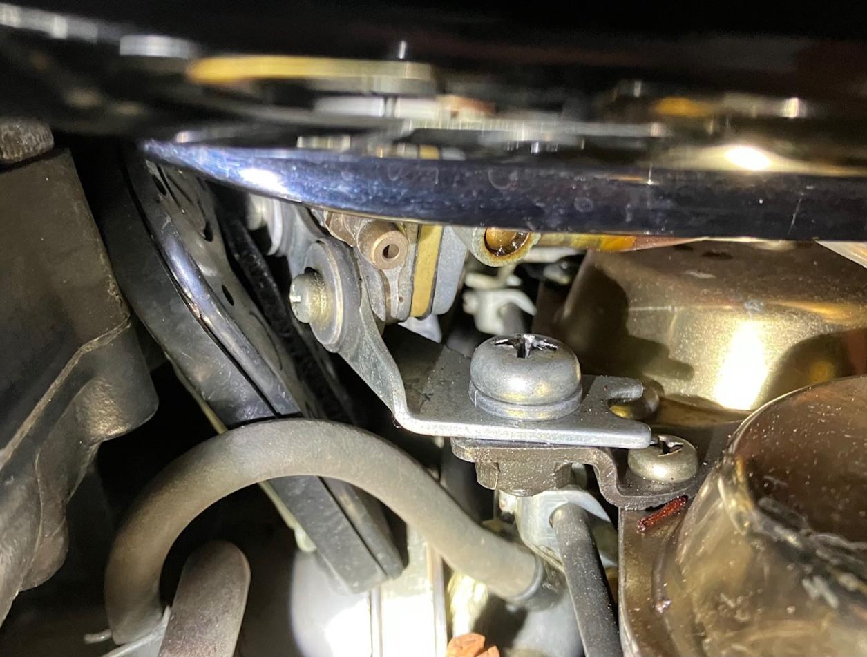

          Thanks for the replies. Upon further investigation, this is not a carb issue, which is either good news or it isn't. Fuel is leaking it appears out of the bottom of the vacuum block, or at least that's where I see it dripping from where the yellow plate separates the two aluminum sides. Anyone have any experience with this, before I pull the tank and tear that mysterious thing apart?
          Also, I tried looking for info on the octupus system in the OEM service manual, and I couldn't find anything.
          Click image for larger version  Name:	yamaha gas leak.jpg Views:	0 Size:	140.6 KB ID:	885626

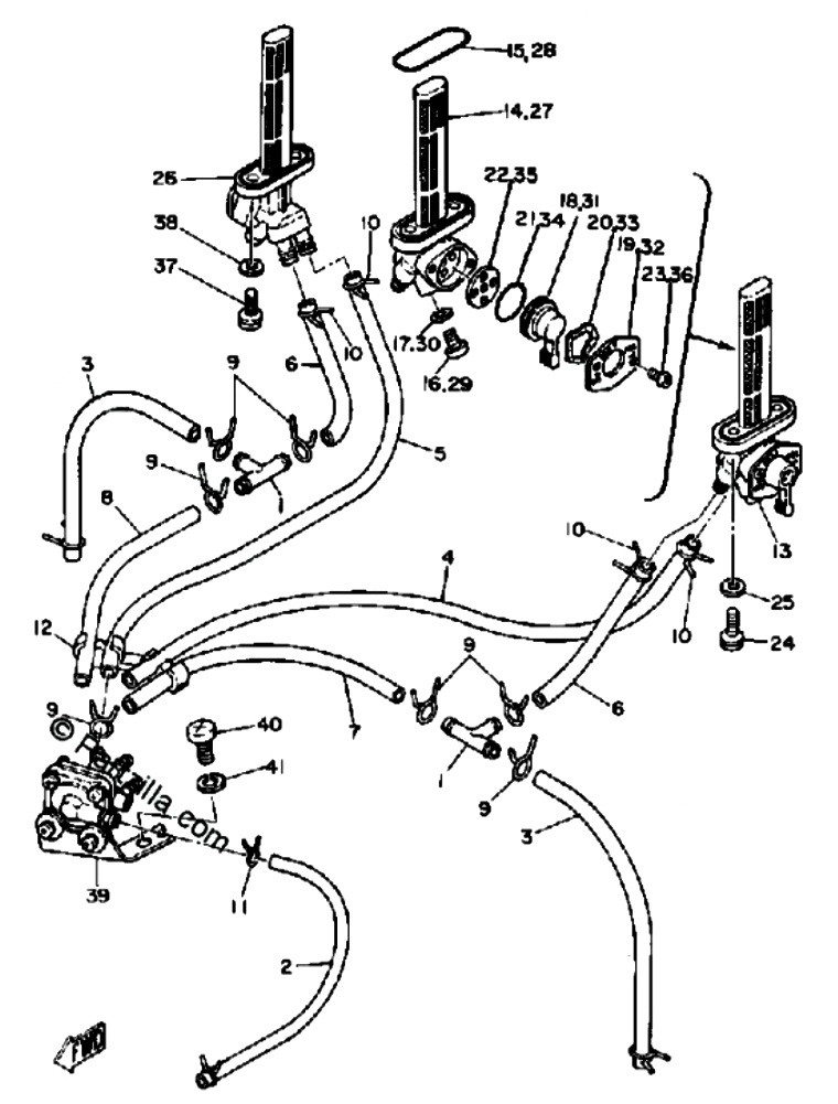

                      Click image for larger version  Name:	octy.jpg Views:	0 Size:	142.9 KB ID:	885643
                      Last edited by DEEBS11; 08-14-2025, 09:20 AM. Reason: Correct replacement shown below.

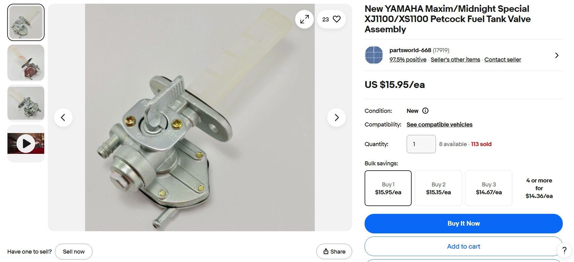

                        • 2010
                        This is correct for your bike.
