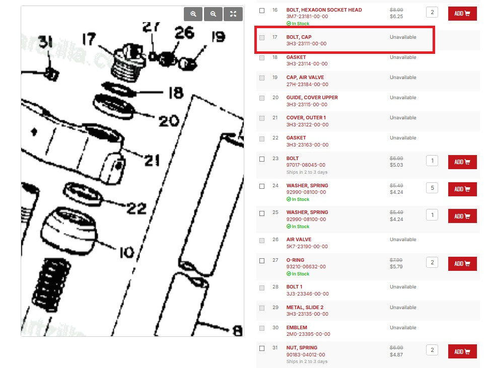

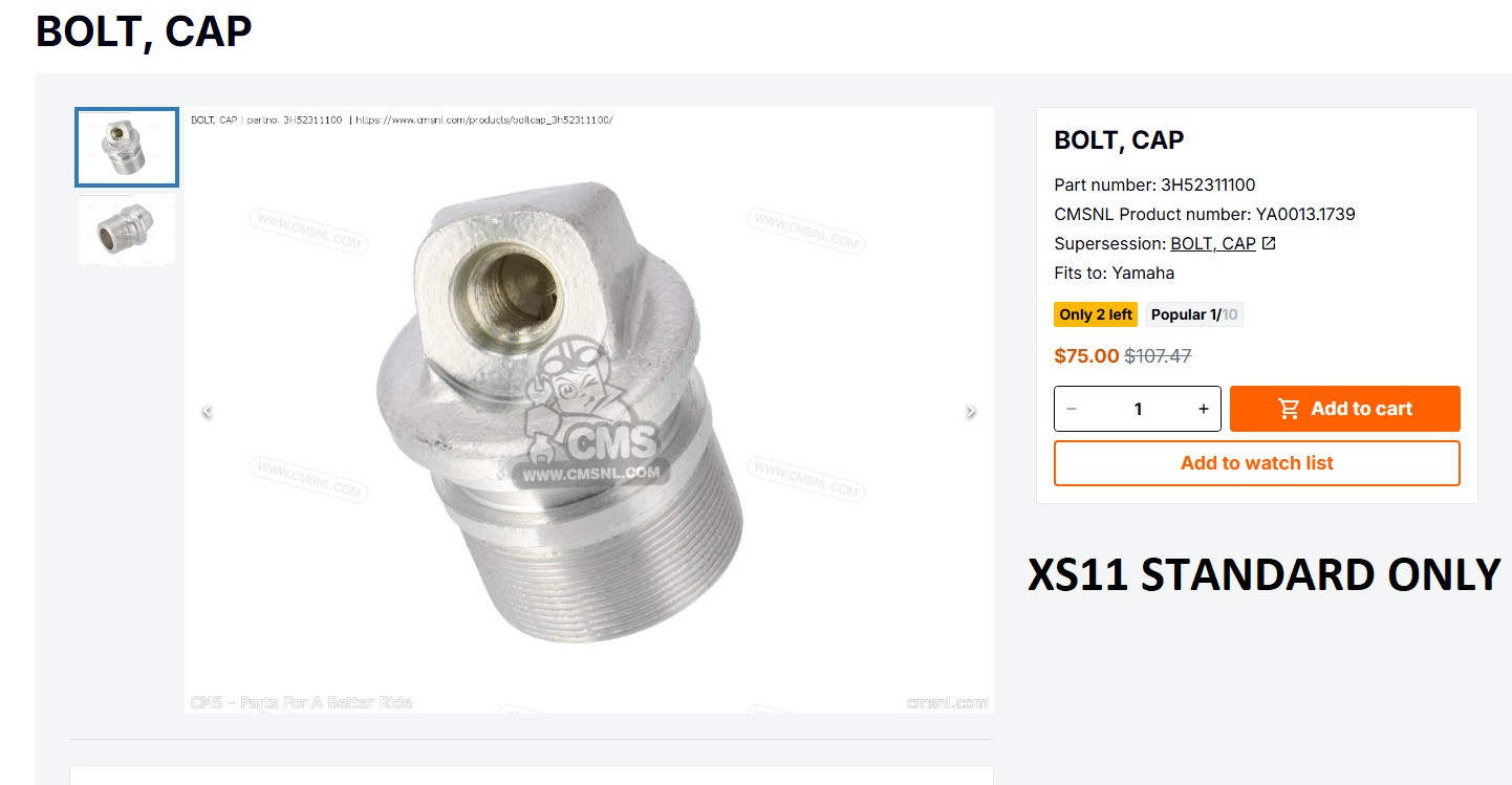

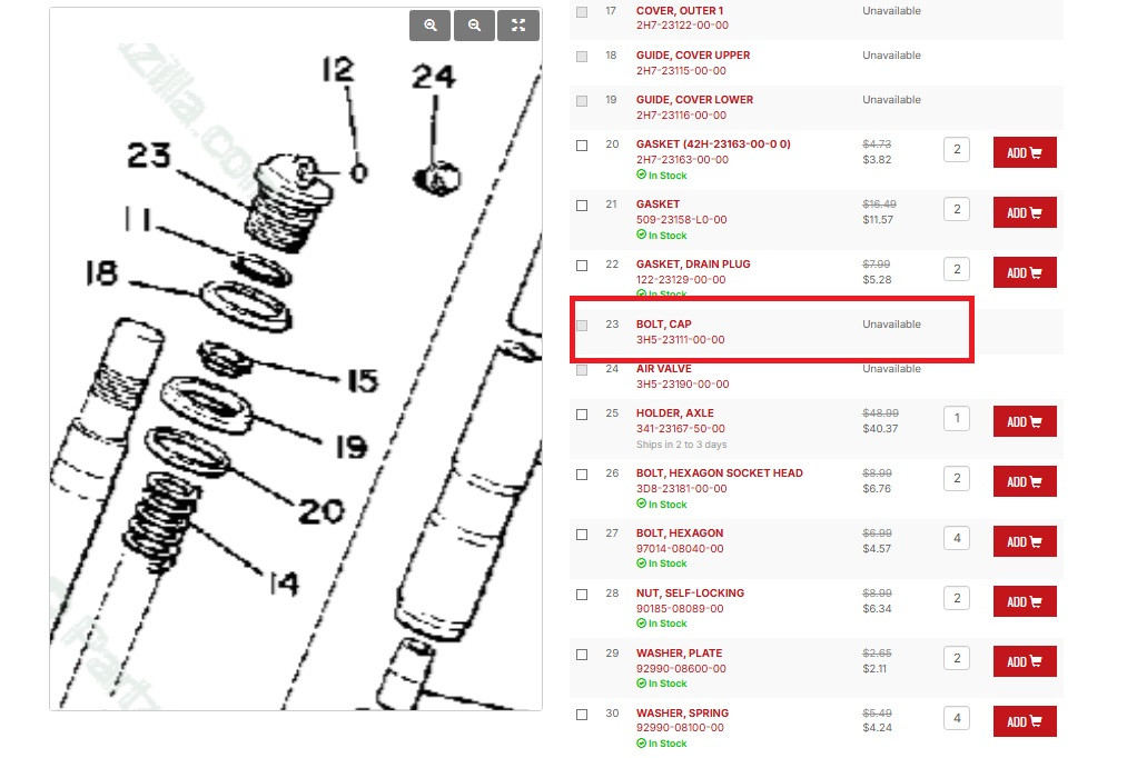

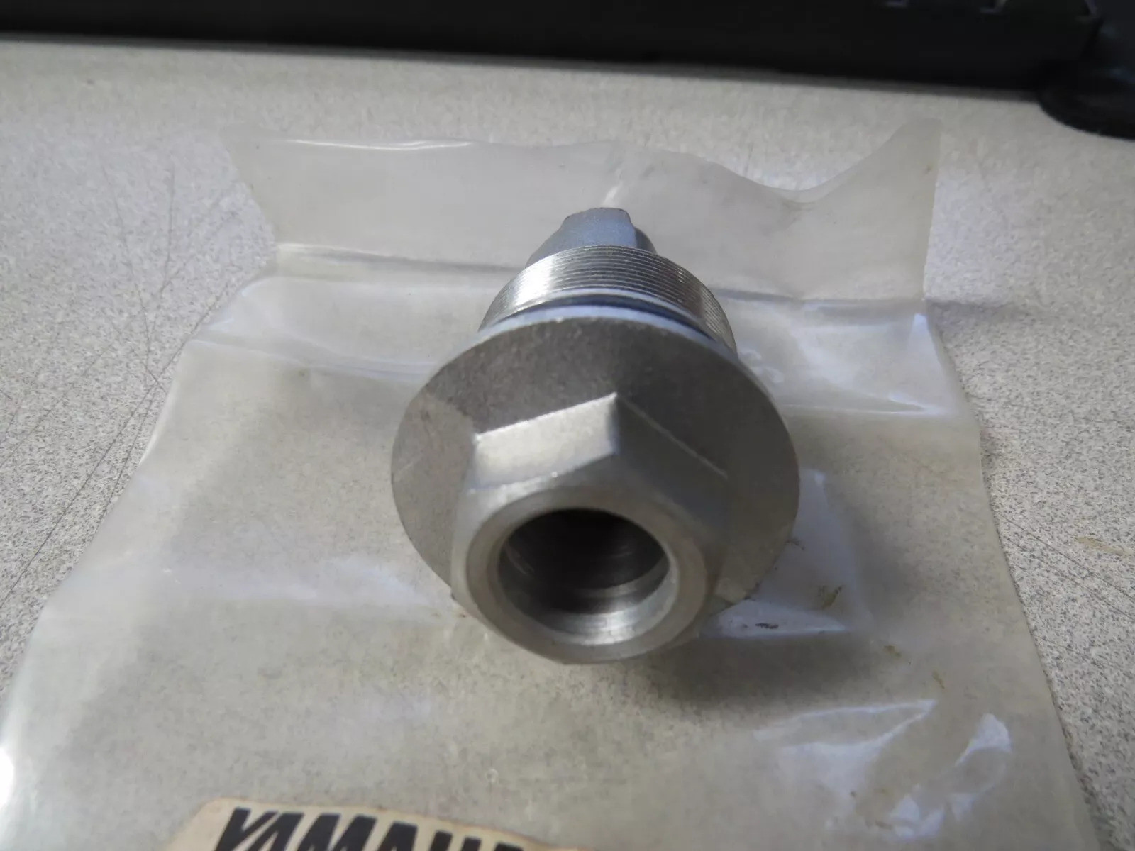

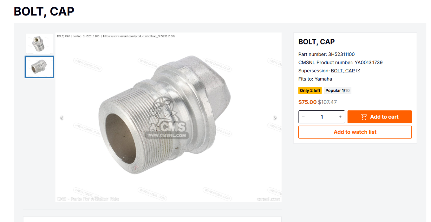

            Marty, yes, the tops are different. The Standard gets the KYB. However, there are other differences when they went to air forks. The first picture is a Special fork top with Schrader valve hole. The second & third is from my 1980 Standard. None of these fork tops interchange so the fork tube is also different.
            Click image for larger version  Name:	80 XS11 SPECIAL fork bolt top.jpg Views:	0 Size:	172.1 KB ID:	885298 Click image for larger version  Name:	80 XS11 STANDARD FORK TOP.jpg Views:	0 Size:	140.5 KB ID:	885299 Click image for larger version  Name:	Opera Snapshot_2025-05-15_091824_www.cmsnl.com.png Views:	0 Size:	293.4 KB ID:	885300

                The Special has the same part number. But you can see it is the shorter part. Something ain't right. Perhaps again, KYB VS. Showa?
Name:	1980 Special fork top.jpg
                  See, the larger fork top number is 3H52311100. That's what is on my 1980 G front end.
