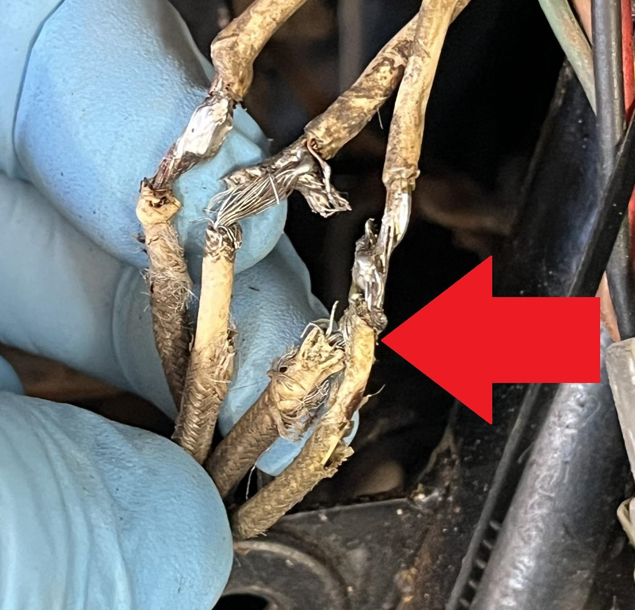

    I have a 1981 SH 96000 km bought a year ago ‘ 100% original’ according to the owner. You guys can already see where this is going…..!, transported to me, I started it to confirm it was running, which it was! I then decided to go through the bike and check it before riding
    To date I have replaced engine, gear oils, removed and cleaned carburettors (only made possible with this forum) and am awaiting a shim set before I check the valve clearances and camchain tensioner. Worth noting that nothing has been easy because I’m still new to this, this bike has for sure had many hands on it over the years and I don’t want to f it up!

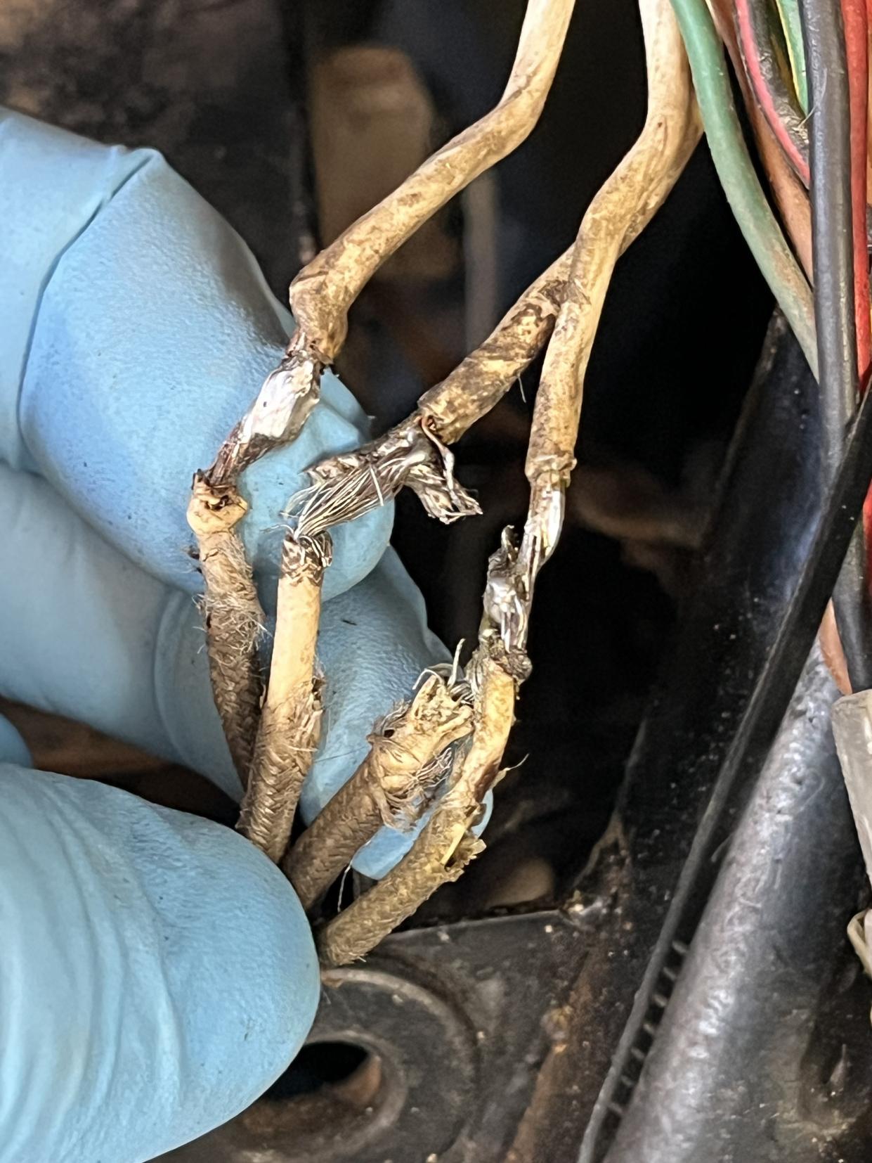

    Fast forward to today, I’m going through electrics. There’s duct tape EVERYWHERE. Once removed , I found this. No alternator connector, I think it melted, and the 4 wires from the alternator have been soldered to the 3 leading to the reg/rectifier.
    Firstly, on my wiring diagram I can only see three white wires leaving the alternator. What am I missing?Secondly two of the four white wires from the alternator are soldered together, should I trace them back to the alternator, thirdly should I replace the wires and the original connector behind the fuse box?Reading on the forums there was discussion on whether to join the alternator wires, preventing a potential site for overheating behind the fuse box.

    This connector kit is a good start. Might need two to get all the wires. The two shorted wires soldered together are suspect.

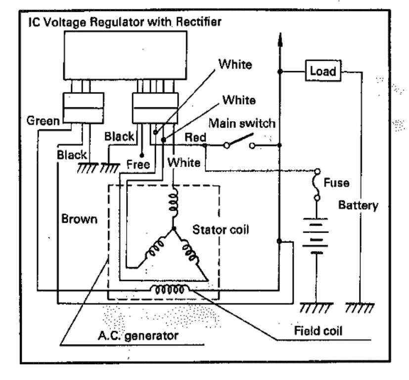

      As you can see, those wire should not be shorted together.

        Here. This aint right.

          Thanks Deebs11. And thank you for the link you posted first. It makes me wonder given that the bike started, was it actually charging? I didn’t run it for longer than 30sec.
          I’ll go ahead and cut and separate those wires then. I have the service manual but it’s not very detailed - now is probably a good time to remove the alternator cover to check where that fourth white comes from as well and I’ll check the field and stator coil resistances.

                But it is a dandy soldering job!

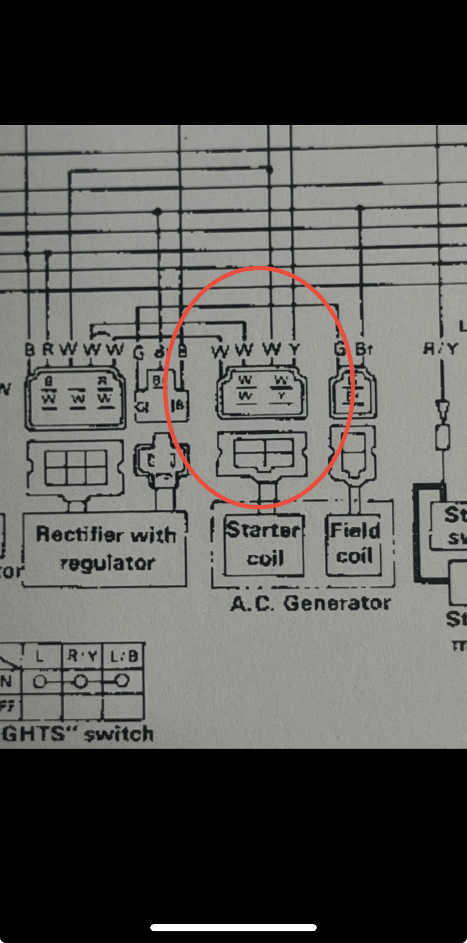

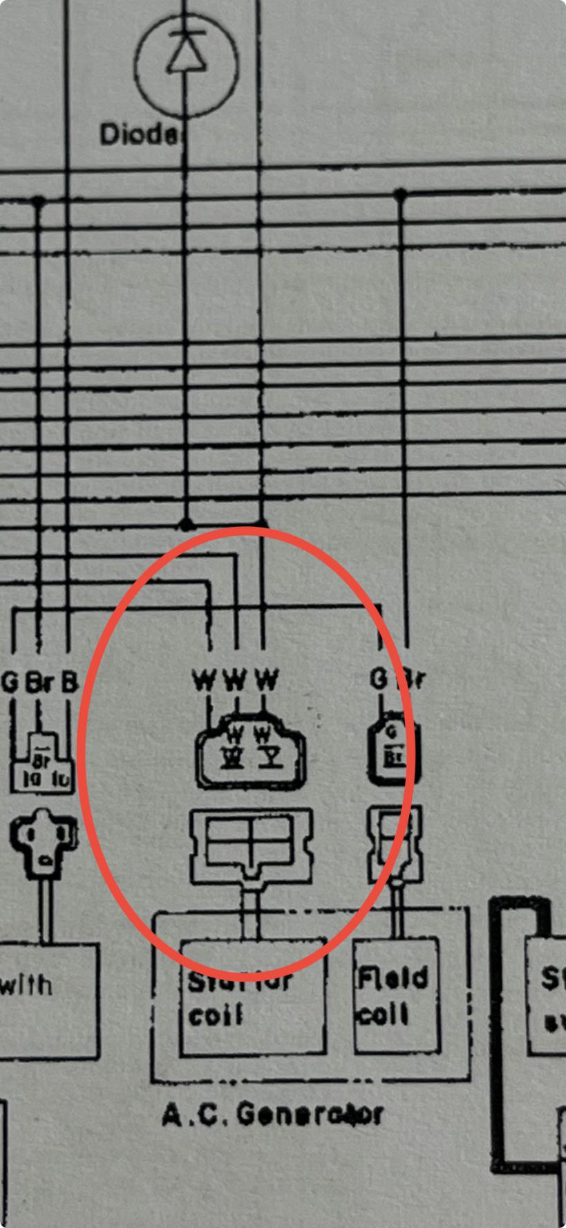

                      I found this helpful thread on the forum, it helped me understand why there are 4 wires leaving the alternator and one of these wires (smaller, yellow sheath)is unused at the alternator connector behind the fuse box on my model. But more than that it deals with alternator charging issues very well too.
                      XS11 1978/1979
                      And below, XS11 1980+

                      In case there are any novices like me scratching their heads
