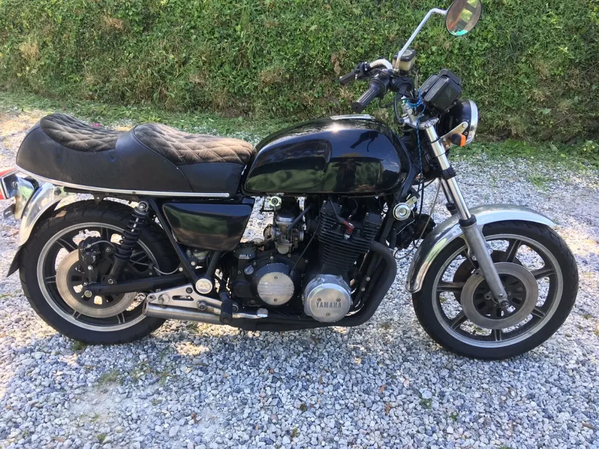

    Hi, I've just picked up a 1978 XS1100 yesterday that needs a fair bit of work. While not really checking it out yet, one thing missing is the airbox.
    Has anyone done it or is it possible to use pod filters on the carbs rather than an airbox? And are the airboxes model specific or can they be interchanged?
    I used to have an XS250 and 400 as projects so they're not totally foriegn to me but this is a bigger project than I've done before so could be interesting! Any pointers or advice is much appreciated.

                          It's my belief that the best way to run this bike is with the stock airbox. It works fine, makes HP and helps scavenge the crankcase. The stock bike also looks better with an airbox on it.
                            Look at the photo he posted. No airbox on the bike. Sometimes we need to make do with what we have, and in this case pod filters make more sense.
