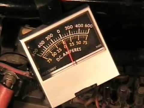

            Originally posted by LenB
            Also never opened up the 45 year starter yet - heavy draw when hot? Maybe worth a look?
            No Need to actually remove the cover and/or remove the starter. (^-^)
            Lookey here-
            (Read the video description fOaR details...)
            I used an "Inductive DC Ammeter" I have owned fOaR years+years. Just slip it over the starter wire cable. (☉_☉)
            NLA from where's I originally bought it but go HERE and you'll find wut I'd replace it wit' iffin I dropped it or stepped on it or something else all clumsy like...(_Oo)
            https://www.autotoolworld.com/S-G-To...CPf8QstGytsFfU
            Looks like THIS-
            Also can be used to measure show how LITTLE charging is done while idleing wit' the headlight on...actually DIS charging IRL. (O_O)
            GOTS to get the rpms up and KEEP'em there fOaR a while to keep the battery happy. (^_^)
