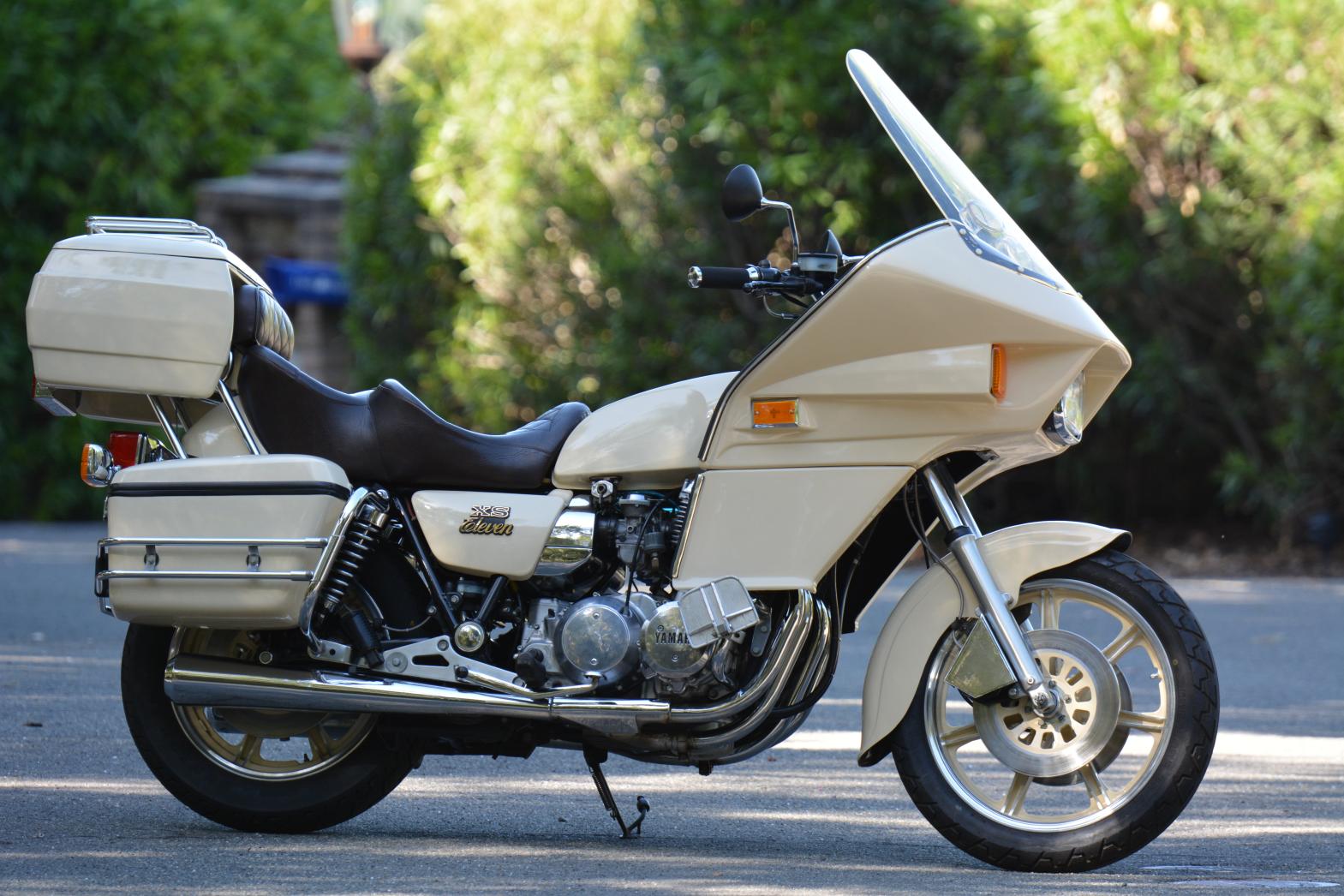

                All very good ideas above. The key thing is to have worked through the items that can cause grief and to have confidence that your XS11 is reliable. Like the guys above, I've ridden all over the western US on my XS11 with my wife and have never had any serious problems other than running a hot in the middle of a Nevada desert during the middle of a 115F day (fixed with an oil cooler and change in oil rating after that trip). The few parts I've carried were really my security blanket for ahh craps. Here is my touring version with all Yamaha bits, repainted at a later date. I bought the bike new just after they came out and it still runs strong.
                Have a great time on your ride.
