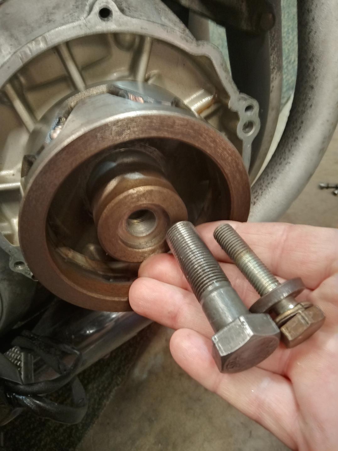

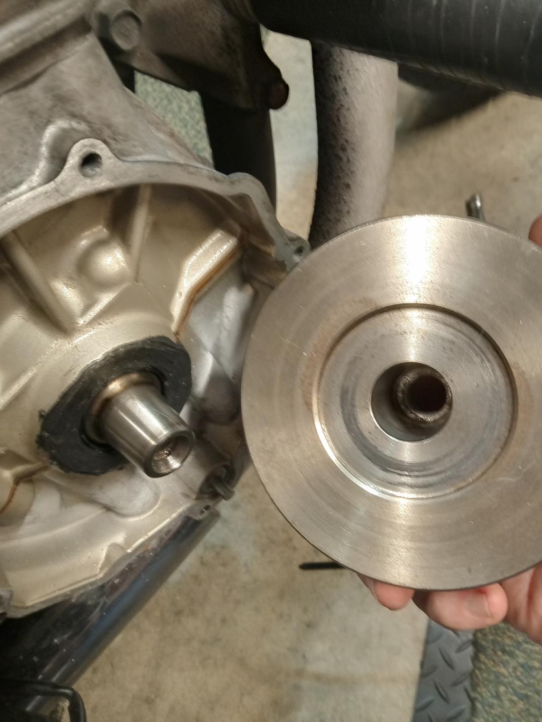

    i do have a question, I couldn’t get the alternator rotor off the crank and the broke crank wont come out of the case till it’s removed. What’s the secret? I have a puller but it wouldn’t budge.
    Thanks for the inputs..
      • 8861
      A 16mmX1.5 bolt threaded into the rotor and using an impact gun, the rotor will fall right off.

        Bikerphil
        i am a little slow this morning and I'm not following you here. I don't remember seeing a place to thread a bolt into the rotor other than the center bolt that holds the rotor in place. Can you help clear the cobwebs out of me?? LOL
          • 8861
          Look at again, there are threads in the rotor and the bolt pushes against the crank popping the rotor off.

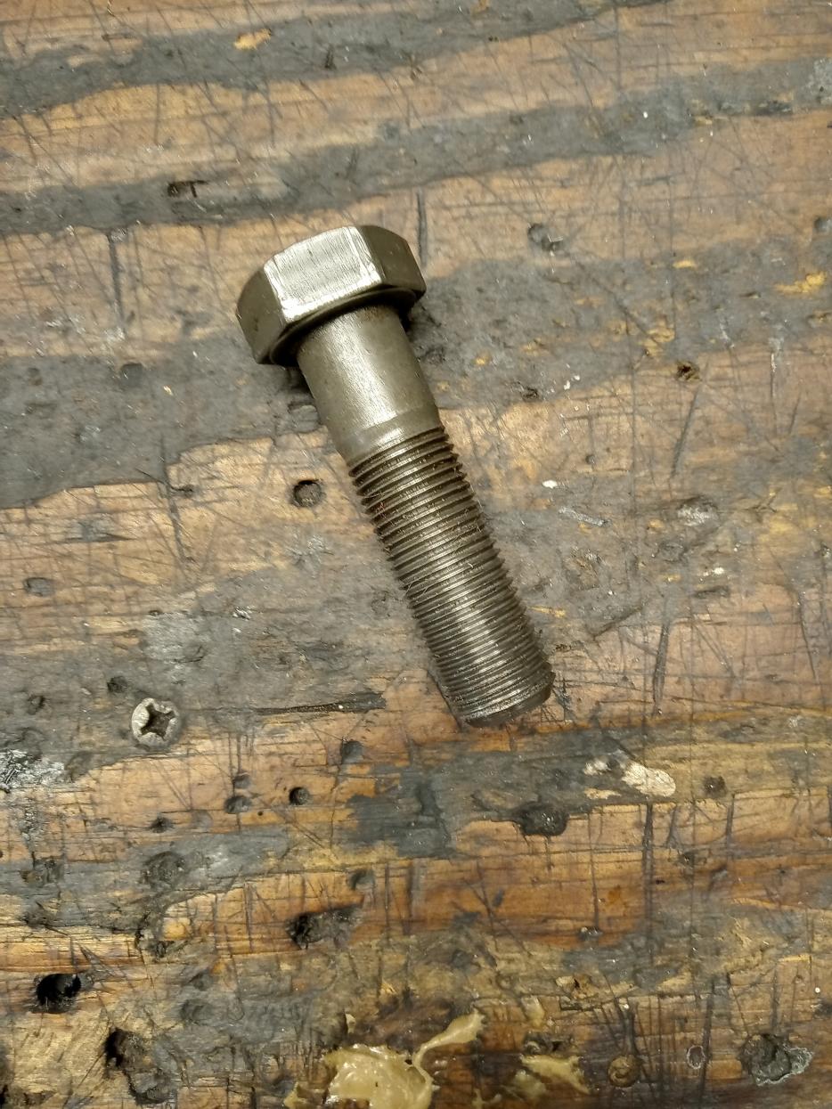

                This make sense. I was thinking the bolt that held the rotor used those thread. Now to find the bolt required. thanks guys.
                  • 7792
                  The bolt to remove it is 16mm X 1.5mm X 45mm. I'm buying a new one to use from Tacoma Screw, and they have a 50mm that has threads all the way up. 1.25" is all you should need for bolt length, 50mm is about 1.75". Yeah, not exact, but close enough for government work....

                    thanks all.. still looking locally for the correct bolt. i may have to order it if i cant find one.
                      • 7792
                      Google search for metric bolts near you. Tacoma Screw is a large company, and has offices in most metro areas. Granger may also carry a bolt that will work.

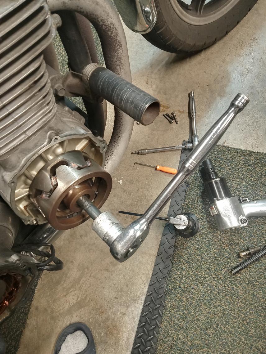

                        A few pics of the rotor pulling process...
