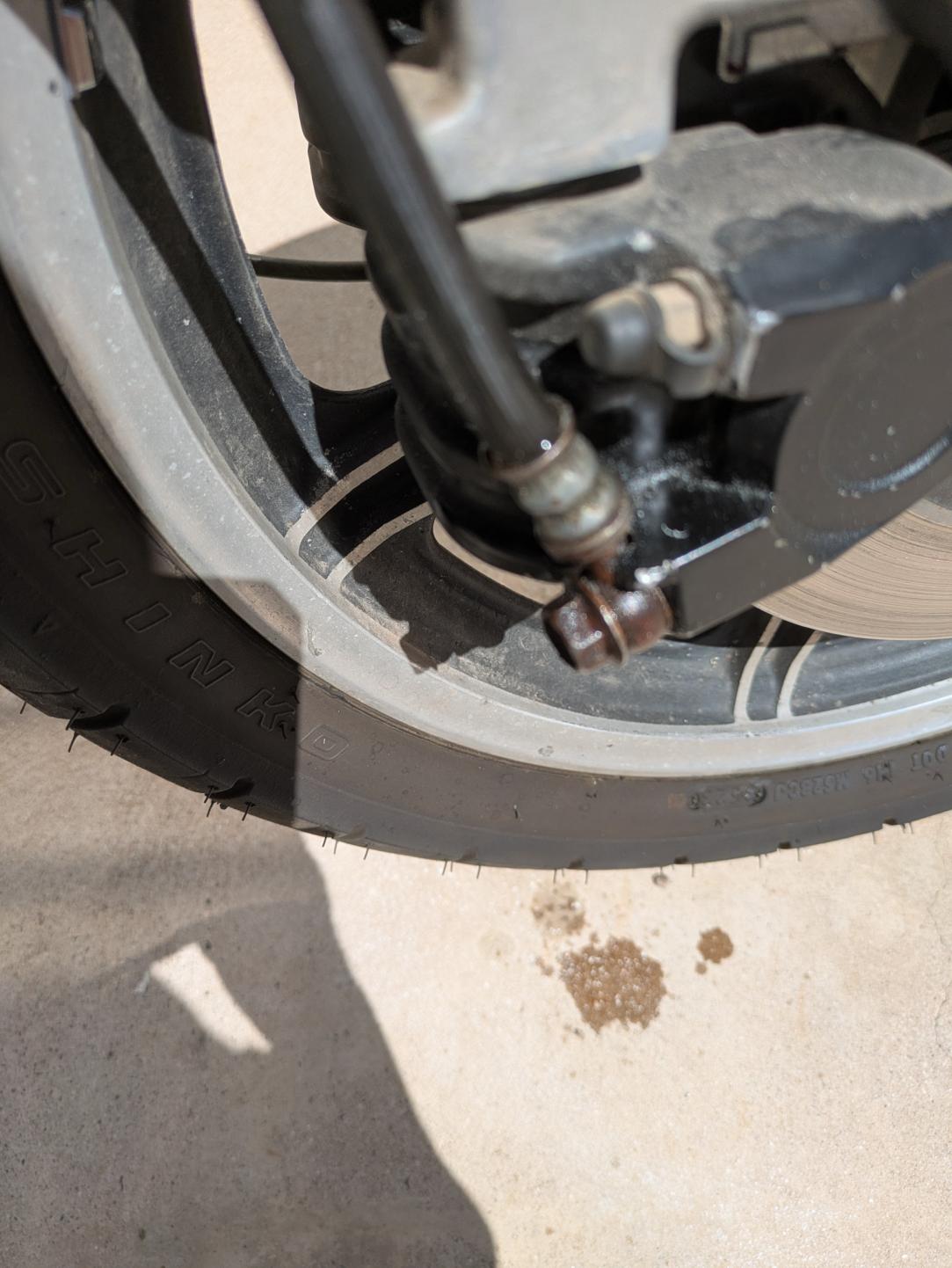

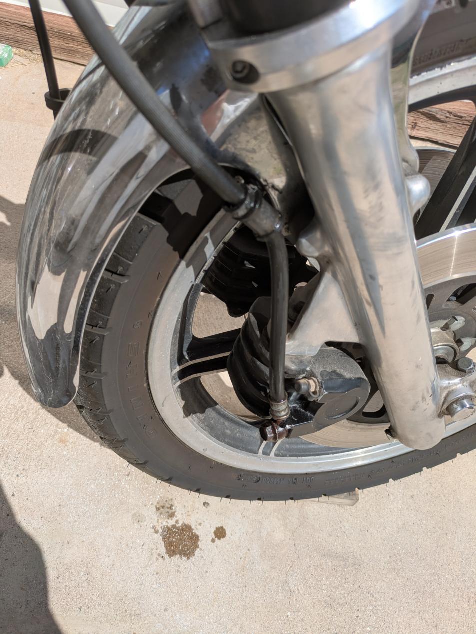

    Found this in my pre-ride check. Front Right side brakeline had mystery fluid from grommet down to the caliper banjo bolt AND a new "spot" on the concrete. ( •_•)
    Wiped the brakeline dry. Smelled like brake fluid. (O_o)
    Actuated the front brake lever a few times but it didn't feel abnormal (not mushy or spongy...).
    Checked brakeline for new fluid/leak but saw nothing new. (*′☉.̫☉)
    Actuated brake lever, secured it with a bungy cord, and walked away for 20 minutes.
    THIS is what I found when I returned...
Name:	10 min later.jpg
Name:	Behind Grommet.jpg

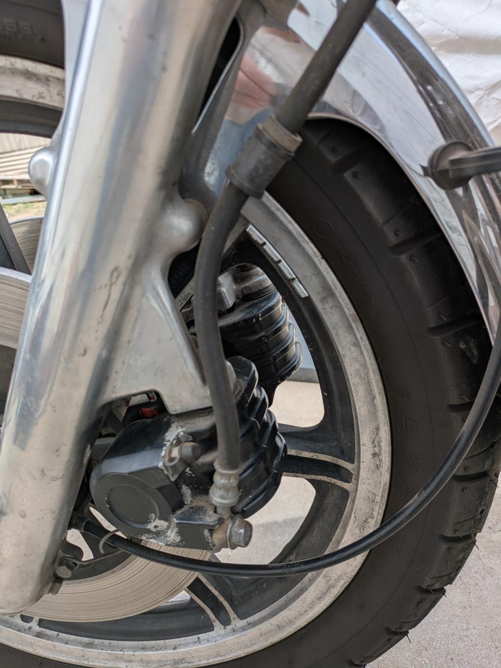

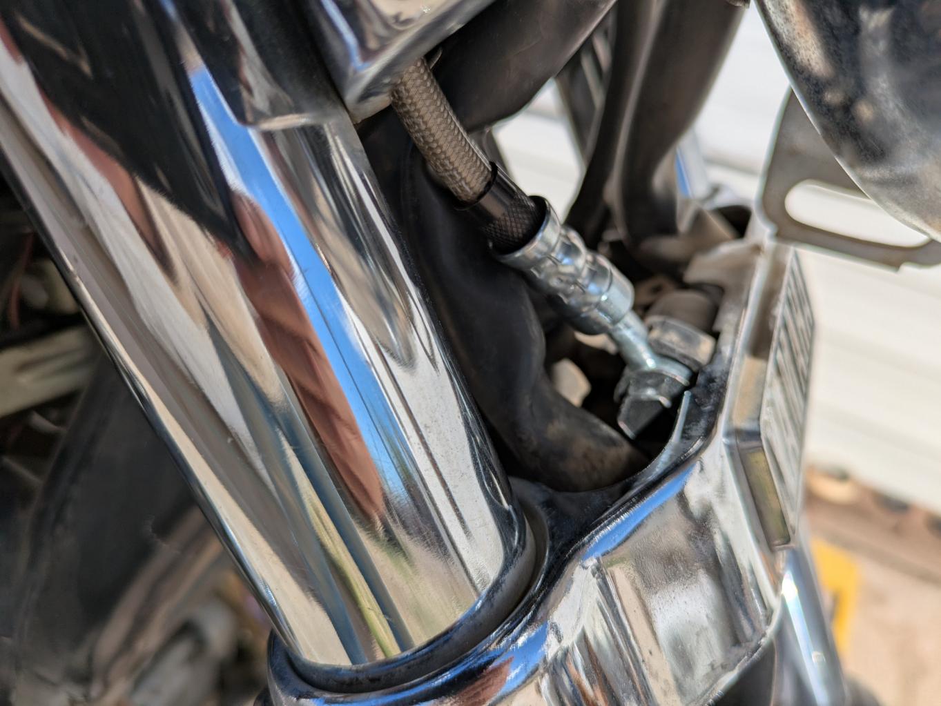

    Seems that under pressure the fluid is S L O W L Y leaking from some wheres near the grommet. (-‸ ლ)
    FoAr the stats nerds out there-
    16843 miles on the bike. Always stored outta the sun. 46 years of faithfully coming to a controlled stop thousands of times. (●´⌓`●)

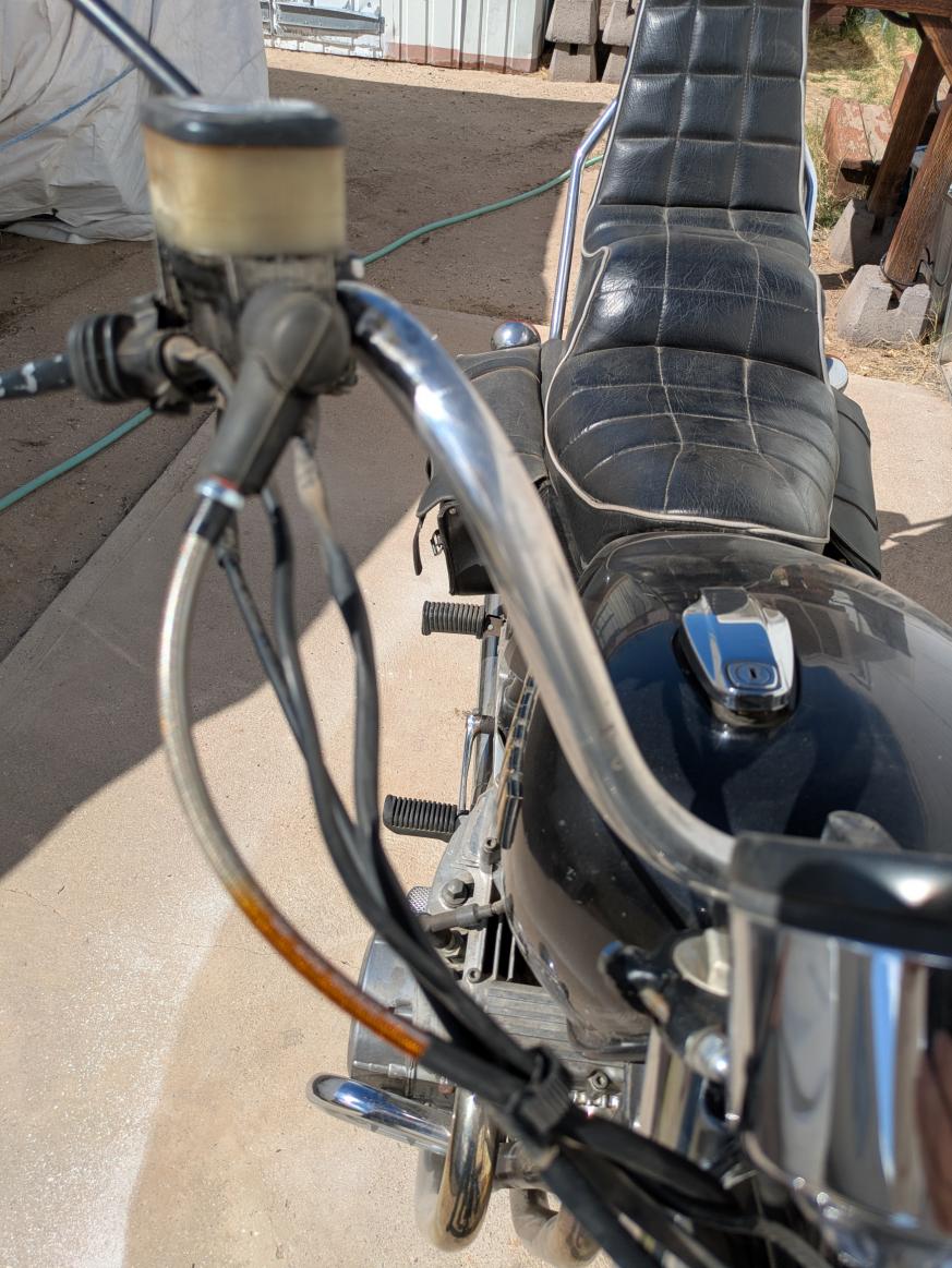

  • #2
    Happy Happy! Joy Joy! ლ(⌒▽⌒ლ)

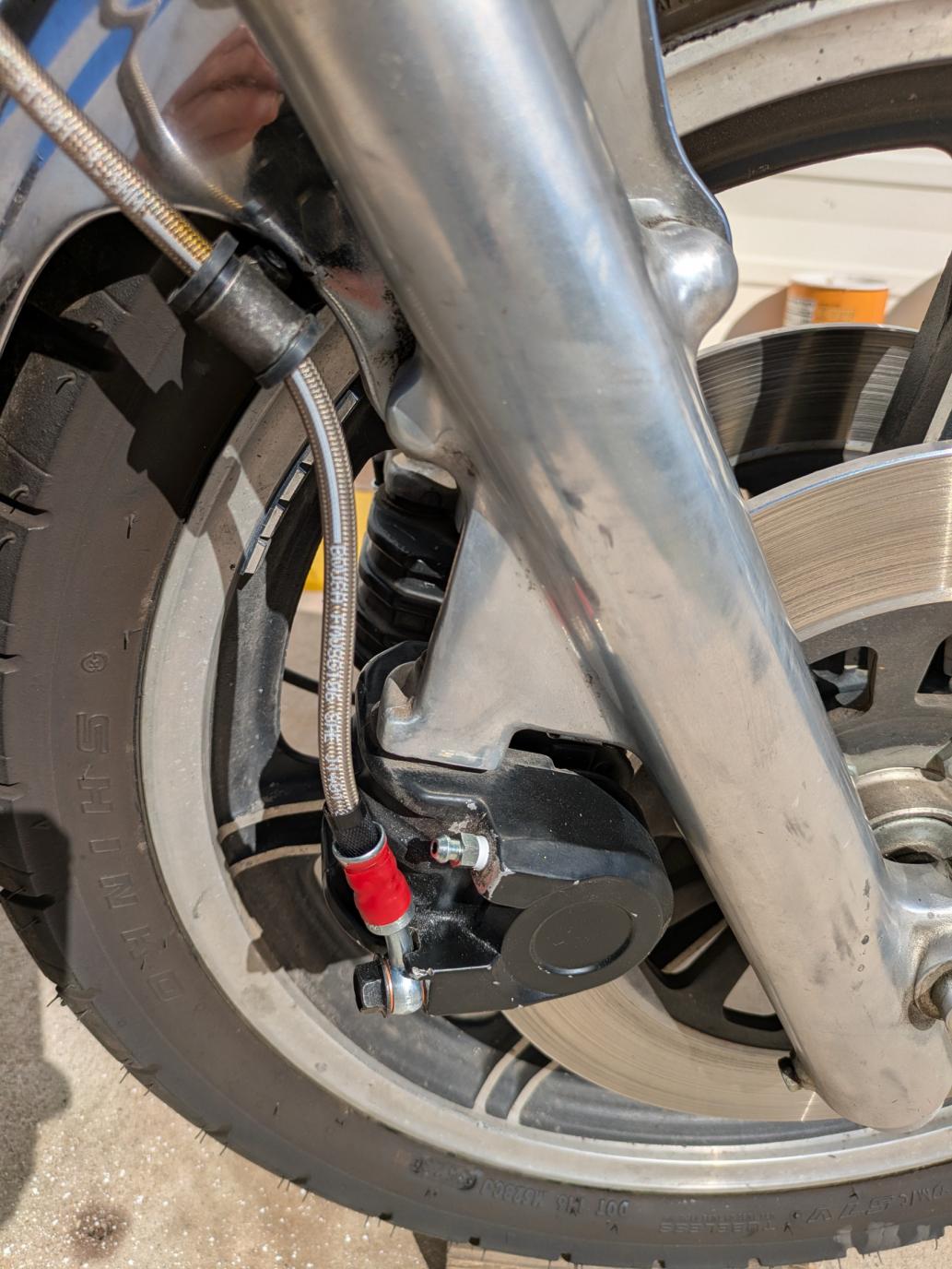

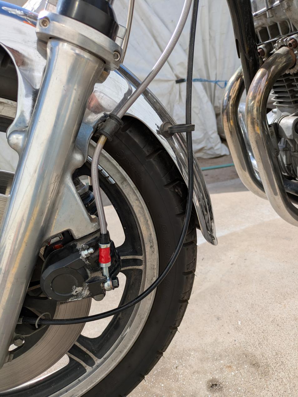

    • #3

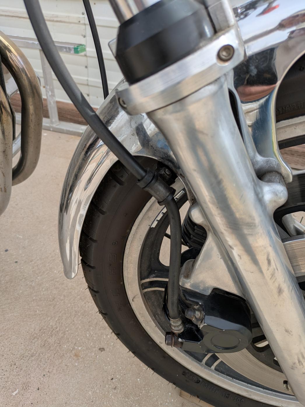

      Left side...
Name:	LS Before.jpg
Name:	LS After.jpg

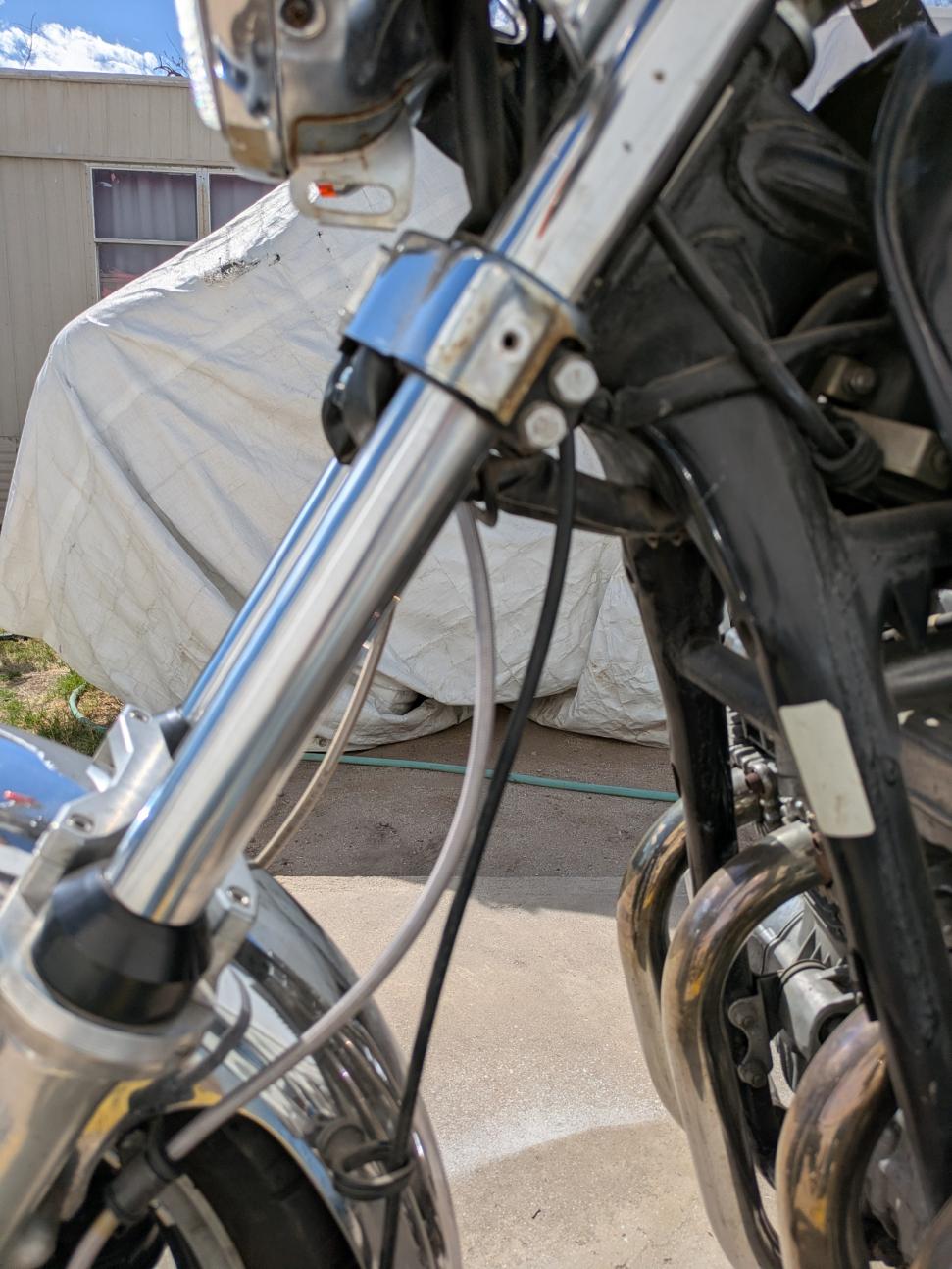

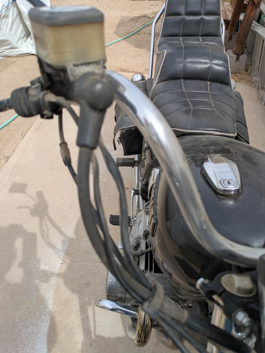

        • #5
          Front MC....
Name:	Top block after.jpg

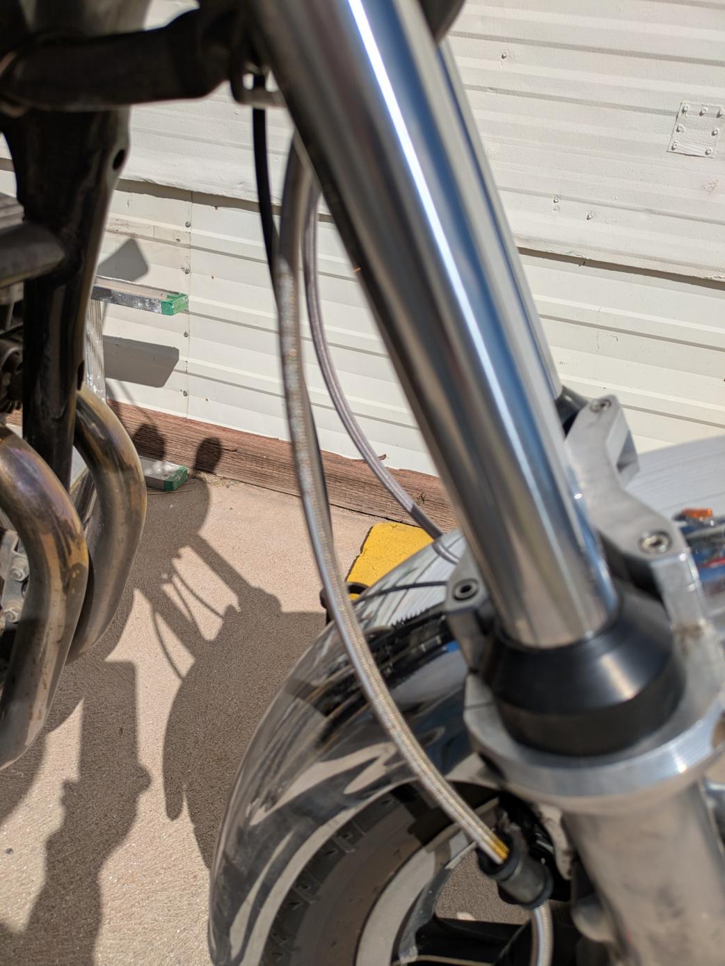

          • #6
            Side views...
Name:	RS mid after.jpg
Name:	LS mid after.jpg

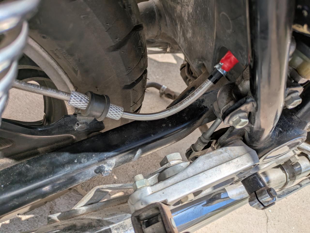

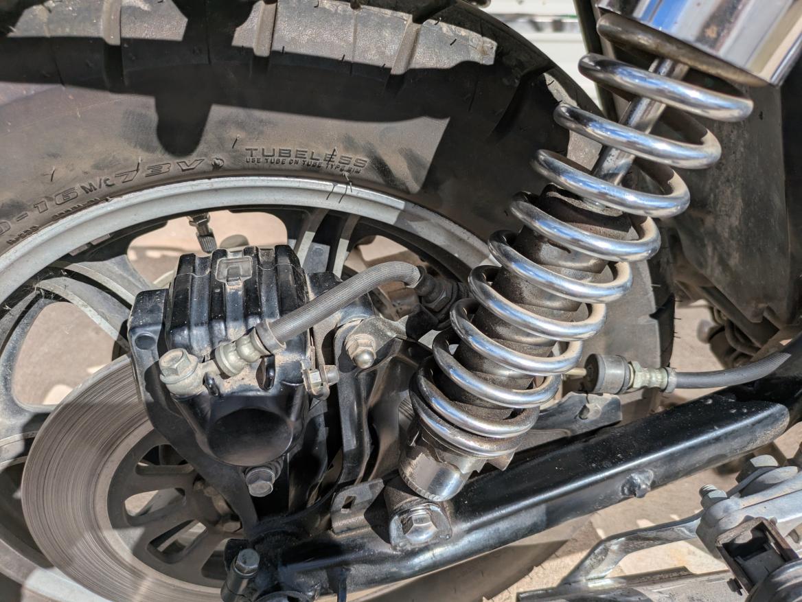

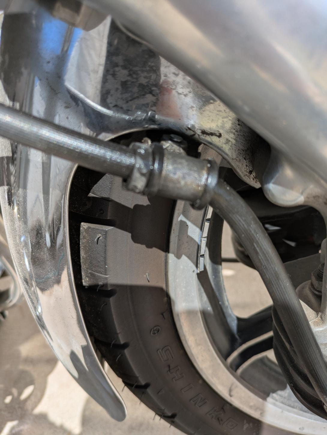

            • #7

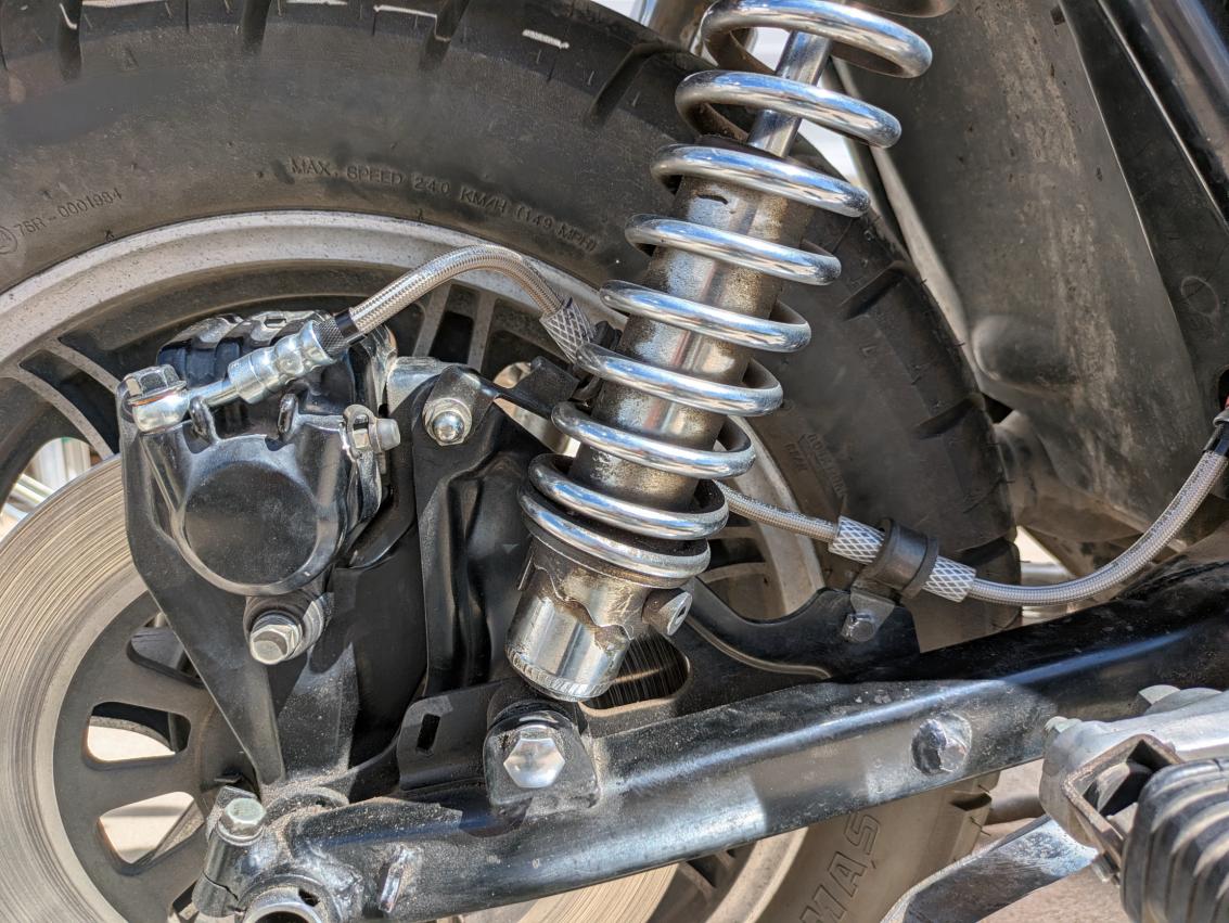

              Rear.....
Name:	Rear line before.jpg
Name:	Rear 3 after.jpg

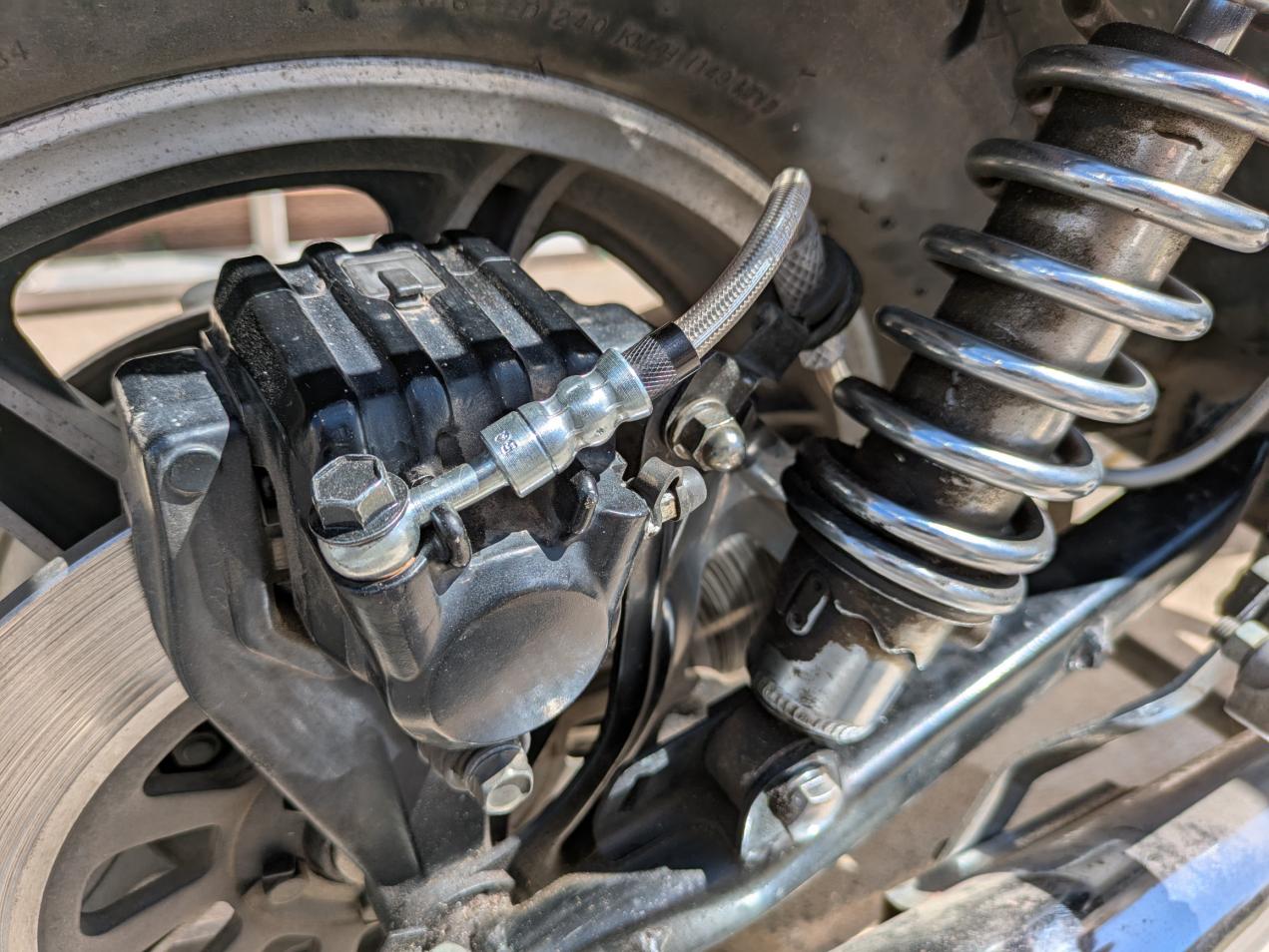

              • #8
                Rear Details...
Name:	Rear 2 after.jpg
Name:	Rear 1 after.jpg

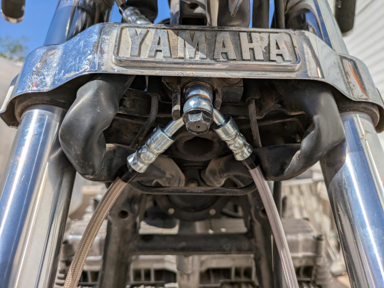

                    Hey Larry:
                    This is on my list of "to-do" items for my bikes, and the XS750 is first in line.

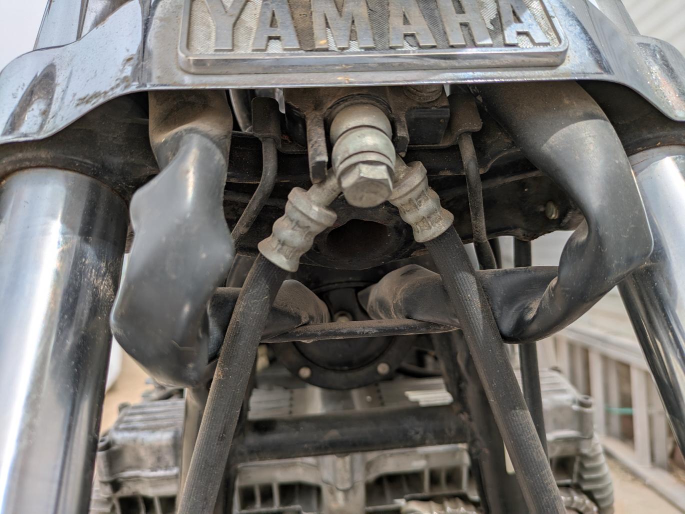

                    Were you able to get the top banjo bolt from the front union joint off without removing the fork and emblem? Any advice?
                    • #11
                      Larry, you're gonna notice a big difference in the feel of the front lever now. I think that stock M/C may measure 11/16" (17MM) bore.
                      • #12
                        Originally posted by Radioguylogs View Post
                        Hey Larry:
                        Yes...Yes I did. (⊙_ʖ⊙)
                        Had to turn the bars/forks to the LEFT and approach from the wide open tank side. 12mm short or full length wrench wurky just fine but NO room fOaR a ratchet/socket. Even the Mini 1/4 inch drive wouldn't fit due to clearance/space issues with the HeadLamp Umbilical sheathed wire bundle. ┐(´д`)┌
                        Due to the Headlamp Umbilical, was in that Oh So Familar situation wheres I wrench with one hand whilst fighting the Umbilical with the other and wishing I had a third hand too. ┐(‘~`)┌
                        But thanks to the Yammy engineers, there WAS just enuf room to get the old bolt/fitting out and the new ones in. ヽ(•‿•)ノ
                        I'll do a separate post/thread with mOaR pics showing some of the different ways that I (caps intended...) did this operation. (´◡`)
                        Mebbe that'll help iffin someone else tackles this same or similar situation... (◕‿◕)
