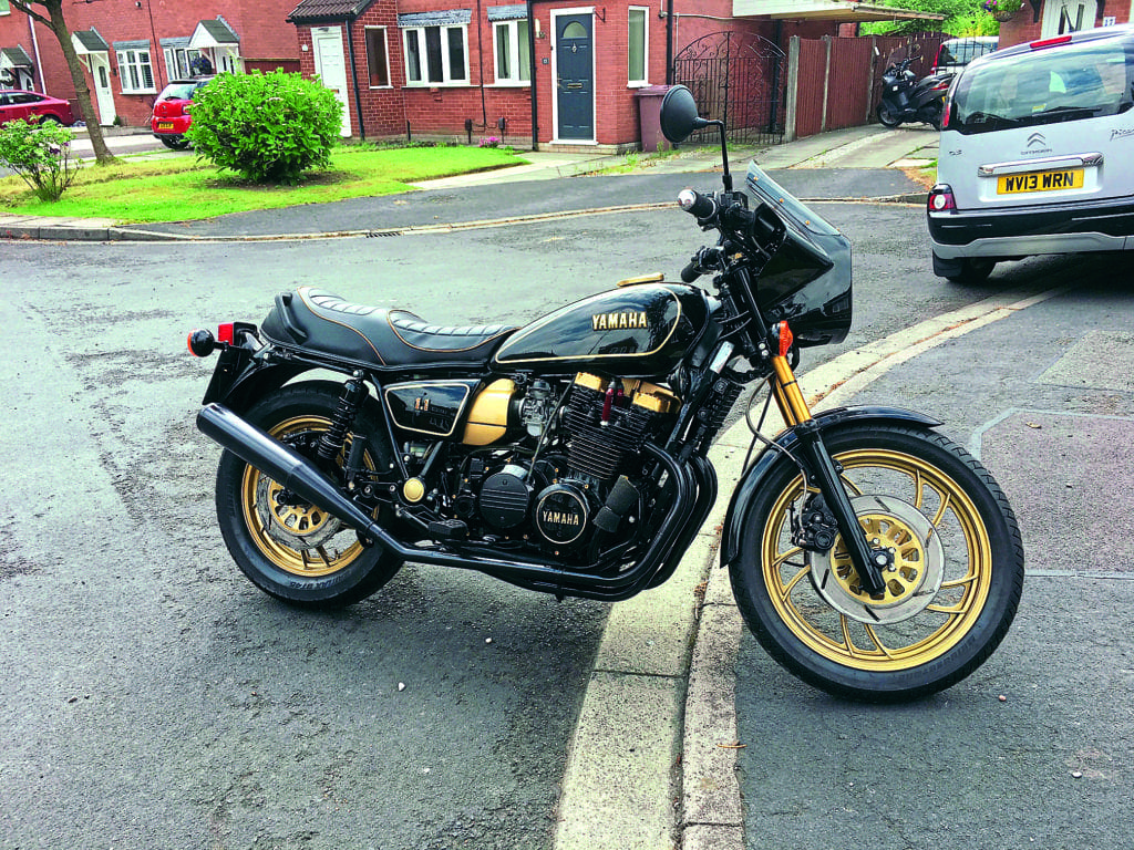

            The sport was only released in Europe. The front end is more like the standard versus the US specials.
              It has a leading axle like the Special. Do the XS750 and XS1100 have the same fork diameter? It seems donebysunday fitted the Tarozzi brace on a Special way back when.
                I found a donebysunday post.
                This would be the Tarozzi fork brace made to fit the European XS1100 Sport, I like it's looks better than the T-kat.
                I fitted one of these to my LH which has same measurements as any other Special but the sport is different, the Tarozzi brace will fit but I had to elongate the mount holes in the fender, lowering the fender to clear this Tarozzi brace.
