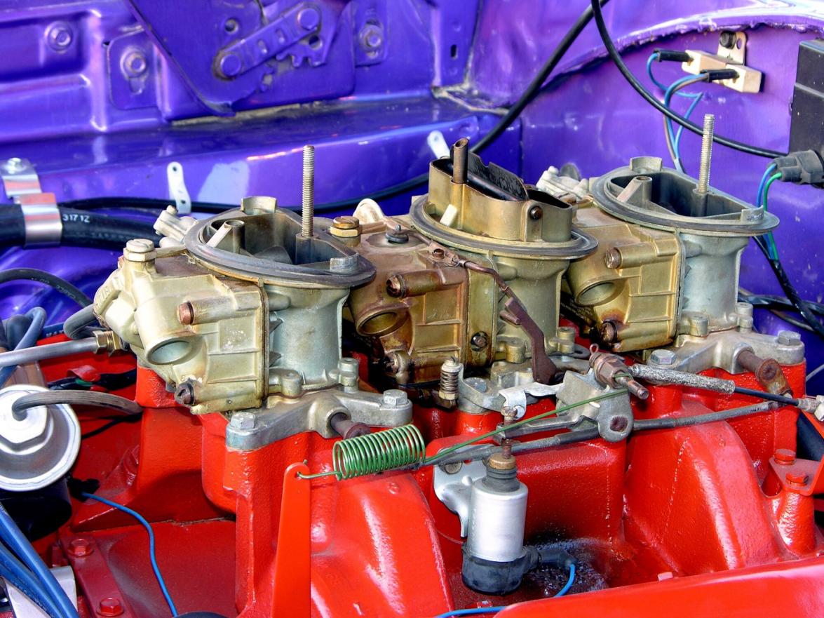

                It gots three(3) two barrel carbureatators but fOaR all poipose general driving it only uses the middle 2 barrels so's yur granpa can take it to Walgreens and back w/o wrapping it around a tree. ( ˇ෴ˇ)>
