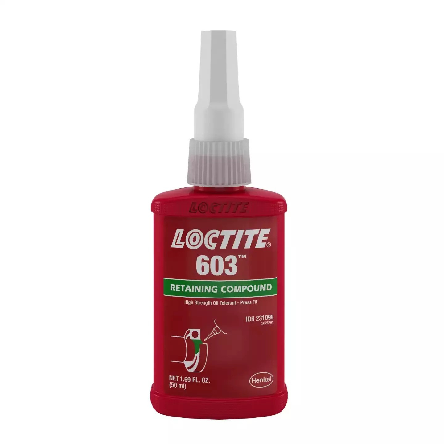

            Use bearing retainer.

              That does seem to be made for exactly the purpose that I want to use it for. I'm curious how it forms a bond with parts that are lightly coated in oil, but I am guessing that the answer will be well beyond my understanding of chemistry.
                Dave, clean the metal surfaces with brake cleaner before applying. All it takes is a light coat of 603. Assemble and let it cure. Once cured it is resistant to oil and gas (but not extreme heat).

                  10-4! I actually stocked up on brake cleaner this past weekend. 😁 I was unfamiliar with Loctite 603 - green so I looked it up, and I was surprised when it said, "Suitable for use where consistently clean surfaces can't be assured, such as parts lightly coated with cutting fluids or rust preventative oils." I'll be cleaning the part before I reinstall it anyway. It actually has some green residue on it that I believe is from the Tygon hose that I used when I replaced my fuel lines.
