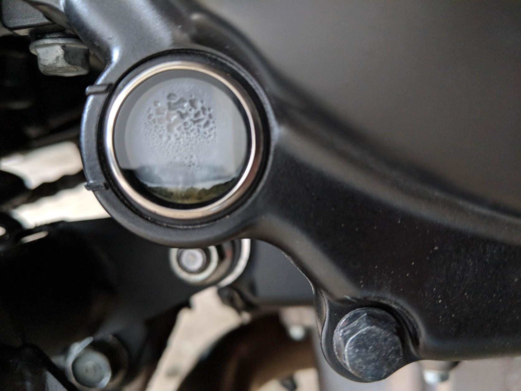

      Another thing to mention is that it's usually caused by short trips and sometimes not enough oil changes this can cause water build-up. You probably have a lot of moisture in the crankcase which is normal for a bike that sits for a period of time. The easiest cure is to pop start it (your 81 doesn't have a kicker shaft) and ride it on the highway for a few hours to really heat the motor to burn off the water. However, If you get the engine running and just let it sit idling to warm it up, you will actually increase the amount of moisture in the motor which will make the problem worse. This is why you should never start your bike in the winter and not actually drive it.
      If you do ride for a few hours and really get that motor up to normal temperature, drop the oil & filter and put Rotella 15W/40 in it. Don't start it again until you are ready to ride.

        What has been said are both valid points. Question. Specifically what kind of oil are you using in the bike? The reason I ask is because if you are not using a high quality motorcycle oil then the sludge that is being formed inside the engine is probably part of the issue. Oils engineered for cars is not well suited for use in motorcycles. It has been known to cause problems with sludge buildup. The starter clutch falls victim to this sludge.
