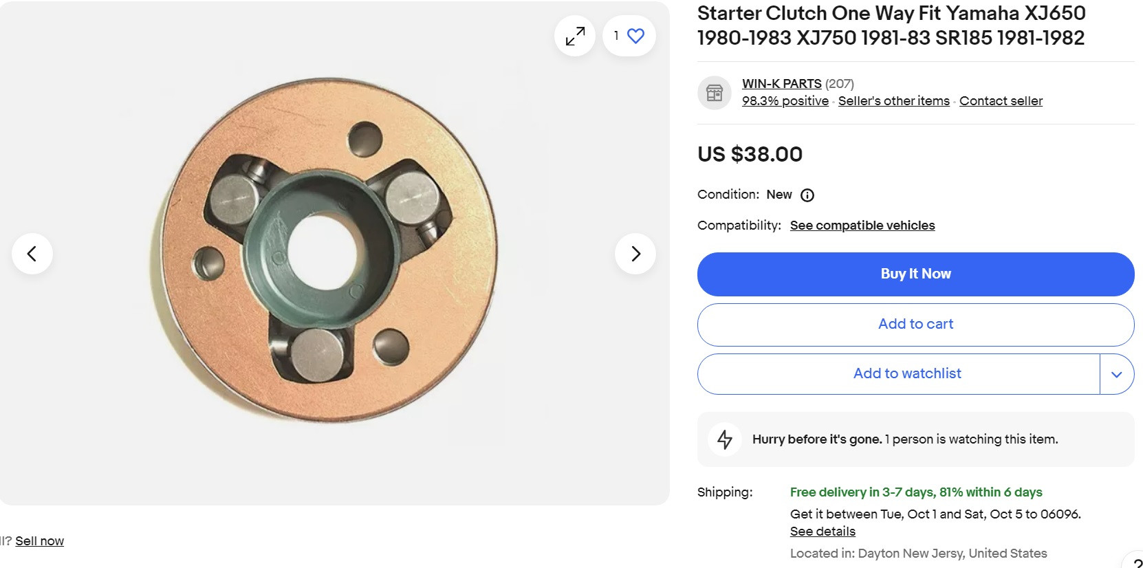

      Your issue would still need to be properly diagnosed but in the event that it is a starter clutch.
      https://www.ebay.com/itm/15569439457...Bk9SR7CTrKrGZA
Name:	XJ starter clutch.jpg
