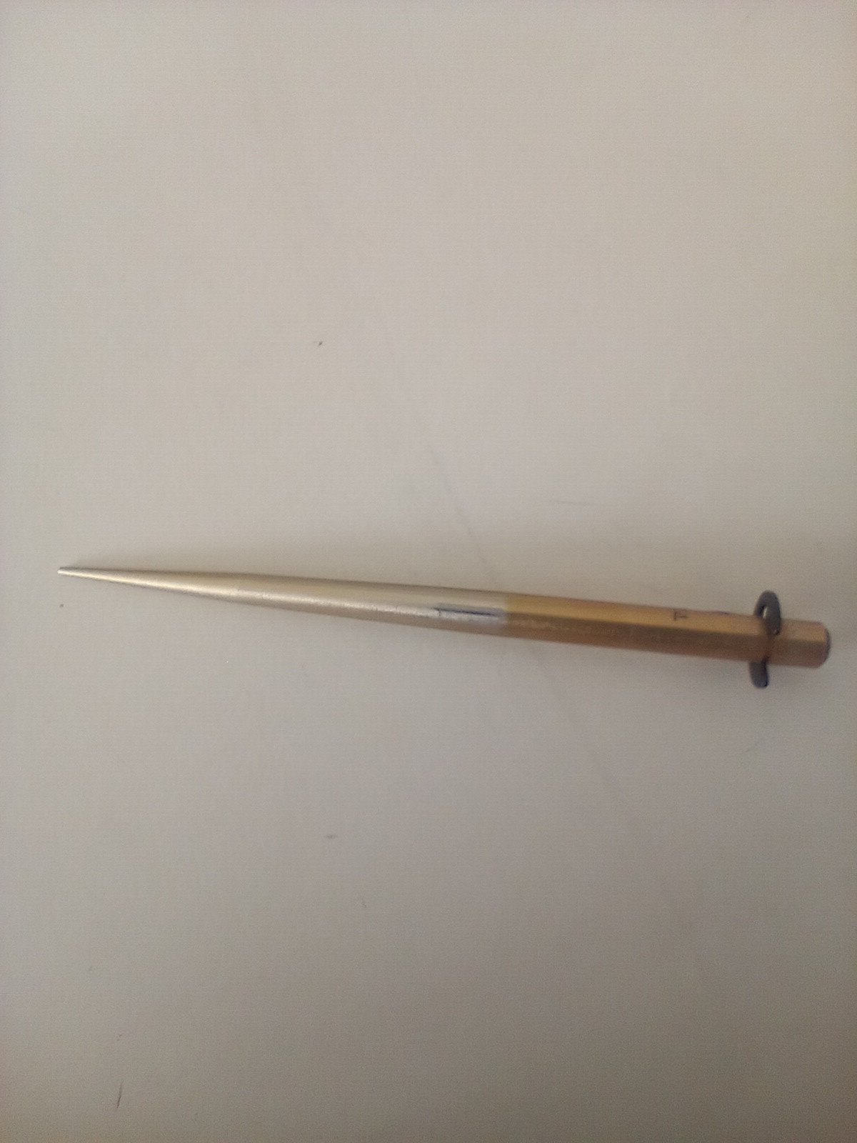

                    I suffered very poor fuel economy a few short years ago. I’ve put over 100,000 miles on my SG. I was getting 25 to 30 miles per gallon. I went through all the obvious stuff. No joy. The fix for me was replacement of the emulsion tubes and the needles. That got me back up over 35 mpg. Reproduction needles and emulsion tubes are available from XJ4Ever.com if you should come to the same conclusion.
                      Yes, what Marty said. I've done this a few years ago too. If you take the diaphragms out of the top of the carbs and the needles have visible wear, this can cause loss of smooth acceleration and reduced fuel mileage. If you do end up replacing them, get the needles and emulation tubes from Len at XJ4ever like Marty stated. They will be exact and not cheap inferior quality which will never work correctly.
