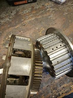

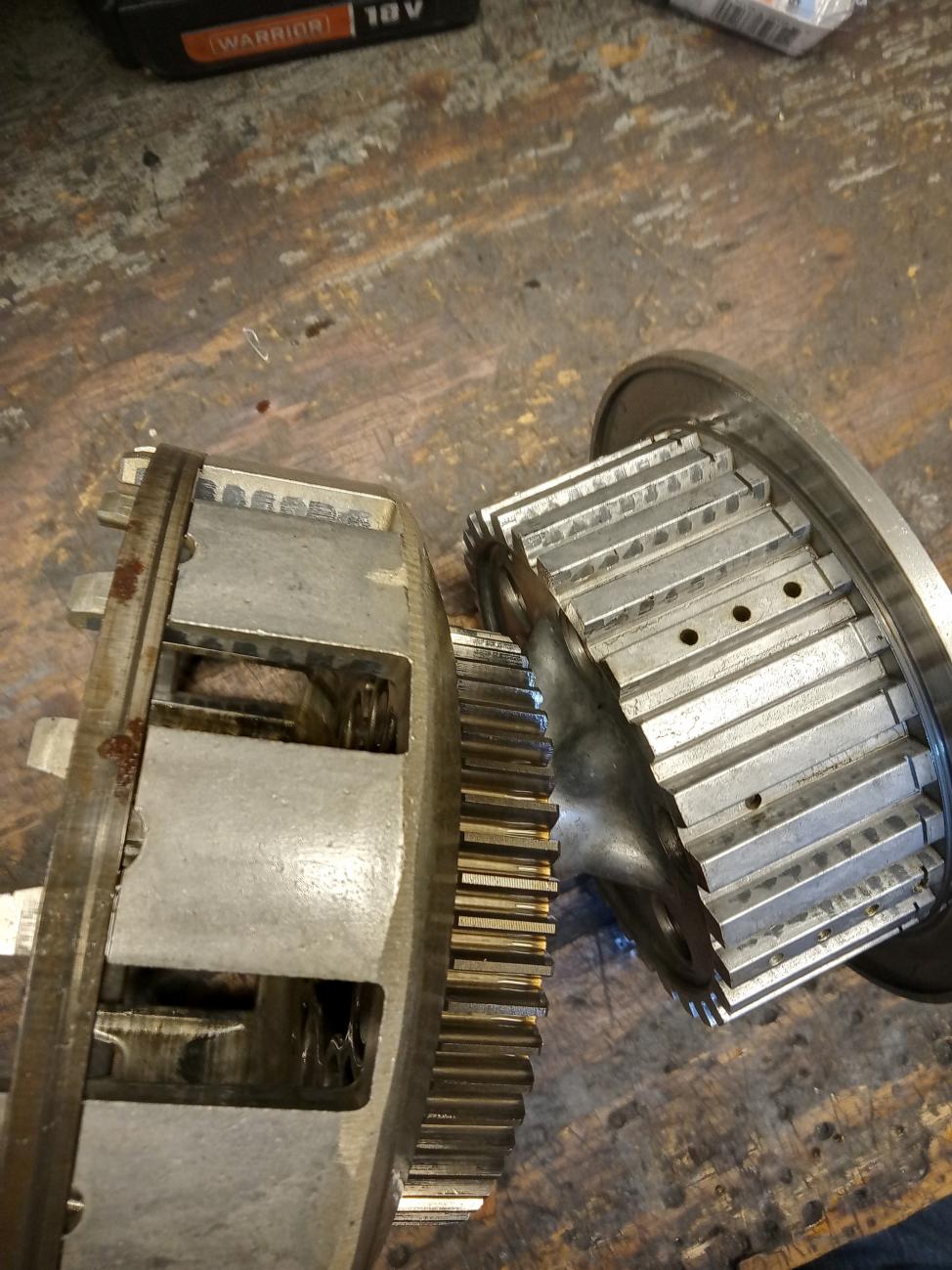

                    Update on this...
                    Seems like it was a clutch problem after all. There was some major wear on the clutch boss and the basket most likely causing the hangup. Replaced both with low mileage units that I resurfaced with a small file. New frictions and springs and now working perfectly.
