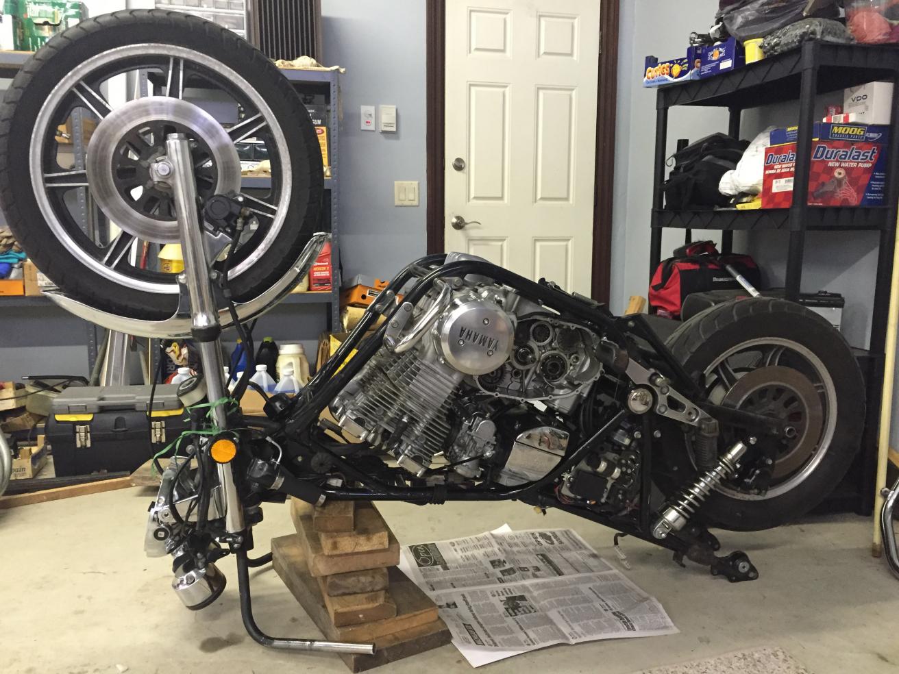

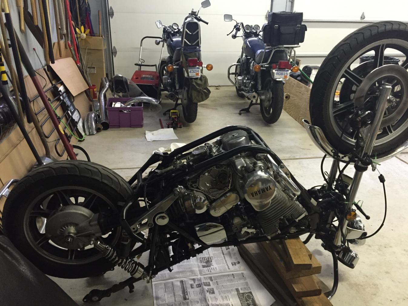

    No need to split the cases to fix the tranny.
    Do a search.
    You can flip the bike upside down and get it done through the oil pan opening. A few guys have even done it without flipping the bike over.

      Well that's good to know. Hopefully I can just lift the front end up with a hoist and do it from underneath. As heavy as these are I don't know that I could get it upside down lol.
        We did Special Ed's machine in my garage a few years ago. Hoisted up the front as high as possible, and had it done in one day. I had a LOT of help from 3phase and I think Roo, it's been a while and I am getting older....
        If you flip it upside down, it IS easier to do the fix, as the parts fall into place a little better. I've done it three times now.
          I've done many, probably 10 or so over the years with jack stands under the aluminum rear foot peg brackets. Take the center stand off if it seems to be in the way.
            I love those pictures!
              Sure looks do-able according to the photos..... (☉_☉)
              AND it looks like you don't gotta deal wit the #1 complaint most new owners present-
              Pulling off/Putting back on the OEM Airbox. \(^_^)/
