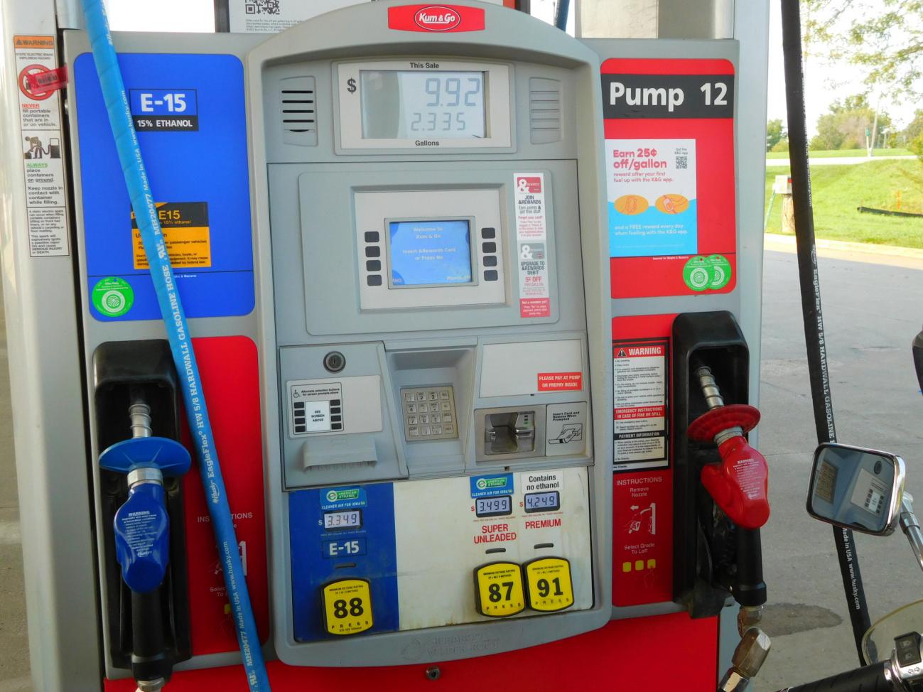

                Sadly, many of us cannot find ethanol free anymore. It is gone.... not much we can do about that.
                  It's very rare here in the Northeast. I did see some out west once. 15% (ethanol) should be avoided totally for all older machines of any type including lawn mowers.
