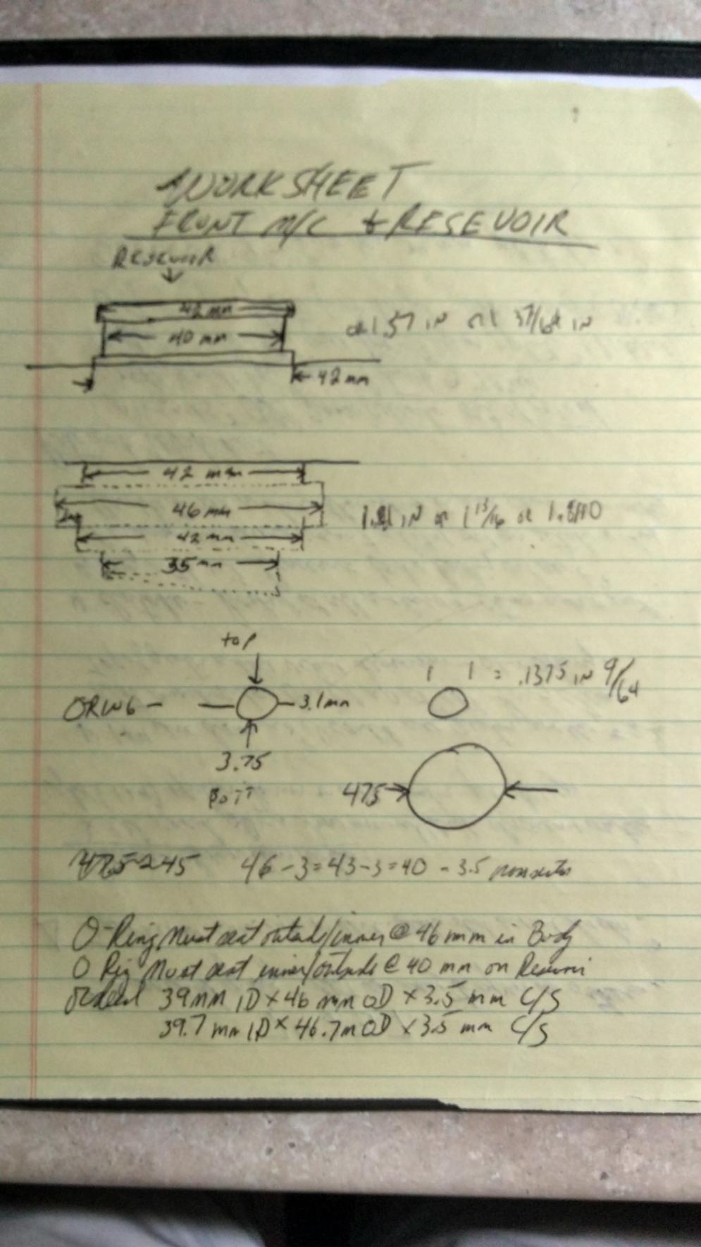

      Had to go back to my highschool days of mechanical drafting. Made basic drawings of both MC and resevoir. Measurements taken with digital calipers. Then High school math again to figure out what "space" needed to be filled by O-ring. Added 1/2 mm fOar the squeeze factor. ヘ( ̄ー ̄)ノ
      Ended up ordering the right size online at O-rings and more. (~‾⌣‾)~
      Just saying, Mr GreyBeast....iffin' yur in uncharted territory and no one here knows the right size? ┐(‘~`)┌
      Still not an unsolvable problem.... ( ಠ‿<)

          Still... when ordering online? Need only 2 (two) pieces of info- the diameter and the "cross-section" you want.
          Diameter easily determined by taking the measurement(s) of inner/outer surfaces the O-ring will seat against, subtraction to find the difference between them, and then dividing that in half. I mean that's where's the O-ring is gonna ride, right? Smack in the middle between the two surfaces. ┐(°,ʖ°)┌
          Cross section of the O-ring (how FAT/Plump it needs to be...) is just that difference/subtraction between the inner/outer surfaces distances.
          Like mentioned before, With measurements made by a harbor freight digital caliper I was able to "do-the-math" and came up with the O-ring dimensions (diameter/cross-section) fOaR wut everybody sez was the right one anyways. (^_^)
          The EPDM vs NITRILE vs wutever??? ( ´・_・`)
          That's discussion is still ongoing and 'bout as useful as the oil or tire threads here on the site... ¯\_(°╭╮°)_/¯

            Oh nice, with the formulas I should be able to work that out. It's extrapolating the formulas from what was written down that I was like ...dafuq?
              Well....yeah. Yur right, Mr. GreyBeast. (◞‸◟)
              Definitely mOaR than just a bit comfusing iffin' one is looking at the drawings/worksheet I did. ( ⚆ _ ⚆ )
              But the worksheet wasn't just to figure out wut O-ring I needed. ( ◜◡‾)
              At the time I was also getting the measurements I needed fOaR the photorealistic 3D computer model of the reservoir/MC currently "in the queue" to be processed. ( º﹃º )
              The system I use gets the computer model size/shape/accuracy within .2 mm (point two of a millimeter). That's like....the width of the line made by a sharpened #2 Ticonderoga Pencil. (⌒ー⌒)
              But It's always bestest to get real wurld measurement(s) as a reference fOaR the model so's the worksheet got's em. ( ・_・)
              Again....yur right. WAY overkill iffin' somebody just wants to figure out wut O-ring to order. My Bad. (o´_`o)
