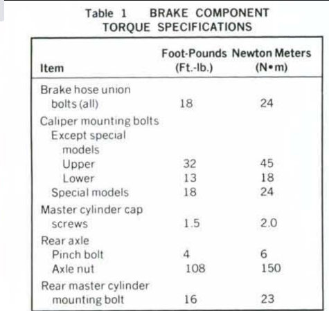

        Looks like 18 foot pounds.....24 fig newton meters.... (っ˘ڡ˘ς)
        From page 255 of the fOaR free service manual offered by C-Bug...(*^‿^*)
        Click image for larger version  Name:	Brake_Torque.png Views:	0 Size:	123.7 KB ID:	880587

        wuz wut I torqued both calipers to last time and they haven't fallen off or snapped off during braking.....yet. (^_^)
        I wish I could remember the places where the manual is INCORRECT as far as the right torques....(O_o)
        Listed somewheres here on the site I s'pose. I keep fegetting where tho...(_Oo)
