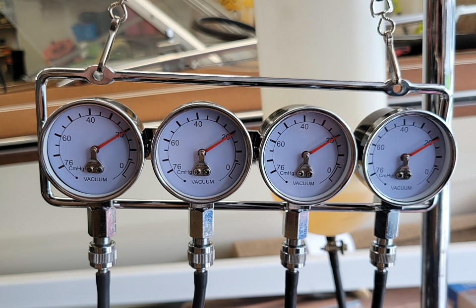

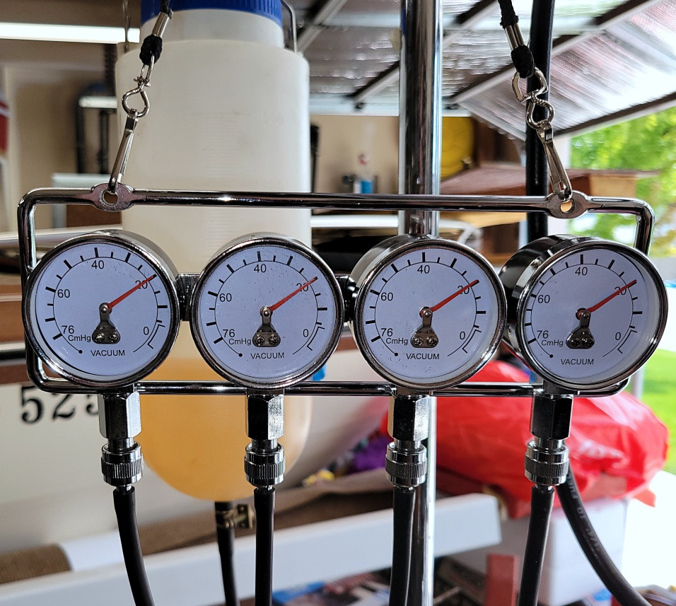

                One last question from me, Did you sync the carbs? You need to sync ANYTIME you remove them! Click image for larger version
ID:	880378 Click image for larger version
ID:	880379 The plastic bottle behind the gauges is the temp fuel tank I use to sync carbs.
