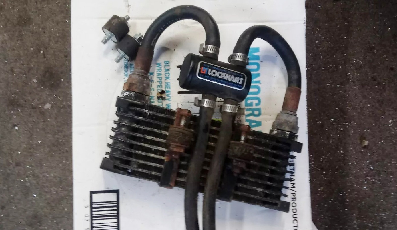

    I ran a set up similar to this for many years on my KZ1000 MKII. It never leaked a drop of oil.

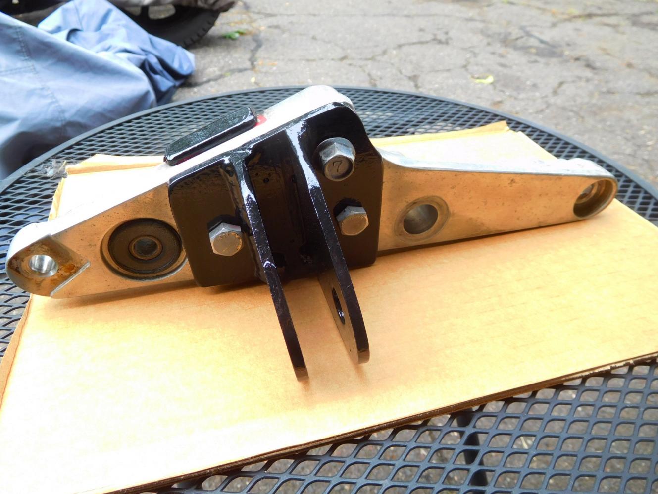

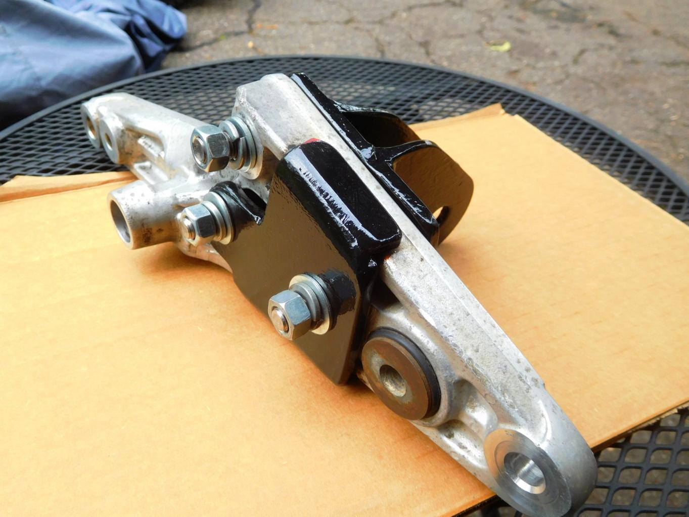

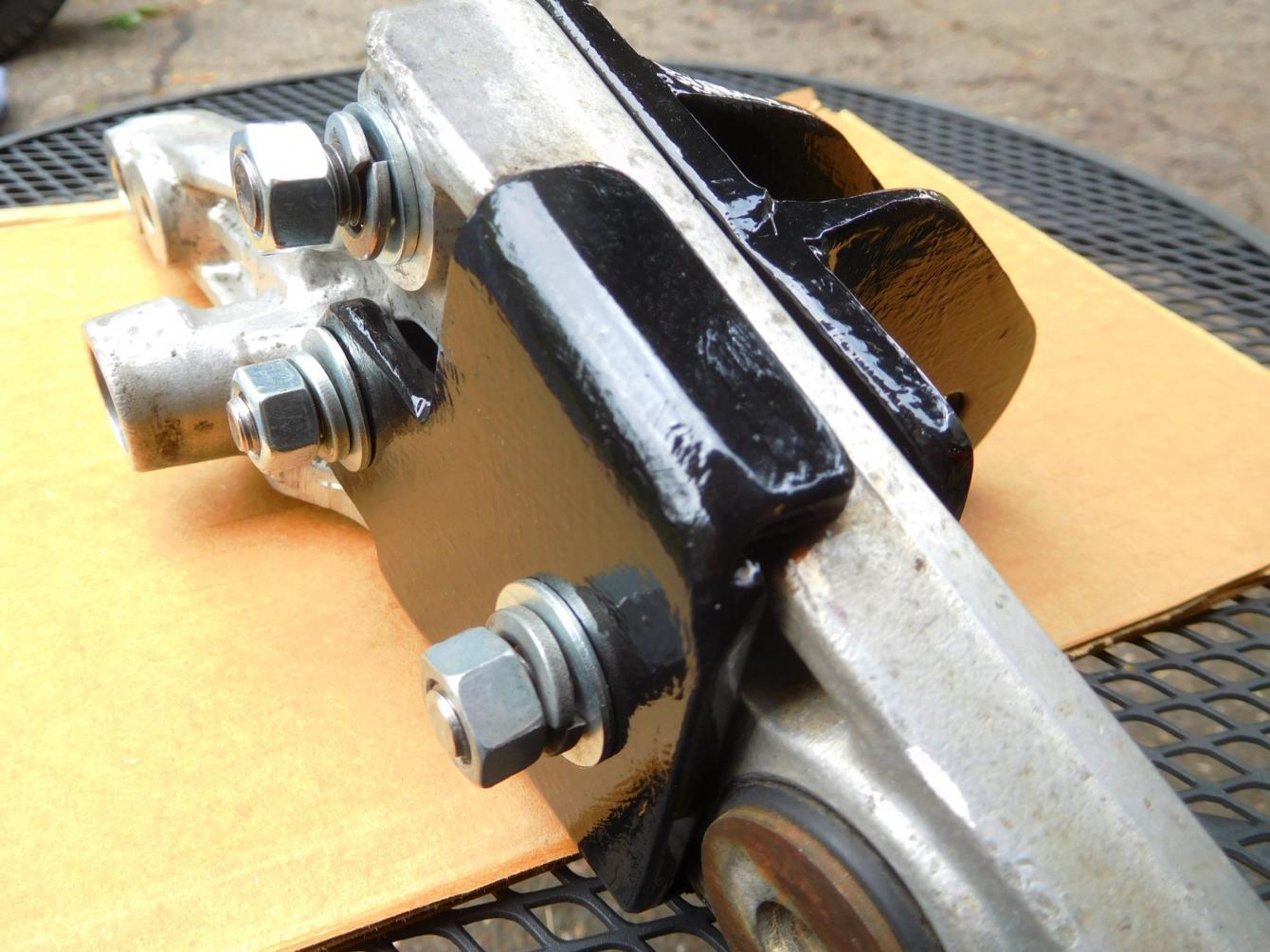

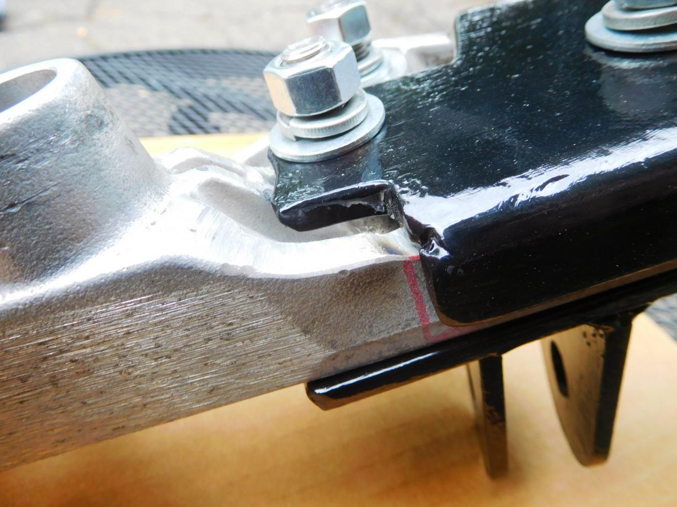

              You will have to fabricate what you need. I usually use cardboard to make a template and use it to make the final part out of steel.
ID:	880117 Click image for larger version
ID:	880118 Click image for larger version
ID:	880119 Click image for larger version
ID:	880120 Click image for larger version
