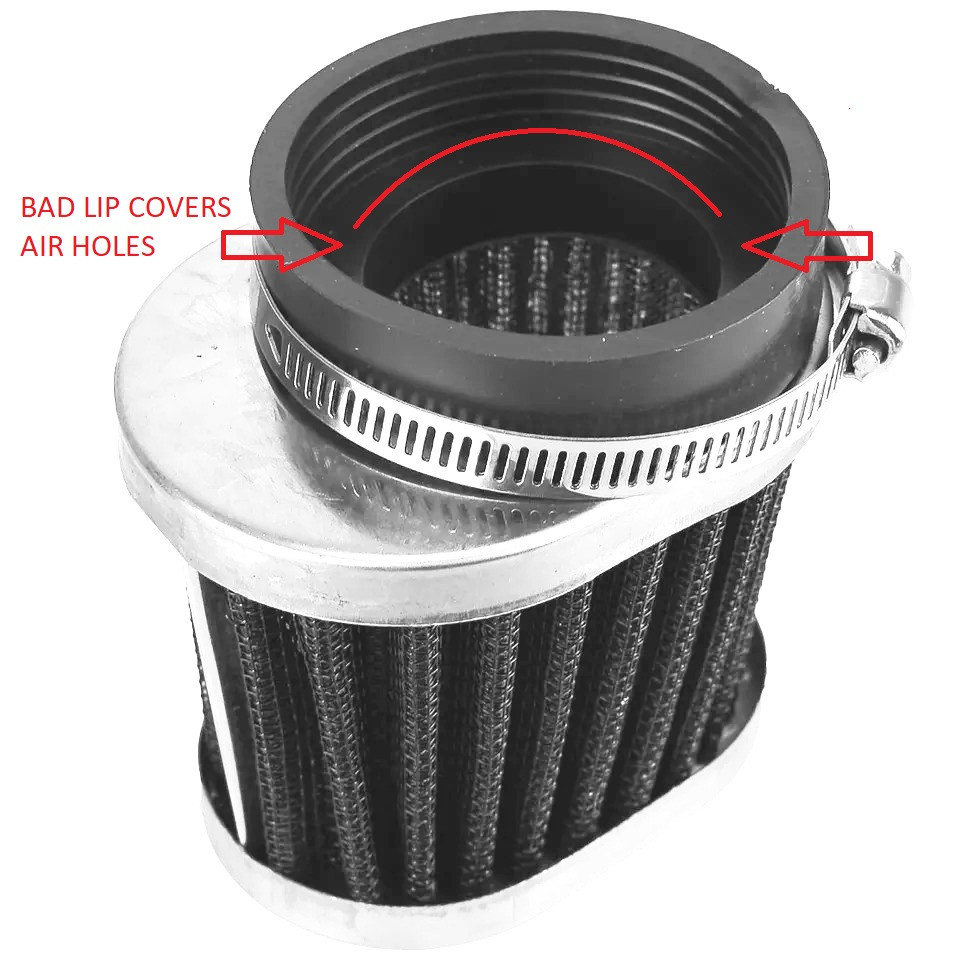

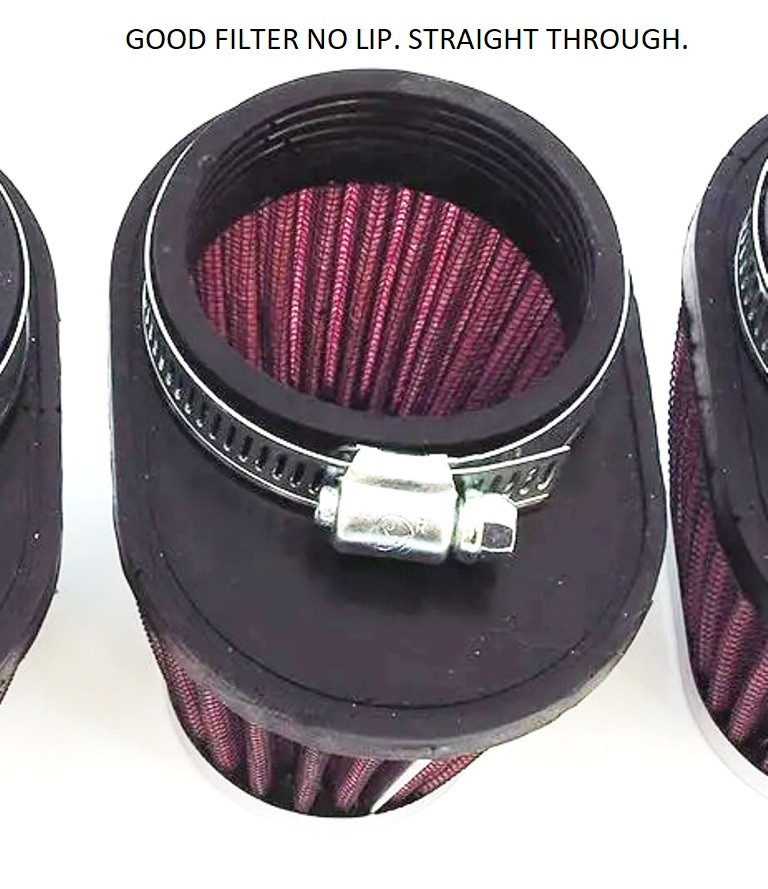

          Unfortunately this sounds like you have inherited some else's bad workmanship and/or bad (Chinese) parts. If the jets in the carbs look shiny you may have counterfiet parts. Socer4m's procedure is a good start. This a bad filter.

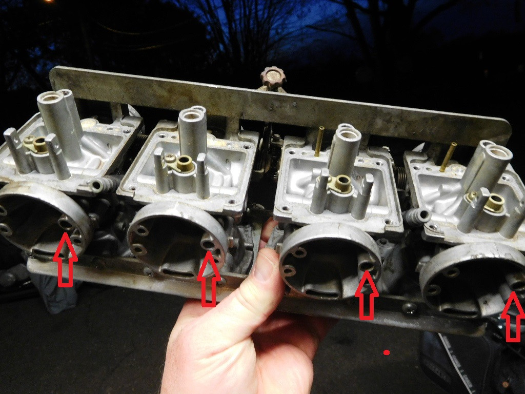

              Do not cover these holes. Any of them.

                You could cut out the parts of the lip that cover those ports, I've seen people doing that on videos.

                  What exactly are those holes that you're saying not to cover up? Some sort of vacuum ports, I assume?
                    Air jets that combine with pilot fuel jets and float chamber make up air orifices. If you block these areas you will have guaranteed problems. Add Chinese parts and your problems are exponential.
