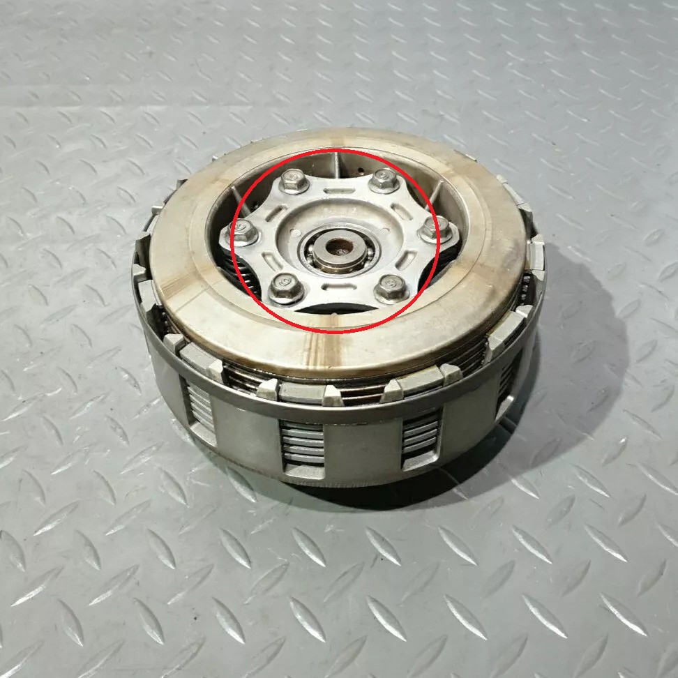

              The downshift hard thing is classic clutch plates not separating. It sounds like it could be a problem in the release mechanism. Maybe catching a burr.
