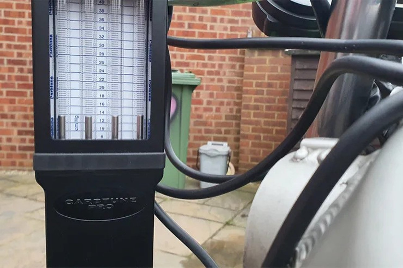

          If you plan on keeping the bike you might want to consider buying the tools, if you don't already own them, for doing the job right. The Morgan Carbtune gauges that Deebs has a picture of above is a great tool for synching. I have owned mine for over twenty years which is a testament to it's durability. morgan carbtune pro for sale | eBay Another tool that I have owned for about the same amount of time is the Colortune. Gunson 10mm COLORTUNE #4072 Fuel System Diagnostic Tool - SHIPS FROM USA | eBay. There has been a lot of discussion on this forum over the years and many like it and many don't. I am in the camp of liking it. Ray and Deebs have both explained and illustrated the DROP method. That will get you close as Ray explained. The Gunson product lets you dial the pilot jet screw in. Of course like Ray stated, in order for it to work correctly you have to make sure that you do not have any vaccuum leaks. Leaks make it virtually impossible to get the carbs tuned in. I always rebuild the carbs on all the bikes I acquire. That includes replacing the butterfly shaft seals and I also remove all the intake manifolds to make sure there are no paper gaskets and if there are I remove them. I clean both surfaces on the engine side and the manifolds then apply a coat of yamabond. That ensures there are no leaks. I then use the Gunson Colortune and set each pilot screw to just the hint of an orange flame. That indicates just a tad on the rich side. Makes the bike run a little cooler.

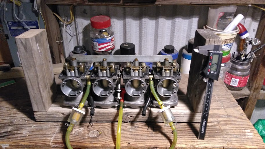

            AFTER you've confirmed that any and ALL jets in EVERY carb are genuine Mikuni and not the cheeepee Taiwan copy-cats from E-bay? (O_o)7
            I call it the "Carb Pagoda". Takes a lot of the clumsiness outta what GOTS to be done. ๑(◕‿◕)๑
            (Carbs are wire-tied to the Pagoda and securely attached....)

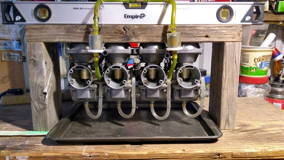

            Seen other ways but....THIS is the way I does it. (◠﹏◠)
            I mean it's a "What cannot be shunned must be embraced" situation, right? ¯\_(⊙_ʖ⊙)_/¯
            Otherwise yur XS is gonna be HaUnTeD by the popps/barks of the PO's Taiwan parts and fuel levels that IN-NO-WAY are the correct level in the bowl even though they've been double/triple checked fOaR float height wit' a digital caliper. (つ﹏<。)
            I mean the Waste-Spark ignition on these engines WILL ignite the unburned fuel left over in the cylinder from a carb with a overflowing/high fuel level and/or an Idle jet that Dribbles/drops the fuel instead'a a fine mist/spray in the correct ratio. (ㆆ _ ㆆ)
            That waste spark (and ignition of the left over overly rich mixture) is at he WRONG moment mechanically and can have the engine try to run BACKWURDZ for an instant. ヽ(O_O )ノ
            Additional photos below show what I FOUND my fuel levels to be. O'course they're set right NOW. ( ‾́ ◡ ‾́ )

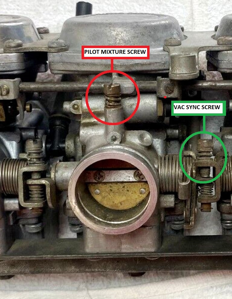

                    Which screws? The pilot screws? If so, your Idle is too high. Lower it so you can get some adjustment. Your throttle plates are open too much and letting in fuel through the emulsion tube/needle. This is why you have no adjustment.
