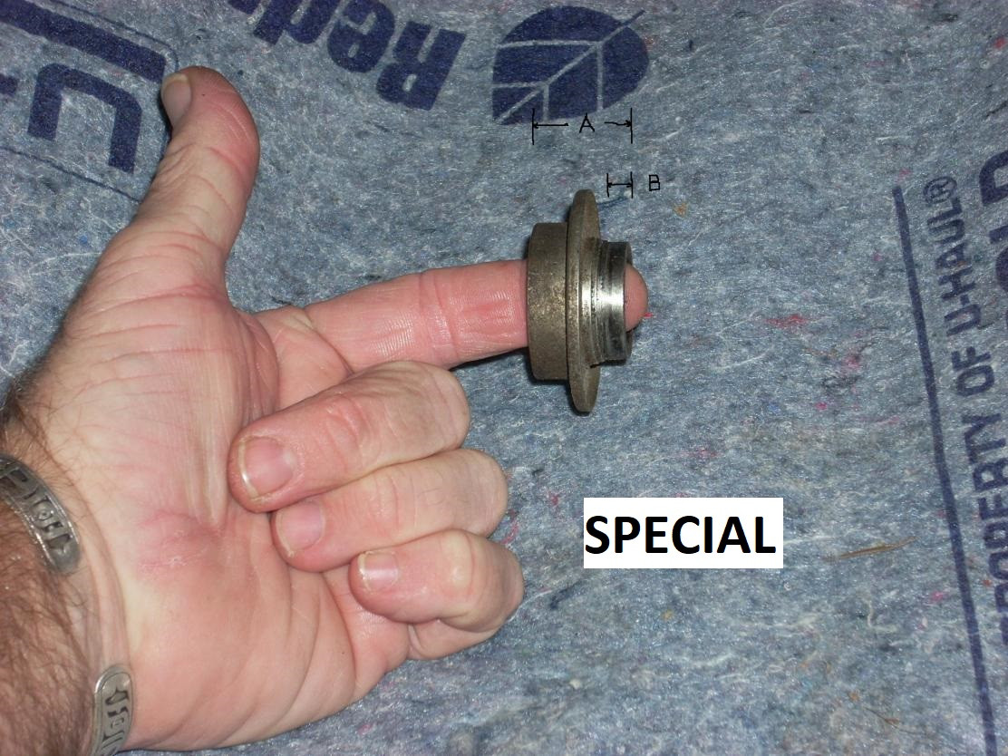

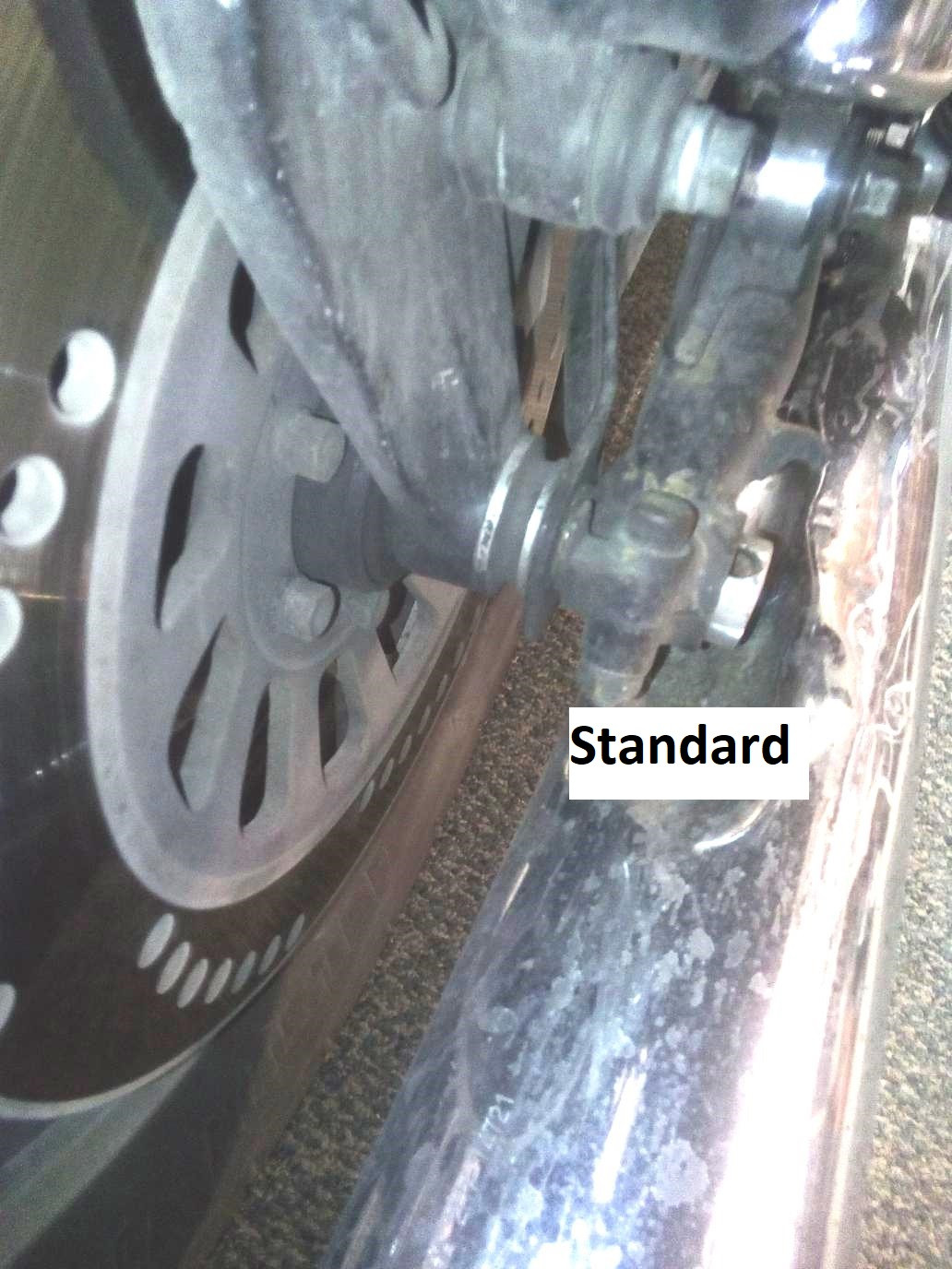

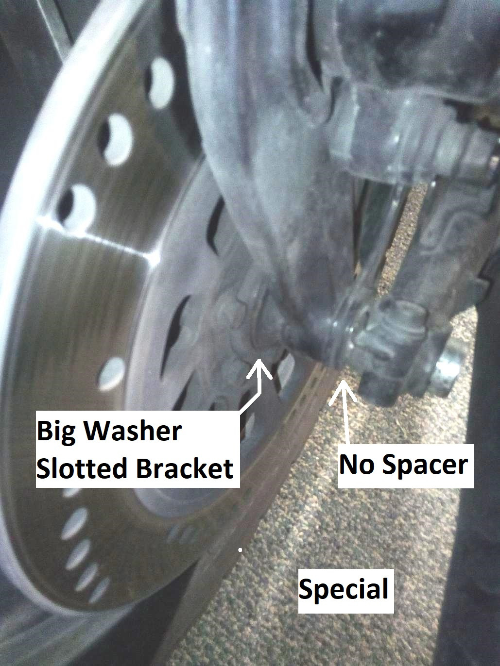

      I've been considering the same thing and besides the rim you'll also need a "Special" rear brake caliper bracket as well as the axle spacer that goes onto the right hand side.

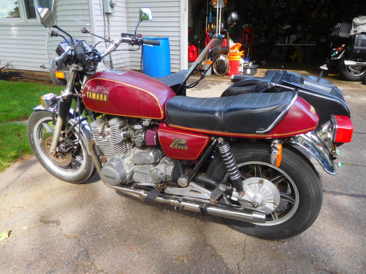

      The user DEEBS has mounted a 5.00x17 car tire onto his side car rig, that's another choice.

        LAB3, it's actually a 16" and I love it! I had swapped out the 17". You need a caliper bracket and right wheel spacer from a Special to do it.

          Some more info on the swap.

            My mistake! Remember looking for and finding a 5x17 and shortly thereafter you posted some pictures, the tread pattern led me to believe it was the 17.
