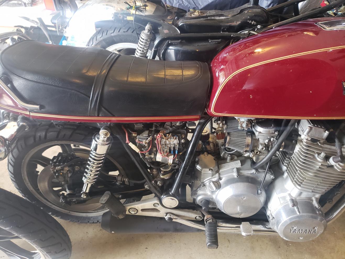

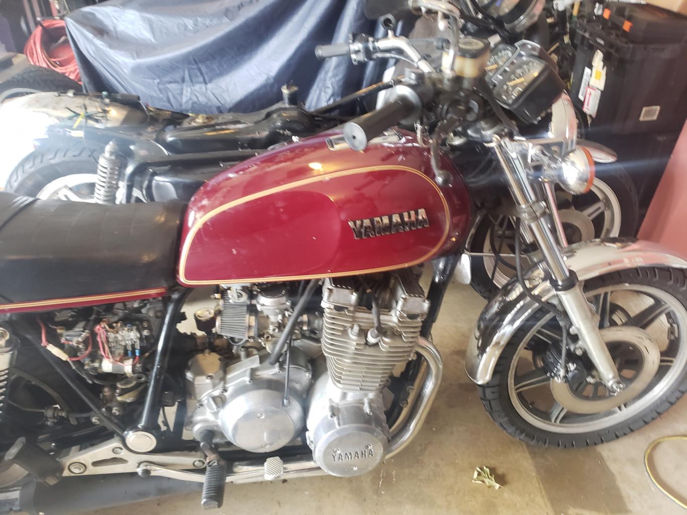

    Today I started Dianne as I didn't hear her run before so it was good to hear. She runs but not well. The PO had someone build and send him some BS34 Carbs BUT these belong on a KZ1100. He also installed pod filters and removed the airbox. I will be undoing all of this and returning to original carbs and airbox setup. I have a few oil leaks as well to address. The front forks are leaking too. The good news is that the charging system works although the battery is bad, I have 12V but no CCA to start the bike. Pics are soon to come of her cosmetic state. I intend to leave her just as she is with the minor dents and paint chips.

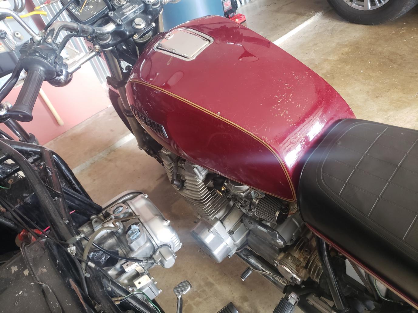

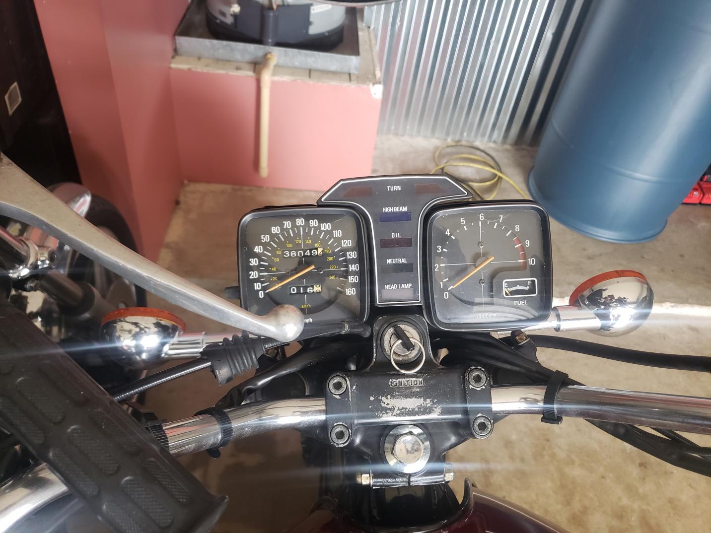

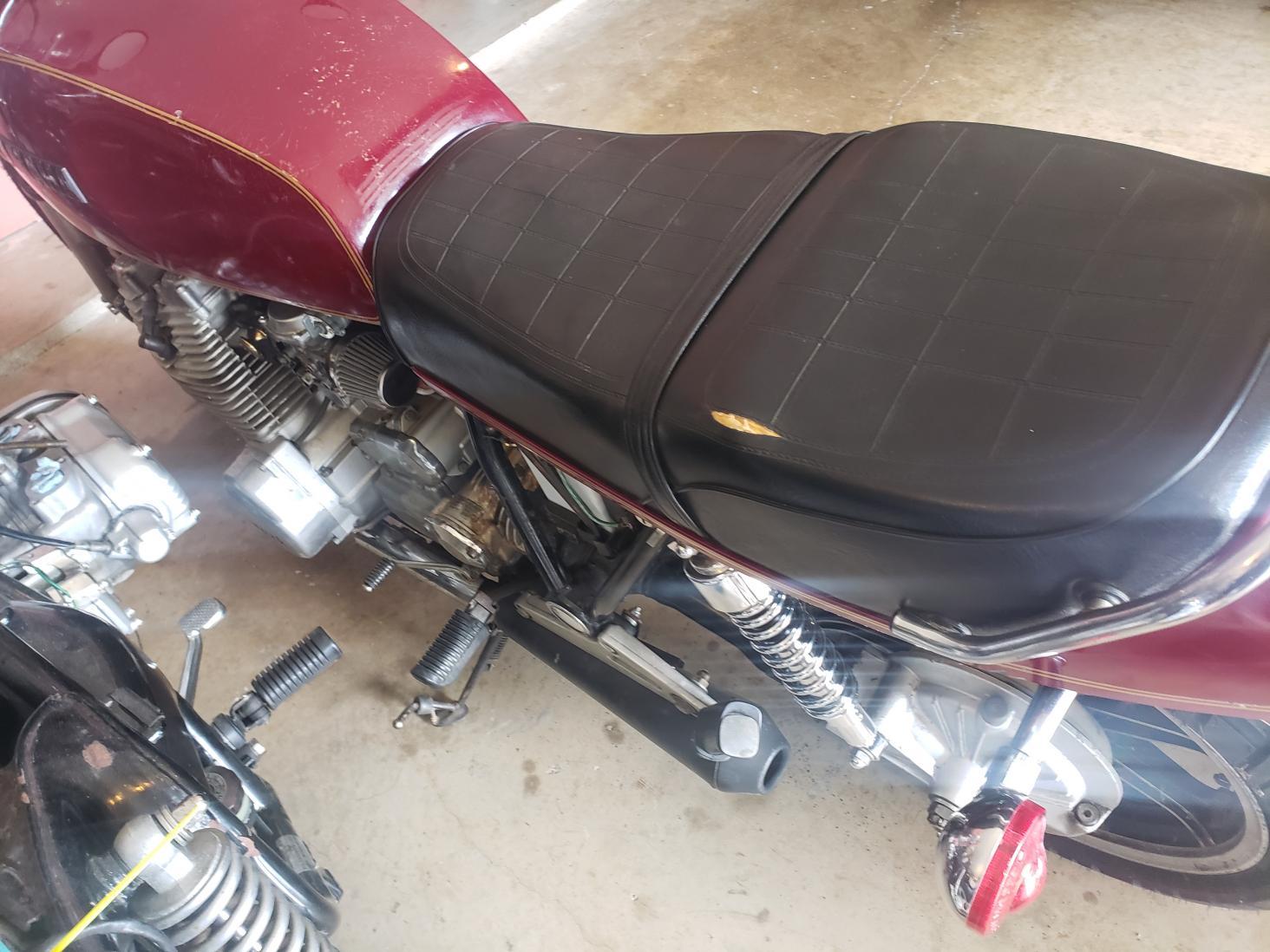

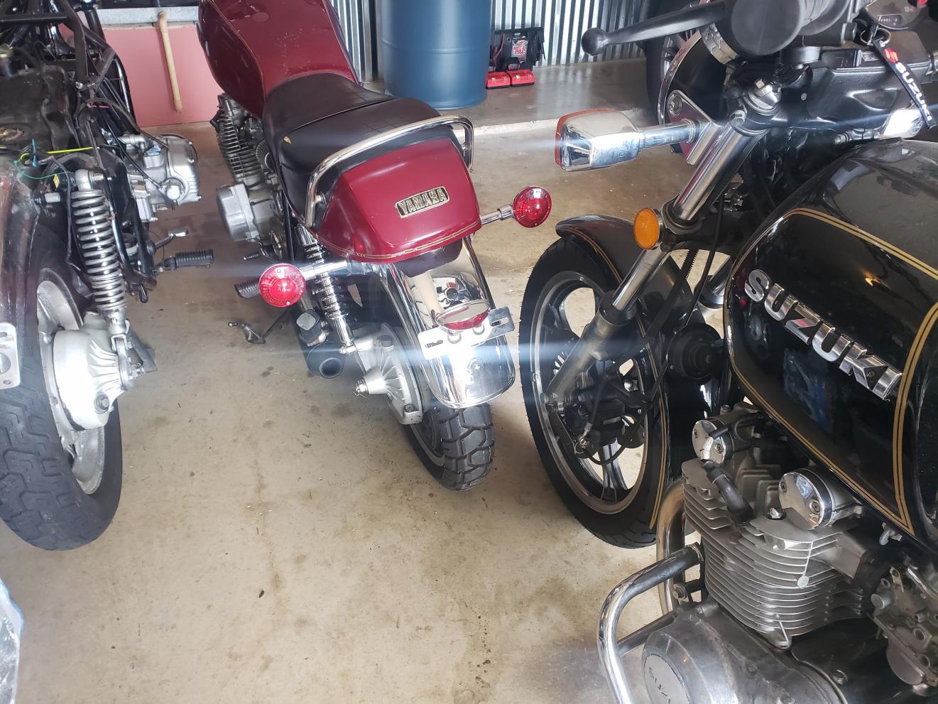

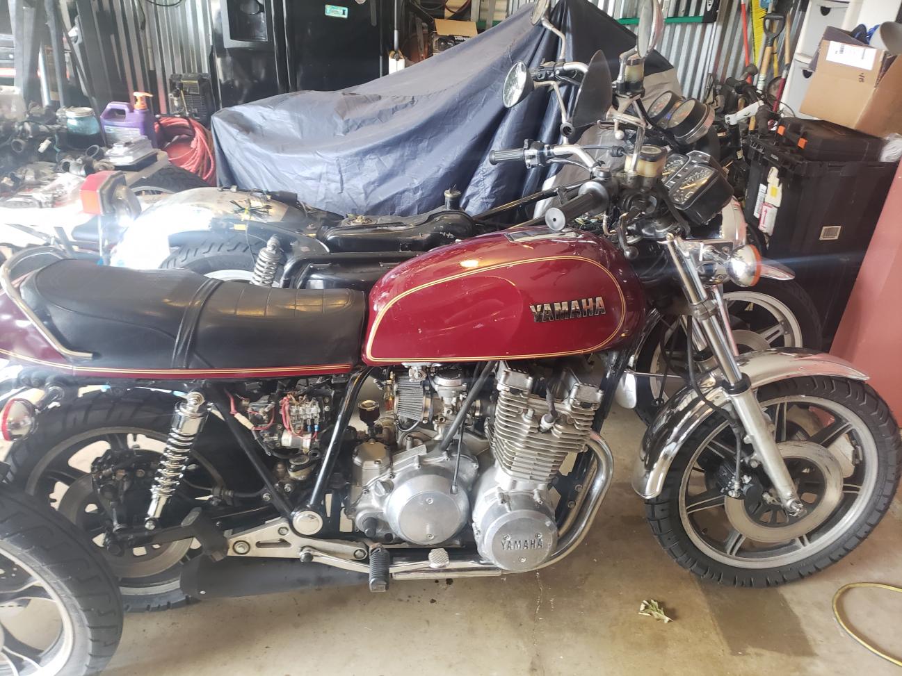

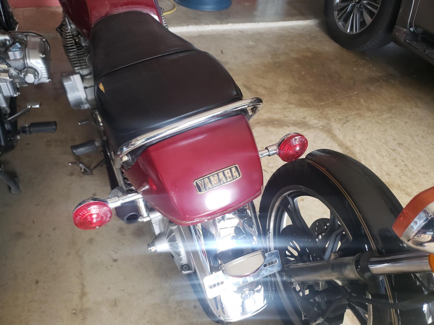

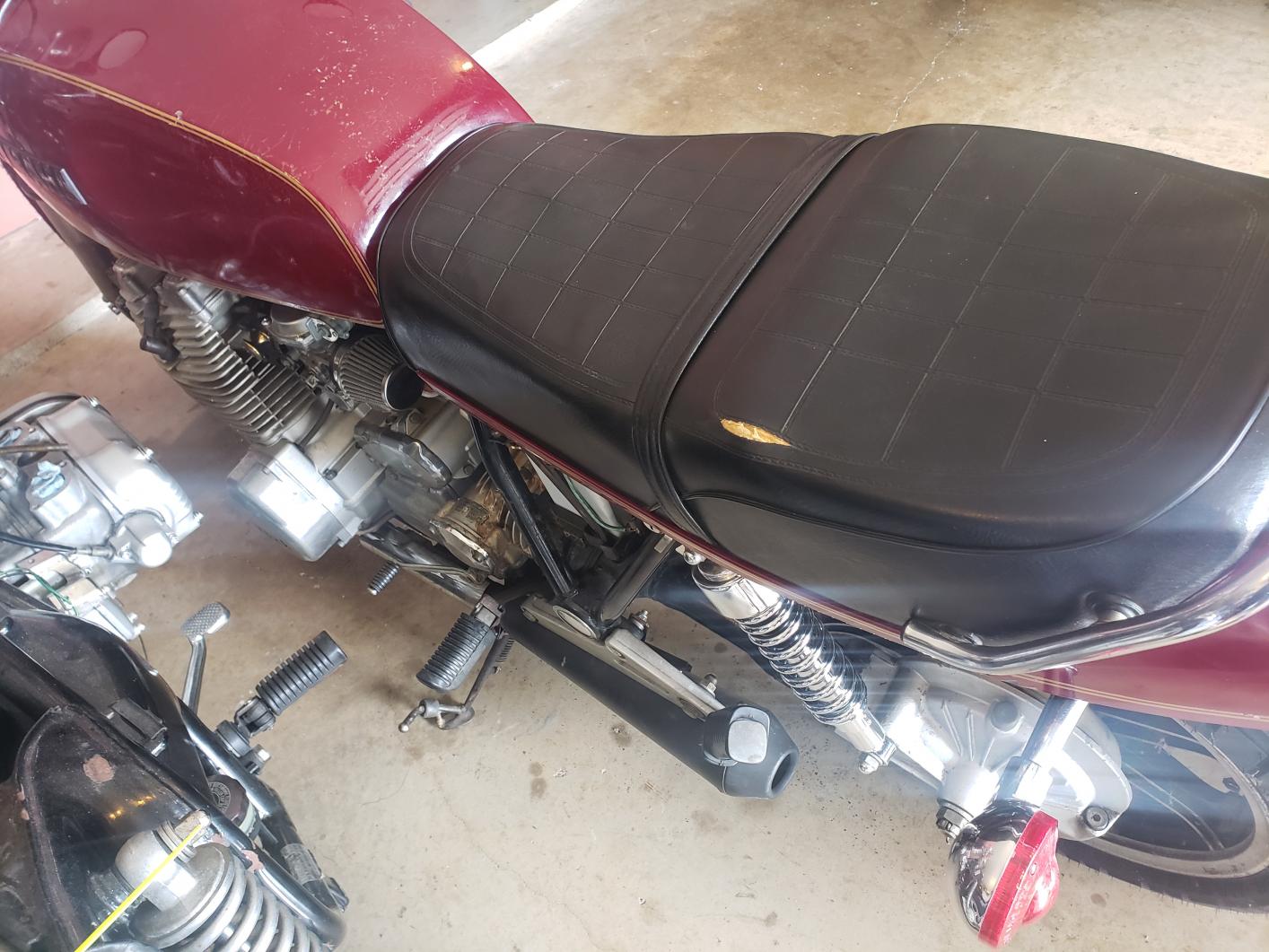

    Some more pictures.

        The aluminum, the chrome, and the pilot (instrument) box graphics are unusally nice.
        It's going to look great when you get it fixed up.
        • GalDemSuga
          • Apr 2024
          • 10
          • Wylie, TX
          I hope I can make her look like a nicely aged Ole Girl when I'm done.
