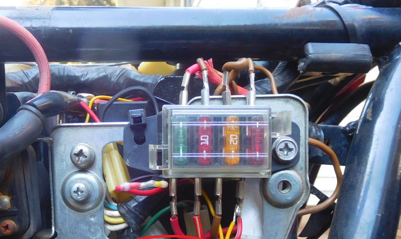

          One of the PO's rewired blade fuses for the main and headlamp fuses, I actually bought a full blade box to just completely replace as part of my my plan to go over the bike. I used a paperclip ( made sure it wasn't coated ) to verify that wiring for the 20amp fuse reads 12.8 but the glass fuses read 0. I also checked the tank and its one of the few places on this bike that I have not found rust so that's clear. Below is a pic of my fuse setup

            There's a lot of references on this site as to replacing the fuse block but hardly any references to replacing the main fuse under the left side cover near the battery. Have you checked that fuse and it's holder? I replaced mine with a generic inline fuse holder that uses the newer style fuses and FINALLY fixed a large voltage drop that I was chasing around for over a year.

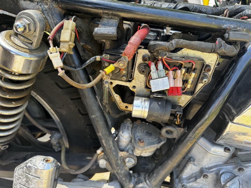

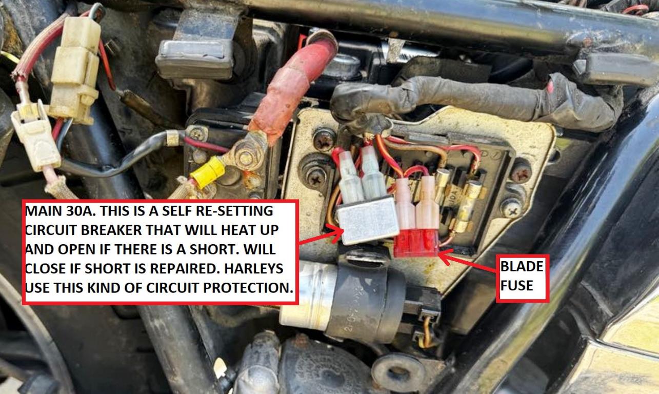

                  The 78-79 models do not have the main fuse in a separate holder on the left side, only 80 and up will. The main fuse on these early models is in the fuse panel on the right.
                    I have a 78 and like Phil stated, the main is in the panel (left side heavy red wires) with the other three fuses. You should probably replace your panel and go from there. This is known weak point with these bikes.

                        I saw the breaker, but is it working? I did have a '79 Standard that would burn up batteries. There was a short in the harness due to a burned hot wire between the connectors and the reg/rec. The best way to troubleshoot his bike is with a charged battery and a VOM to find the opens or shorts.
