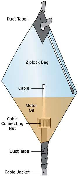

            WD-40 wouldn't be my first choice and other people will tell you to buy the $15 a can cable lube with Zircon encrusted molecules the pretty girl on the Sunday morning Motorhead show is trying to sell you. Personally whenever I get a new old bike I stick with what was used at the time, plain old motor oil. This picture explains it better than words.
              • 274
              cable and bracket is right above the idle adjustmnent in the middle front of the carb bank,,,when you yank the tank and or carbs you will see it and it should be free moving with a spring recoil....like LAB3 says any good oil will work for the throttle cable, and it should slide freely in the cable sheathing,,,also you can slide off the throttle handle and lube the cable at the top with some minor dissasembly as most dont and it can bind inside over the years....keep us informed....Mike in San DIego and Pa
