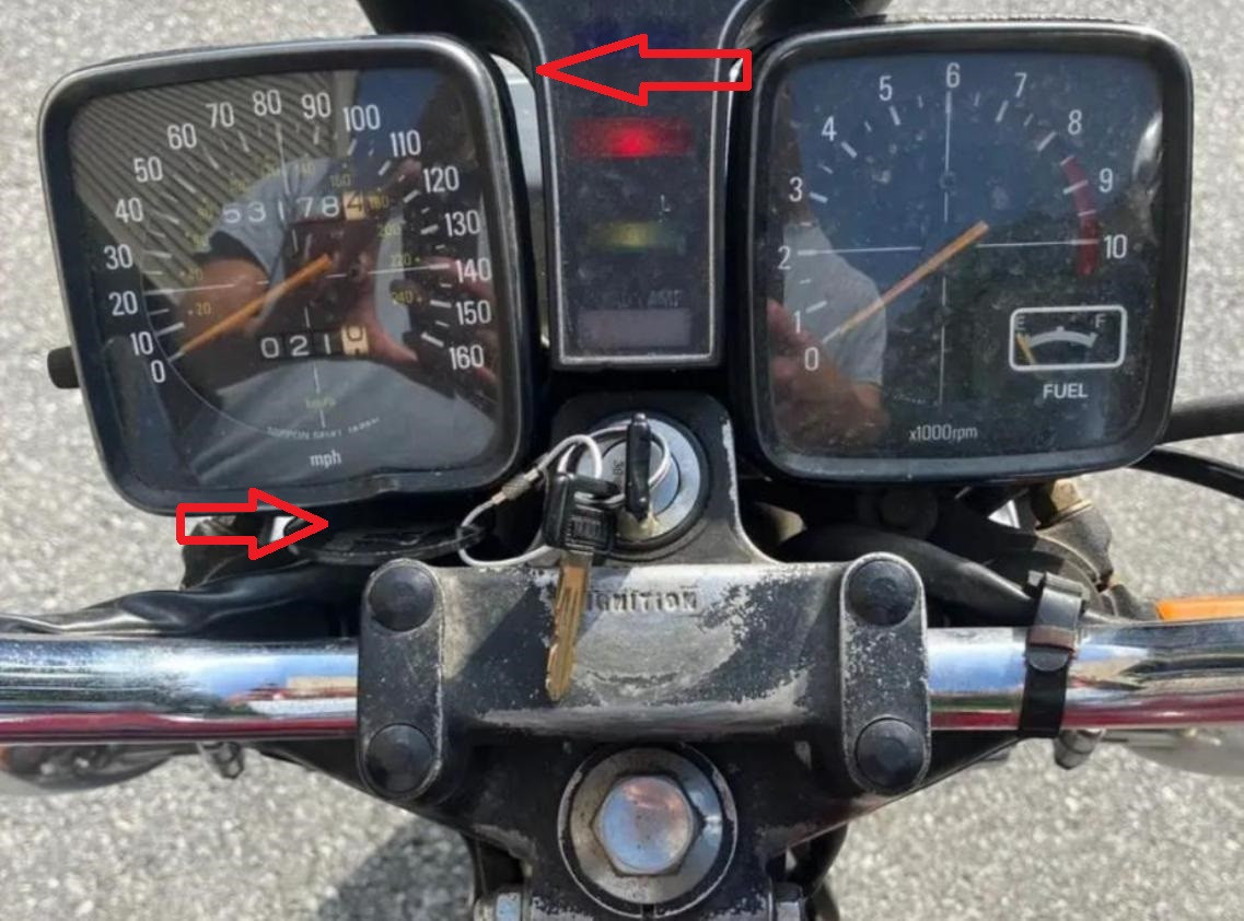

                      Found another potential option. This one is a 1978 XS 11 (not Special) listed for $1,500. Thoughts?
                      Yamaha xs1100 New intake boots
                      Carbs cleaned last summer
                      Good cosmetically
                      Smoke a bit on startup
                      Clean title in hand
                      Runs well except for the smoke
                        • 7817
                        '78 Standard, normal droopy rear turn signals, but looks like it's in overall good condition. Smoke at start up is a problem I'm having with my '79 Special, and I think it's the valve stem seals. I would try for $1250 as a first offer on it.
                          • 2010
                          Something looks odd with the speedometer. Possible accident. looks like it went down on the left side and was pushed up so hard that it touched the handlebar clamp to put a dent in it.

                            • 813
                            Click image for larger version  Name:	image_5619.jpg Views:	0 Size:	196.9 KB ID:	878958
                            They've probably been taken apart before and the rubber gasket is either shot or gone, mine didn't look too much different until I got the rubber gaskets replaced.
                            Smokes on startup would be a red flag for me.
                              • 7817
                              Yes, that IS damage from a drop! As with anything else, check things out and put "price drop" checks for damage as you have in the picture.
