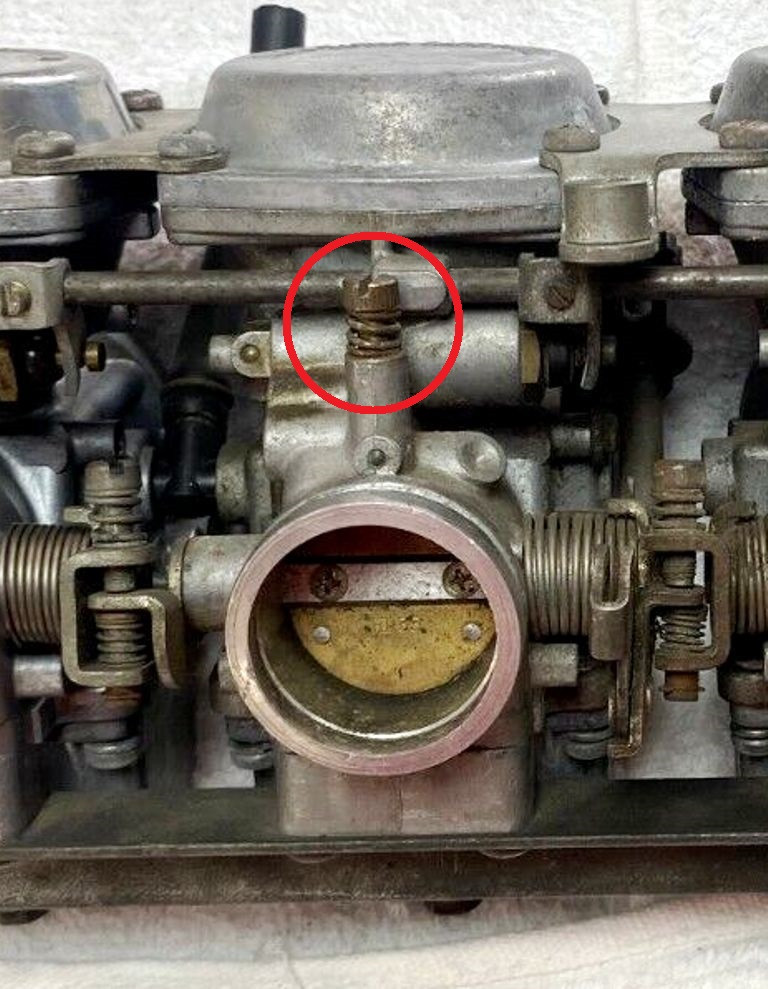

                              • 1972
                              Turn open (counter clockwise) each of your four pilot screws 1/8 of a turn to richen the pilot circuit. You are a little lean on the pilot.
