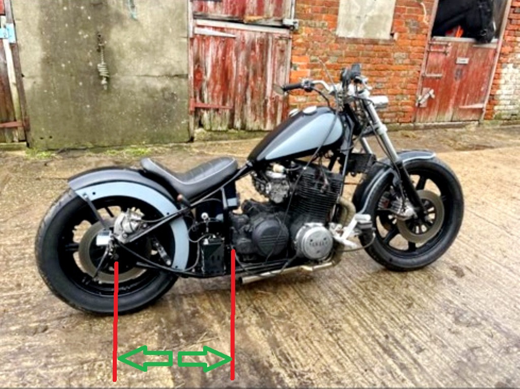

    hi this is my xs just bought running project bit of long shot says on the add drive shaft jumping has anyone come across with this issue thanks in advance 🙏
    If the carbs aren't already dialed in you can look forward to a challenge on that end, not having the stock air box opens up a real can of worms to get the bike running right. Should be some folks on here to help point you in the right direction, not impossible just finicky.
    The drive shaft "jumping" sounds like some worn or stripped splines, pulling the rear wheel off and looking things over where the drive unit mates up to the rear wheel should give you your best shot at figuring out that issue. Not saying that's where the problem is just the most likely spot to look and besides, it'll only take a short while to do

              All good points. The second gear jump is likely of course. Also the aftermarket frame is a big red flag. If the distance between the red lines is not precise and the shaft splines are only making a fraction of their stock contact area combined with how much power the engine is capable of, you can have a real problem with stripped splines.

                Nikkib, perhaps a picture of the other side close up to the rear drive area.

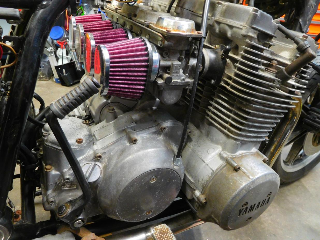

                    Uni pods (filters) are easier to tune than other options.
                    Consider taking a look at the universal joint.
                      I run pods also. With the jetting and floats adjusted properly they run like fuel injection. Very happy with them and so easy to work on. No issues in pouring rain either. They are washable so you only buy them once. I use them on all my Japanese bikes. Don't buy the Chinese units that cover the air holes.
