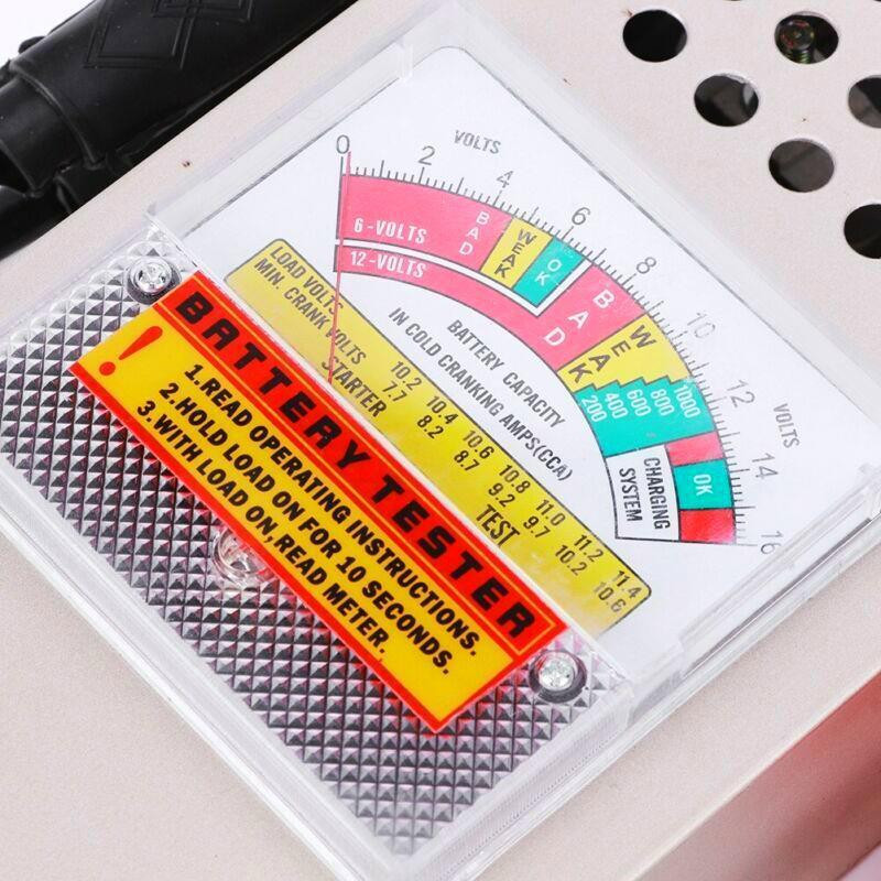

    AGM battery. Question: What amperage setting is your battery charger on when you charge it? Is it an automatic unit or manual?
    I just had a similar situation in the shop last fall and the customer argued for a few days back and forth on the phone that his battery was fine and that it was fully charged. He would charge it and get one start out of it and no second start. Classic bad battery. Voltage means nothing without amperage from letting it sit for months with no charge. The plates will sulfate and short internally. He brought it in to me and I put a battery load tester on it and it immediately failed. A new battery was installed and off he went. You should load test that battery.

                It was a battery charger and tender that’s suppose to keep it charged on post. I’m still going to take the battery to get load tested and see how that is and go from there. All your advice has been great
