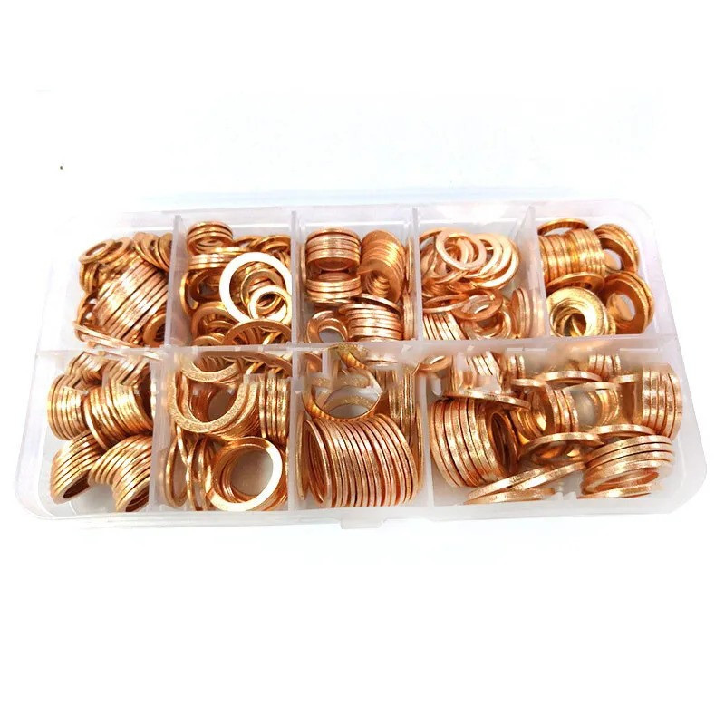

                    I use copper washers.

                      • 1467
                      I buy these kits which are used for all sorts of drain plugs on every brand of bike & car.

                          • 2054
                          DEEBS11 -what kit is more useful in your opinion? I just got the washers from partszilla so dont want to get a size I wont need. The 1st kit is per 6 and I dont know the size. 2nd kit has lots of different sizes. I prefer to use a brand name for the brakes like Russell as I have lots of them available.
                            • 1467
                            OY8, I guess what motivates me is the kit that can be used to repair a number of other machines. I have two of the 8mm I.D. seals from the kit on my XS11. Over 7K miles with no leaks. They work fine. If you divide $15.10 by 400 you get 0.03775 per seal. I used 7 and 1/2 cents to seal my carbs with 398 potential repairs left in the kit. I may not live long enough to see that kit get used up. I think that's pretty cool.
