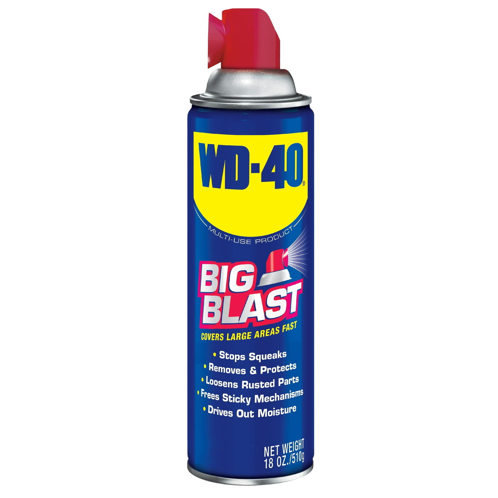

        Oldyam, when I store a bike in less that perfect conditions I spray the entire bike with WD40 Big Blast. Spoiler alert - It's just fish oil. Protects everything including paint and washes off easily with Simple Green in the spring. I have done this many times and it works great.

            DEEBS11-I will have to try that. Cajun31- how do i drain my carbs on my 80 SG? In all my time owning this bike- (1986) never drained them as I just started it and rode it. Please dont tell me those bolts at the bottom.
