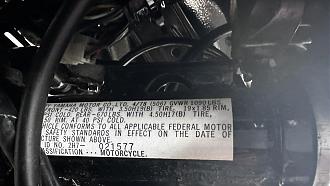

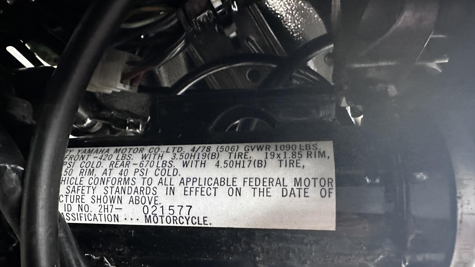

ID:	876966 Ok, so it’s been awhile. I have 78 E, right?

                    Your serial number indicates you have a 1979. What color was your bike originally. Glad to see the T problem resolved. Another trick that some do is to lightly coat the T's with grease. Use silicon based not petroleum.

                        just found title issued 2/28/79 and is shows 79 XS1100FB.
                        eSERIAL # ZH7021577

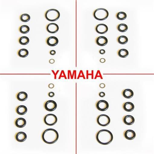

                          Remember what I said in previous response about your T's being different sizes on a 79. You asked should I replace because the leaks keep happening. I would at minimum replace the o rings. Yours are old as all oem are at this point and they have lost all their elasticity. When they sit and get dry they compress. They are probably getting harder and harder over time. There is a T mod in the maintenance tips section that addresses rebuilding them with new o rings. The new brass T's are built to be able to replace the o rings should you need to down the road. Considering the originals lasted as long as they have I would think that won't be an issue. You will have to decide for yourself how to proceed, but having the carbs apart to me dictates fixing them one way or the other or totally replace them.
                          Same story with your petcock base o rings. They are probably hard as a rock. The o rings included in most of the petcock rebuild kits are too small in diameter. I never use them because of that. You need a slightly larger one to make a good seal against the tank.

ID:	877023 Good thoughts.
                            Time and rubber not the best of friends. I’ve found rebuild kits for the fuel petkocks. This will be the second or third time for them. think I replace T’s with those brass ones. Maybe a little silicon grease will keep the rubber longer, but hey it’s been over 40 years. Never thought I’d have it this long.
