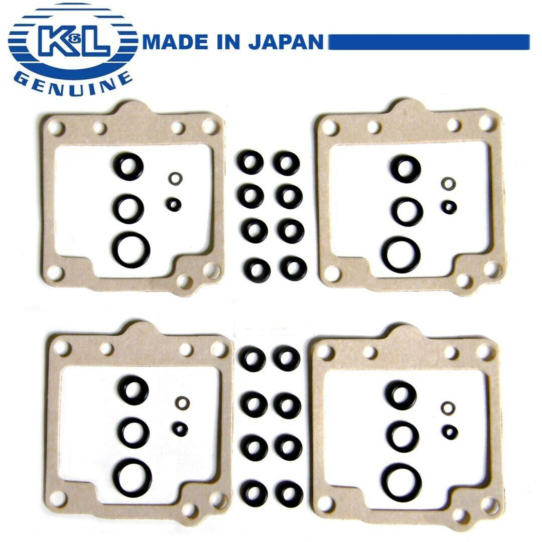

Carb o-ring assortment
    There's someone on the Suzuki GS repair forum that sells all the o-rings needed to rebuild your carburetor rack, this ad appears to do the same for the XS. Now if someone would include shaft seals, bowl gaskets, viton tipped float needles and those rubber plugs we'd be all set!

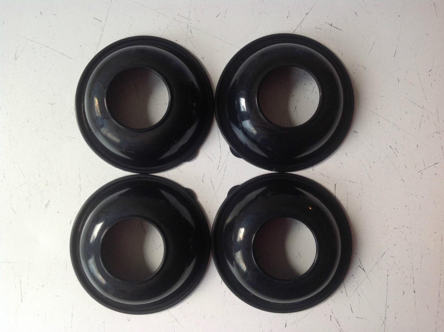

    Everything rubber related for an XS11 carb:
    https://www.ebay.com/itm/293493483551
    https://www.ebay.com/itm/352927647481
    https://www.ebay.com/itm/293416947165
    https://www.ebay.com/itm/172149754518
    https://www.ebay.com/itm/281762776133
    https://www.ebay.com/itm/291732072322
    https://www.ebay.com/itm/354901039032

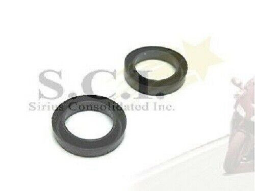

      Including seals.

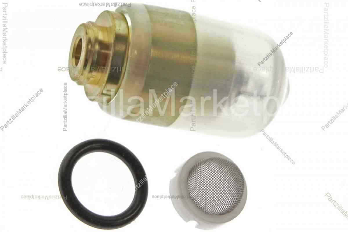

        Later style float pin & seat. Pricey but genuine.

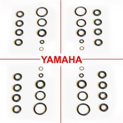

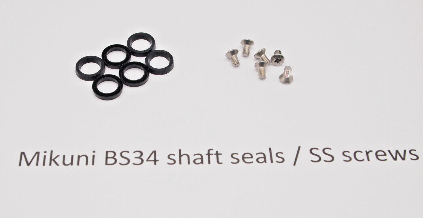

          Saw the shaft seals and screw set after posting as well as the oring set with gaskets.
          I've seen genuine Mikuni needle/seat combos for quite a bit less. Do you really think you need to replace the float needle seat on a well functioning carb? Seems that getting genuine Mikuni viton tipped needles is really all a guy needs.
          Right now my bike is running well an the spark plugs look right but my exhaust smells rich,, the carbs look "Sweaty" and my intake boots are covered in RTV. Had a 82 Suzuki GS450 once that had BS32SS carbs so I'm pretty well versed on how a proper cleaning and reassembly goes. Considering that the bike is running "good enough" at the moment I'll probably skip a full dip and use canned cleaner and compressed air to clean them up.
            You don't usually need to replace the float seat, chrome polish with a q tip in a drill will make them like new. Of course new o-ring.
            You know, partsnmore has decent non- Mikuni carb parts, among other things.
