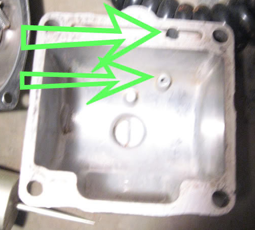

      As for the enricher circuit, make sure this passage is clear in the bowl. There is a tiny jet down in there, shine a flashlight thru one hole and to verify it's clear after cleaning...

        For #1 carb, pull the float bowel as phil's picture shows, and squirt carb cleaner through the tube that comes with the can through the large hole on the top edge. Point the bowel away from you, and wear glasses! You should see a nice stream shoot out the jet near the bottom of the bowel. If it dribbles, it's still partially blocked. A fine wire can help clean it.

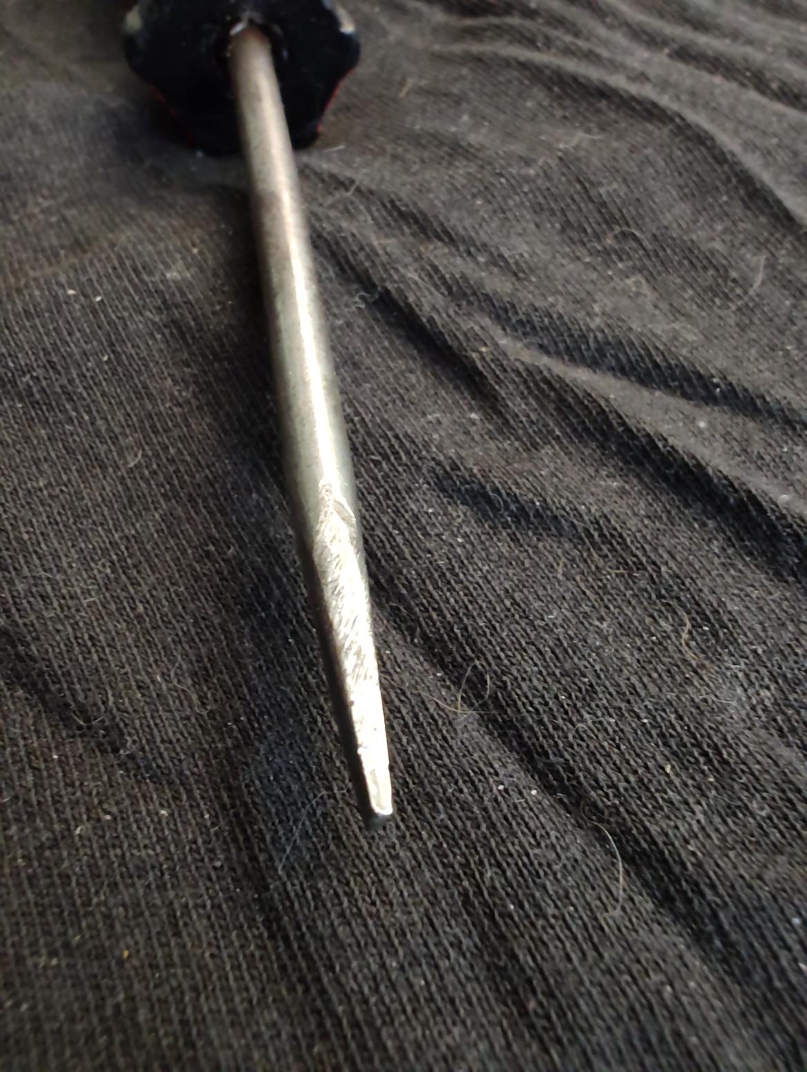

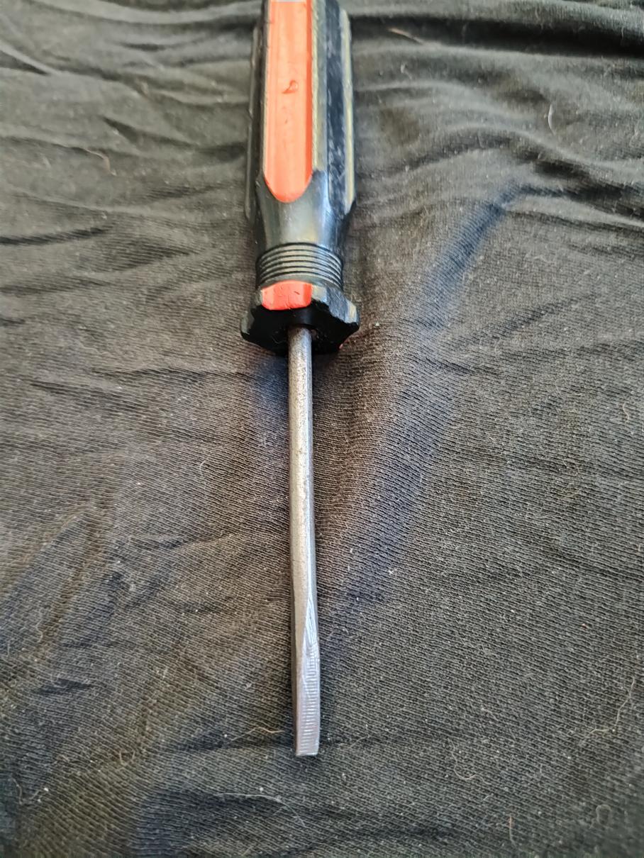

                            The screwdiver slots in the brass jets are amazingly easy to ruin and they're in a deep well so they're hard to remove, especially if they've been in place for a while. I found an old screwdriver with the right length/diameter, then ground the tip square and narrowed the blade to fit in the well and stay square in the slot so it doesn't wallow out the jet.
