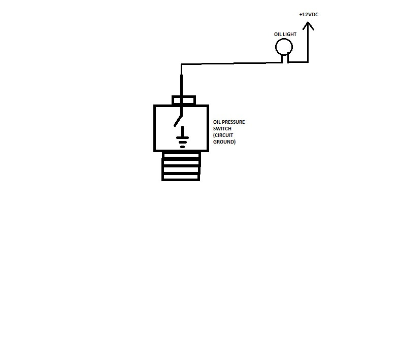

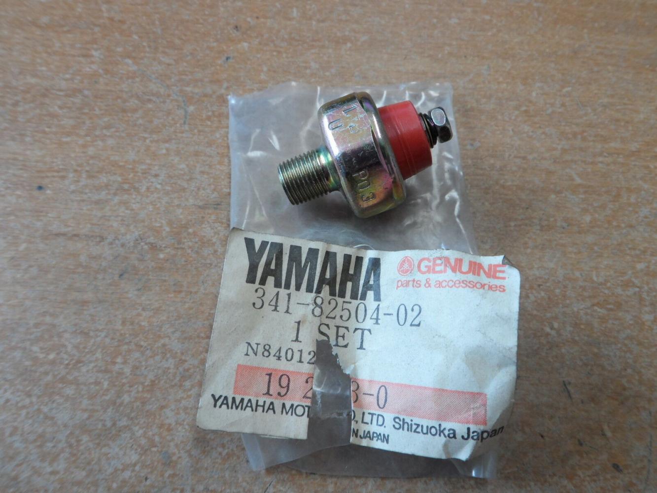

    Evel, this is how the circuit works. 12 volts positive on bulb at all times. The oil pressure switch completes the circuit by grounding when it does not have sufficient pressure to hold the switch in the "open" position. Pressure on/light out. The first easy thing to try would be to replace the switch because it's the most complicated device in the circuit and most likely to fail. A lot of these fail open but most people do not notice because the light never comes on even when it is supposed to (cold start key on before you hit the start button).

      The part

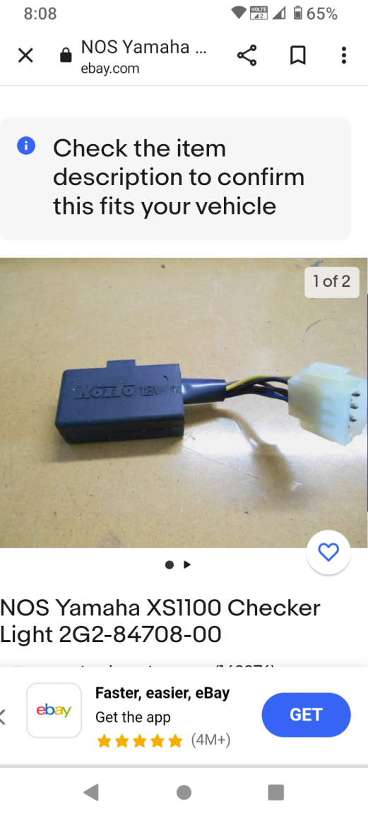

        You know on only the 79 Special, the oil warning light doubles as a warning for a burnt out tail running light. It is controlled by a light checker unit under the left plastic side cover. The terminals in the connector plug become loose/corroded and will cause the flickering warning light. Try jiggling the connector and see if the light goes off. Here is what the unit looks like....

              I think Phil is right about finding the module and unplugging it and cleaning it up a bit before you plug it back in. That is where the issue is more than likely.
                Yep, the pin and socket type connectors get flaky, the sockets can stretch open a bit, they can be closed up a little with a tiny jewelers screwdriver.
