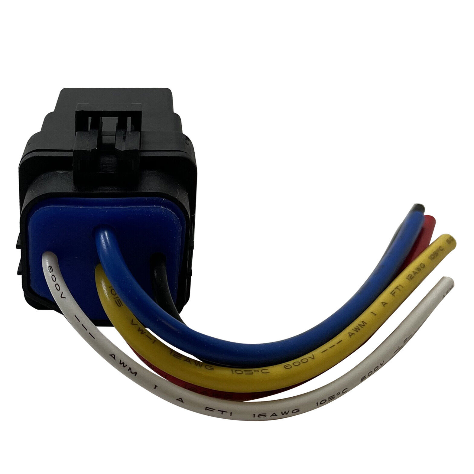

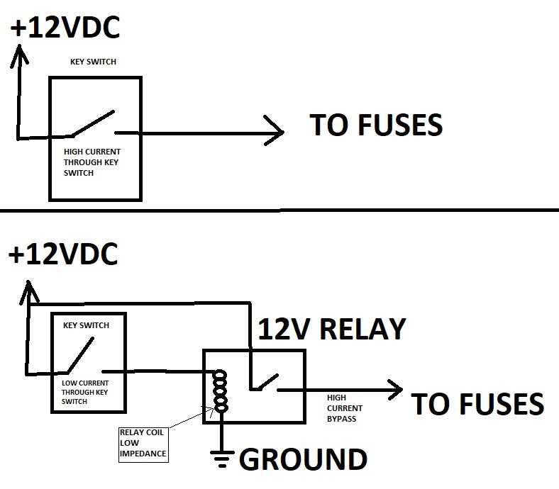

        Hi LAB3, I have modified most of my bikes with a simple relay that carries the heavy current away from the key switch. A much better way to handle the electrical current needs of a motorcycle. A waterproof relay can handle the electrical system better than an early 1980's ignition switch as shown in this diagram.

          Easy enough to get and put in, thanks for the reminder!
