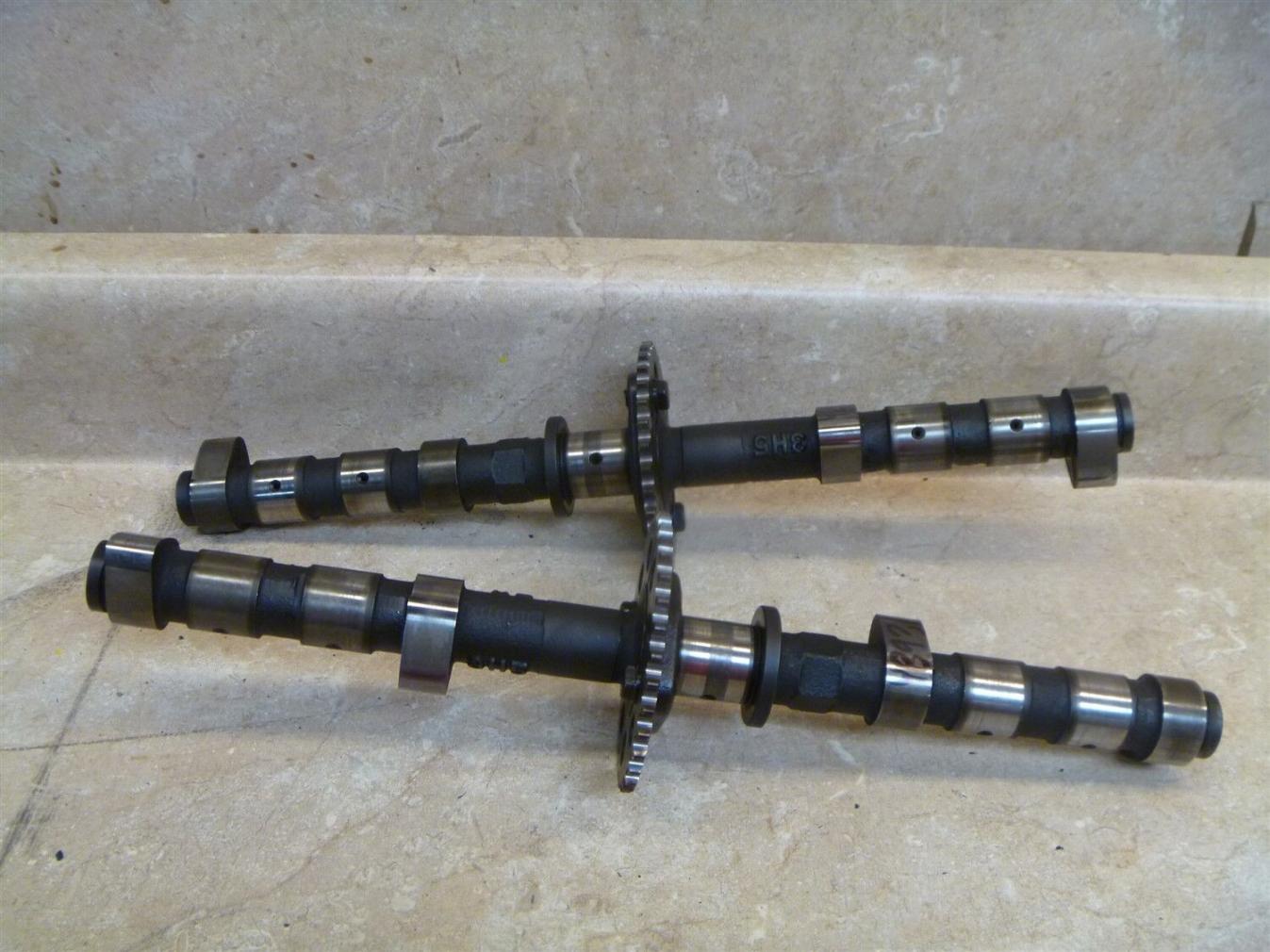

          There are several good used sets available:
          https://www.ebay.com/itm/11428869808...Cclp%3A4429486 Click image for larger version

            Thanks for all you help. I have a good set, but was just wondering about these.
