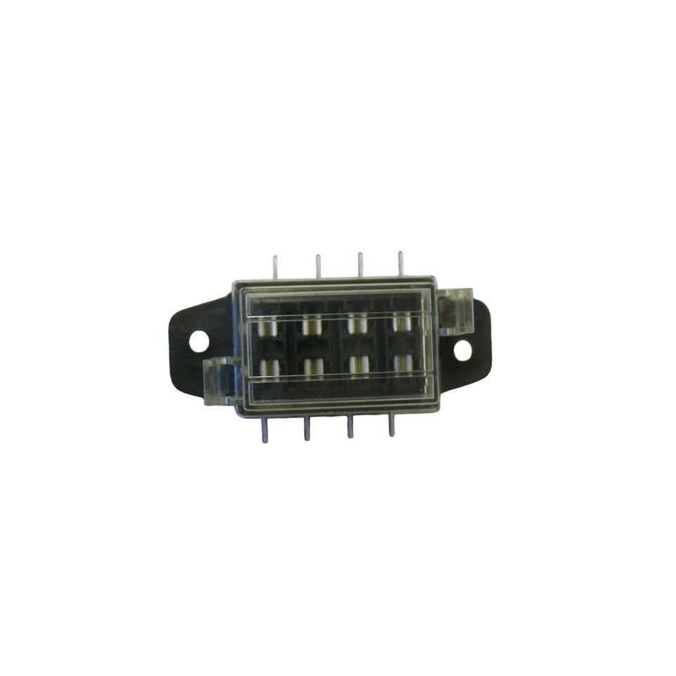

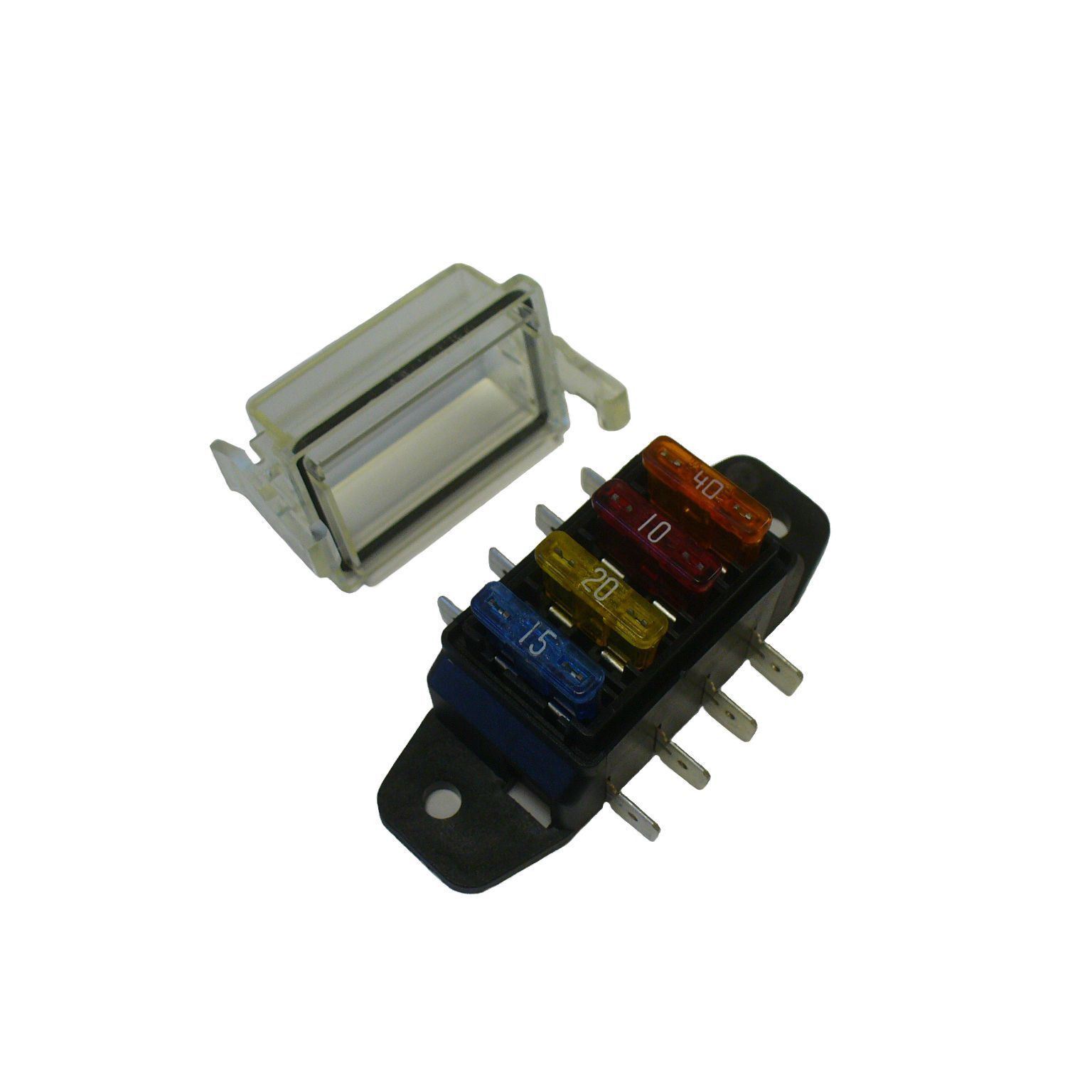

              A decent $15.00 fuse box replacement part:
              https://www.ebay.com/itm/143445206467
