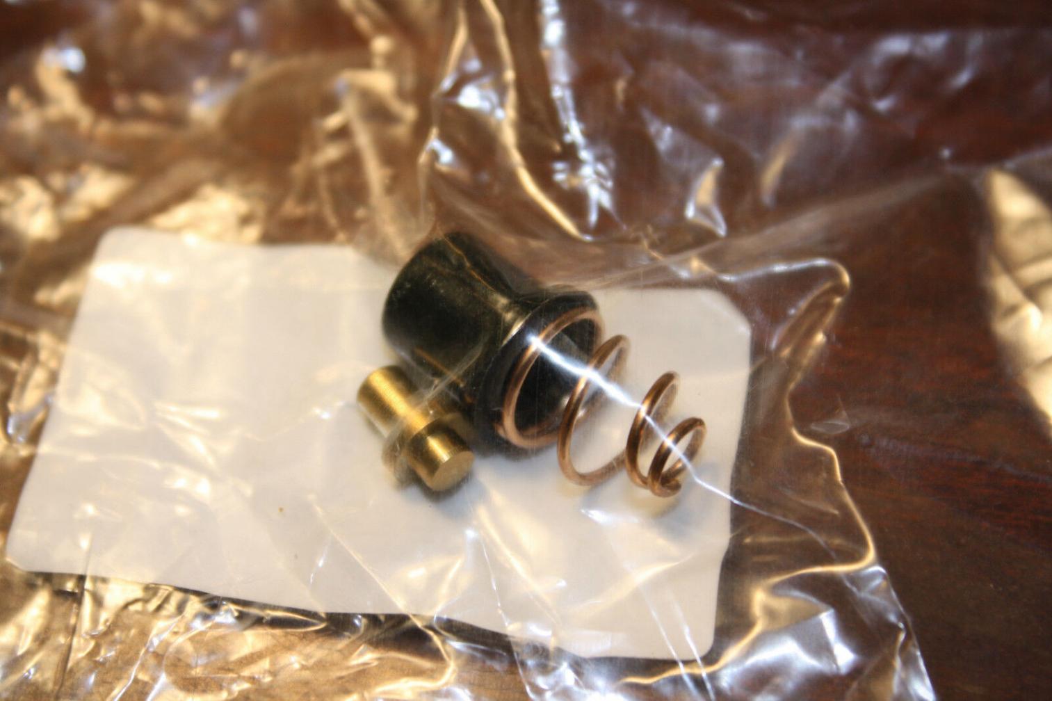

            • 2009
            https://www.ebay.com/itm/23086211059...Bk9SR7K49KWZYg
