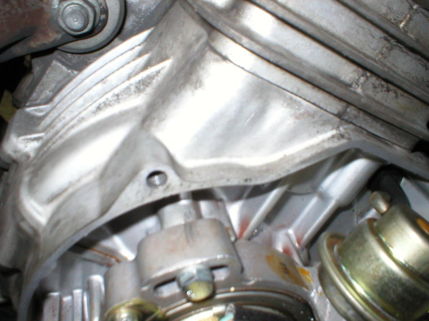

Here is a picture of a 1980 anti-tamper screw. It looks like an M6. Part # 3H5-81674-00-00.
Leave a comment:
I found that a 78 has a conventional pan head screw (they must have changed due to dealership warranty issues of customer tampering) part # 97885-06030-00. The middle of the part number states it's a M6 x 30mm length. I'm guessing the thread is 1.25mm.
Every now and then someone asks what size a particular bolt is. Just thought it would be helpful to post this from another site. FYI, you can get the part# from most Yamaha dealer websites or here. "How to get sizes of bolts from the part numbers... The Yamaha microfiche shows the bolt size, you ...
Leave a comment:
I used a drill to remove the heads of the tamper proof bolts and then removed them by hand.Leave a comment:
