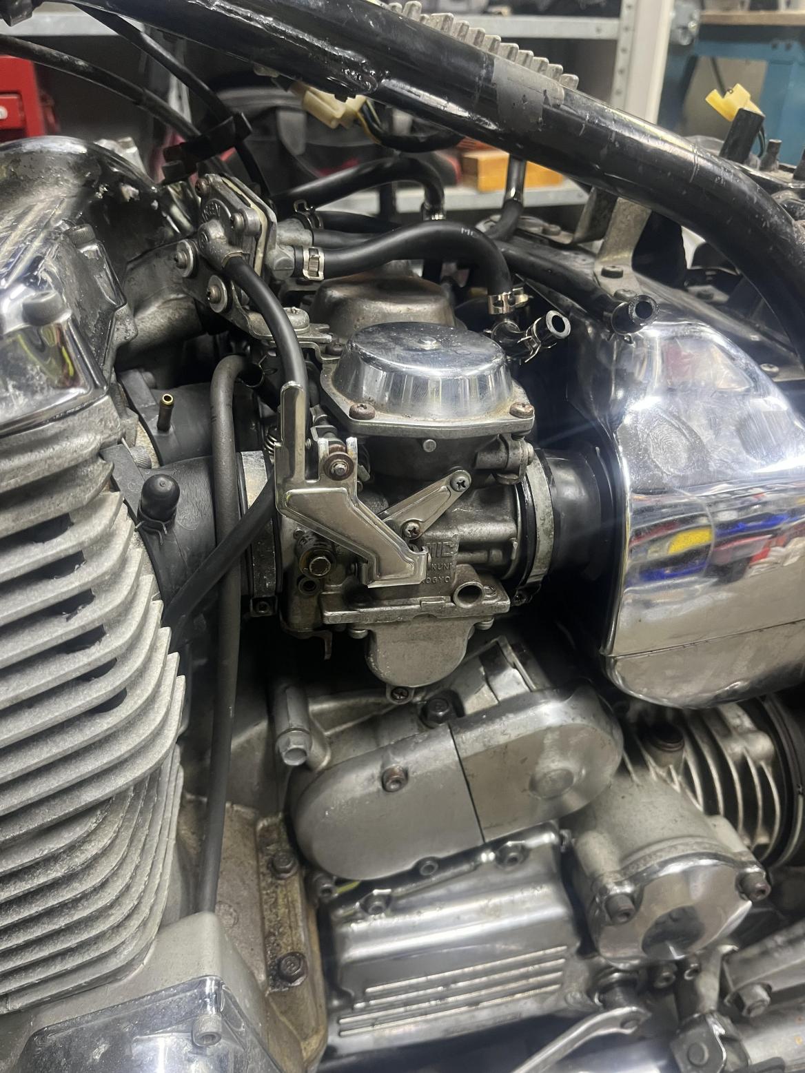

      Ok so after opening up Carb#4 again, she stopped leaking fuel.... I suppose the needle must'a stuck or something?
      Anyway. The big question I have now is... Looking at the posted picture. The two lines on the left most side of the photo.. are they running each to the right location? I have a bad feeling I have it wrong but I cannot seem to find a thread to answer this

        Ok... to answer your question the longer hose from the vacuum advance goes to the number 2 carb nipple. The hose from the octy goes the the number 2 manifold nipple.
        Didn't take long for someone to chime in and suggest that the Octy is eliminated by most folks. I am not one of those people. If working properly it serves as a safety feature to stop the flow of gas so I am a proponent of rebuilding it. There are kits available for the octy and petcocks. I would suggest that because the bike is new to you that you need to inspect and rebuild the octy, petcocks and the carbs. Take nothing for granted. You will have better peace of mind doing everything yourself.
        How long had the bike sat up before you bought it? What kind of gas was used? Ethanol is not very friendly when it comes to carbs. Even small lengths of time can mess up the carbs. If it is all you an get then get used to the idea of running the carbs dry before any time storing. I do my best to buy non ethanol gas and I still am in the habit of letting the bike run until it stops on it's own after shutting the petcocks off.
        Here are rebuild kits for the octy and petcocks. Yamaha xs1100 petcock rebuild kit for sale | eBay. One thing ... replace the large o rings in the kit that are used for the petcocks on their base against the tank. They are generally too small in diameter and you need thicker ones to make a good seal against the tank.
        The carb flooding could be due to several factors but the first thing you need to do is pull the carbs and take the float bowls off. As you are already aware, best to keep parts associated with each carb separated by each carb. Pull the float bowl gaskets off with each bowl and turn the carbs upside down and check the float heights. Especially on the on you suspect is flooding.

          Adding onto that I completely cleaned my carbs, got the float levels right and the carbs still flooded in one of them. I gave it a couple taps and it stopped. After having the carbs empty for a while sometimes the float will struggle to open from just the force of the gas so I always give it a few taps if I’m putting fuel in for the first time and there are no issues after the initial fill up.

            Thanks for the reply. I will likely go the route of rebuilding the octy. I completely dismantled, cleaned, instpected and re-assembled the petcocks. They seemed to be in good order. A previous owner had already cut and installed some extra gasket material to create the better seal.
            The previous owner had not let the bike sit long as he was in the process of attempting to restore that. Fresh oil+filter, air filter, spark plugs, rebuilt carburetor etc. My guess is that prior to this it spent time sitting. I am unsure about the gas used and will look into getting non-ethonal fuel.
