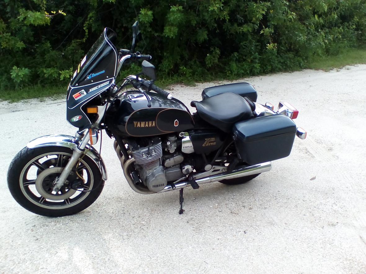

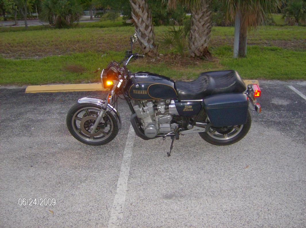

        I did just the opposite, Special forks on a Standard, still using the Standard's triple trees. It was not stable at all at highway speeds, I wouldn't try it again. In your case Tony, it would shorten the wheel base. My FJ fork mod shortens the wheel base by a few inches and the handling is superb at all speeds, slightly faster steering but very stable. Try not to hit rocks in the road though, that upsets the steering similar to a mini tank slapper sometimes.
        Click image for larger version  Name:	HPIM0637.jpg Views:	0 Size:	160.7 KB ID:	873242
        ​​​​​​Standard with Special forks ^
        Click image for larger version  Name:	IMG_20190707_185440.jpg Views:	0 Size:	182.1 KB ID:	873243 ​​​​​​
        ​​​​Standard with FJ forks and FJ triples ^

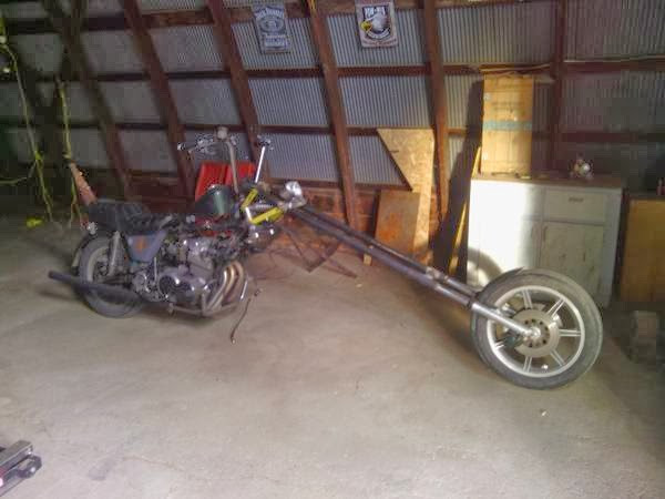

            And then there's this guy's 750..
              will do that chop is insane !!!!! why would anyone do that

                I imagine the side loading on the fork tubes (perpendicular to normal loading).
                  I would guess people got ideas of doing that from watching Orange county choppers back in the day.
                  I would love to ride it around the block once if I could.
                  Then I could say "don't ever try this at home"

                    ive built a few chop's in my time but the longest forks i went with was 4inch overs, my mate did a 6inch over on his and the flex was noticeable, but that xs750 (i think) will be just un-ridable and in my mind dangerous
