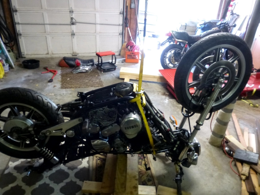

                    I've flipped a few. It's best to have help but I have done it alone also. I used a come-along tool suspended from the beam in my garage as pictured below. Here is a link to a little more details about how I did it: https://projectxs11.wordpress.com/19...standard-2016/

                        Sorry, I don't know what is involved with replacing the starter gear at issue. But if it has missing teeth, they are likely laying in the bottom of the oil pan. And as Tony said, if you can rock the crank back and forth a little, that may free up some bits and pieces that are lodged elsewhere and allow them to drop. So if you do end up flipping the bike, it is extremely important to remove the oil pan first before flipping so that the gear bits and pieces don't end up falling back up into the transmission gears or into other parts of the engine. You can take a wild guess at how I know that!!
