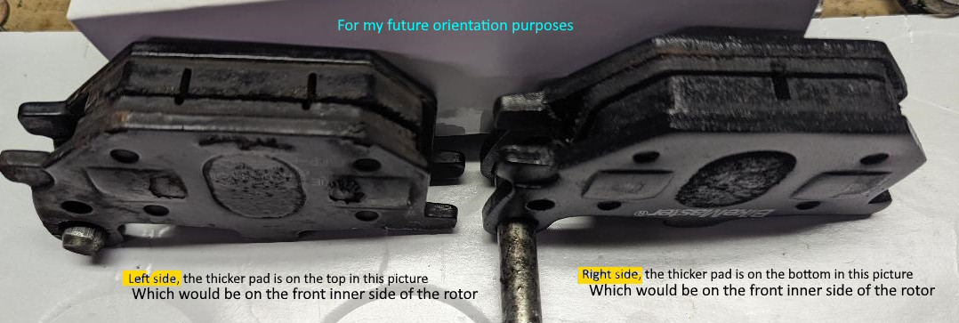

            Those Special pads are easy to get mixed up, just had to figure this out the other day:
            The thin edge of the pad should be facing forward on the outboard side of each caliper. The thick edge faces forward on both inboard pads.

              Right on Phil. You are exactly correct. Marty and Tony indicate that the pads will only go in one way, so I guess I just got lucky the first time. But since I didn't know that and wasn't sure that I had them correct. I spent a ton of time experimenting for the fun of it. Anyhow, here is a picture I took in case I run into this again, because I will likely forget again! (Hope I got this picture right!)
