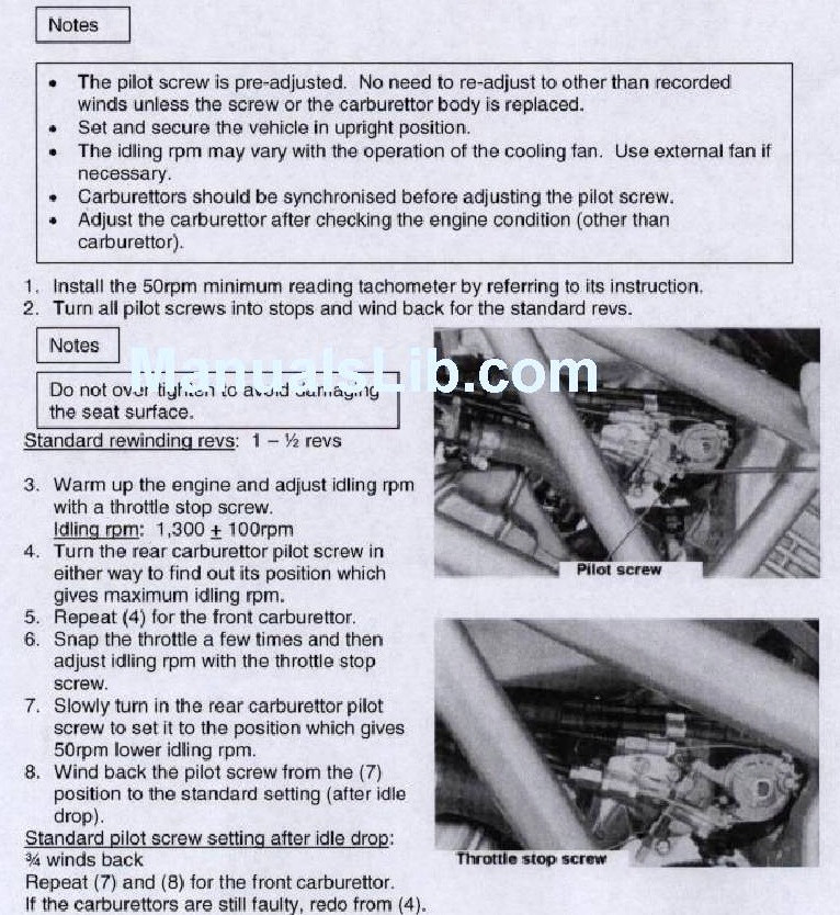

      IanDMac, easiest and correct method of setting mixture screws is start with warm motor, backout mixture screw several turns. Then with motor at idle, slowly turn screw in untill a change is heard from motor or exhaust, at which point STOP. Back mixture screw out no more than a quarter turn. Do other three carbs same procedure. Fuel mixture is now set. This is called the 'lean-drop' method and is commonly used for setting fuel mixture screws on ALL carburators cept for automotive carbs. Those mixture screws use same 'lean-drop' method except when change is heard, then back out mixture screw one to no more than one and a half turns. Following this procedure will have motor running smoothly and A/F mixture correct.

        The Honda Drop Method that Motoman mentions is an industry standard and certainly works well. An accurate tachometer is supposed to measure a 50 RPM drop during the procedure but as he stated you can use an ear. I should also clarify the mention of the Colortune tool. This tool uses an easy visual method to adjust the pilot circuit. This is the tool I use in my shop.

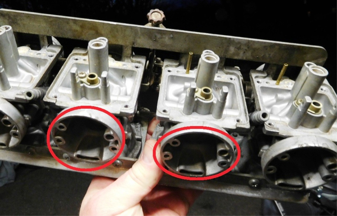

              Ian, if you adjust your pilot screws and don't get much change your jets might be in the incorrect range. Might need to change pilot jet size. Not sure what color you see with the Colortune. If it is always rich (amber) with no apparent adjustment with the screws, a possible common problem with XS11s is individual filters covering the air jet making the mixture too rich and unadjustable.
              Click image for larger version  Name:	DSCN0722.JPG Views:	0 Size:	214.6 KB ID:	872947
                I did see you are using your airbox.
